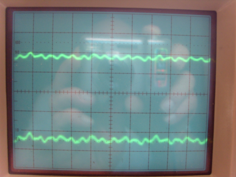

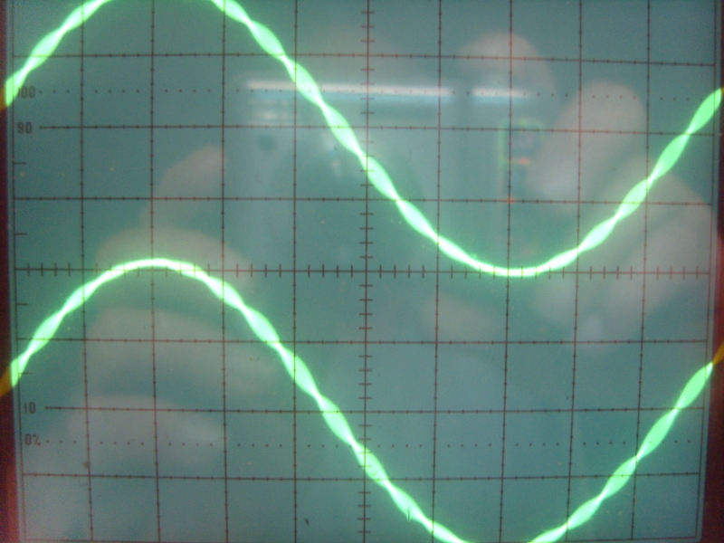

Here are some screen shots from my 200mhz Tek scope, sorry no flash too much reflection. PCM1704 to AD844, TZ to ground via 2.7kohm with 500pf across it 844's output buffer straight to output rca's which were loaded with 50kohms
The funny one for me is the spiral oscillation on the 20khz sine wave anyone seen anything like this?,this noise dissappers at 12khz sine waves. Then after I put away all the gear I though maybe it was my smp bench light that was doing it. Next time I'll see again.

20khz sine wave
Noise on output .1mV per division 20mhz scope filter bandwidth
Noise on output .1mv per division 200mhz scope bandwidth
