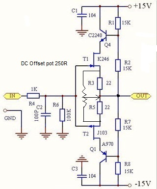

Thinking of trying this after, either from the AD844 TZ pin or from it's output buffer.
If I come from the TZ pin so as not to load it down because it has such a weak output will I have to remove R4 C2 & R6 on the attached buffer?
If I come off the AD844 output buffer I can leave R4, C2 & R6 in place?
why not use a simple n-Jfet buffer...?? its simple and don't require any matching.
for use with higher current output DAC's it could be paralleled with a high quality resistor to lover the current injection. Not too sure if that would give a noise penalty though. but I will give a distortion benefit, as it sems like the AD844 suffers when the injected current is too high(ish)..
Or you could run mere 844's in parallel to deal with the higher currents. More in parallel would also do away with the need for an output buffer...
I was today thinking of taking the output straight from pin 6 to the output rca's, as I think I have the same gain at this point, and it's supposed to have 80mA drive current at 15ohm output impedance, the only LP filtering I would have is the 1st order at TZ to ground of the 2.7k resistor and 560pf across it which gives -3db at 105khz. Do you guys think I'll be waisting my time with this setup? The PCM1704 is supposed to be glitch free, and maybe it doesn't have too much other noise?

I did what most said probably wasn't ideal, I drove the audio output rca's directly from the AD844 buffer with a 47ohm resistor in series just in case, and looked on the scope and yes I did loose about 5% of gain, but I got rid of half of Silicon Valley as well, remember I had a single opamp for LP duty, a dual opamp for balance and single ended duty and a pair of fets for each phase as buffer outputs all after the AD844.
Noise you say? a big fat NO! no more than I had before, in fact a touch less because of the touch less gain, also I still able to hit 2.2v P/P at 0db 1khz from a test disc.
The noise that I watched for was on a 200mhz Teck scope using 400mhz leads, and to boot I cannot see/hear any either at full output.
The sound, yes the sound has taken another leap higher, the sound is just as dynamic rich and all that I said before, but it has become even more relaxing to listen to, yet can still put you through the back wall when needed with it's dynamics, this chip amazes me. I look at it now and think this is as far as I can go with it, then I thought, the guys here aren't too impressed with the output buffer circuit, I got to wondering is it possible to put a little feedback from pin 6 (output) back to TZ (pin 5) just to encase the buffer (sorta local feedback) to maybe make it better?
Cheers George LOVE IT, LOVE IT, LOVE IT!!!!!!!!!!!!!!!!
