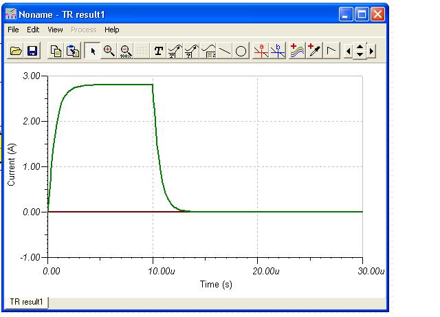

So, I gave it a 10usec pulse and this is the response. The response was the same with either the 49710 or the 49713. I don't see any advantage to using the 49713.
Hi Ken, thanks for your response. My software does not allow to signal sources. I can put in a custom wave file but don't know how to create one.
Okay. The problem with observing waveforms is that you cannot ascertain much about potential frequency domain distortion characteristics unless they are gross enough to obviously change the shape of the signal. On the other hand, time domian distortions appear well controlled.
