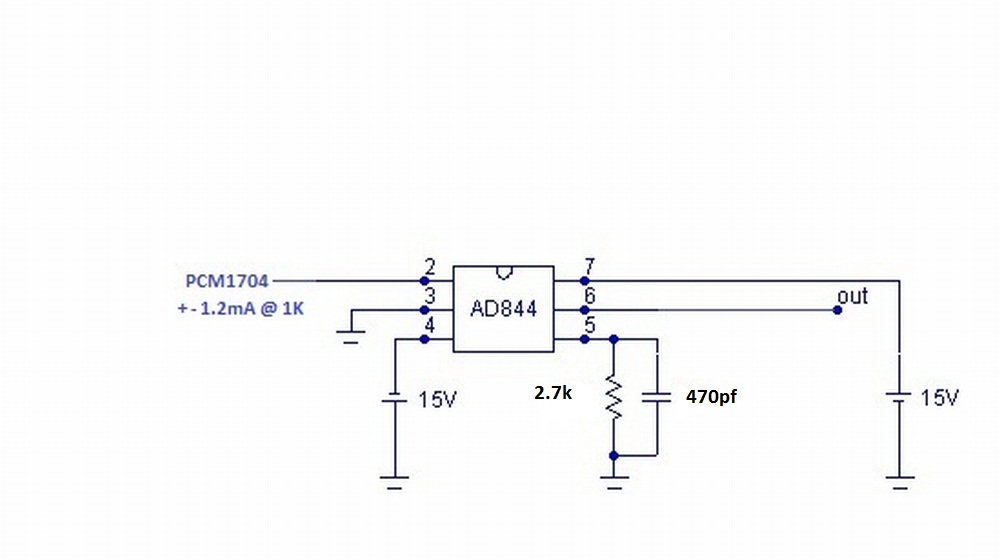

Using the AD844 as an I/V

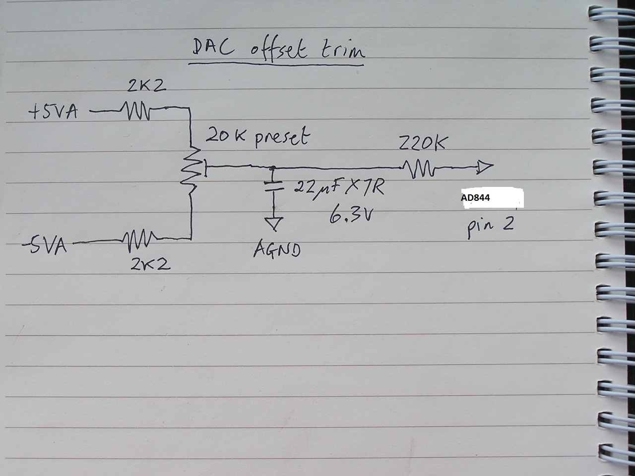

Here is what works great for my PCM1704, if your doing a sub for another I/V opamp, don't forget to disconnect the feedback loop around the old opamp.
And give thanks to Pedja Rogic for letting this out of the bag, as I think it would be hard pressed for even a discrete I/V to better the sound this can give. And kudos Barrie Gilbert for designing the AD844 and abraxilito for the dac dc offset nulling circuit
Cheers George

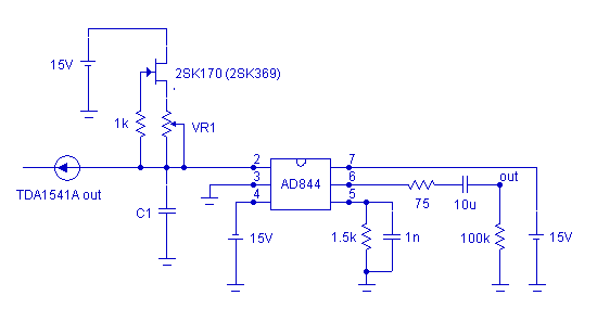

BTW I just read earlier posts about people biasing the Tz node of the AD844 up to 10mA to force it into class A. Please be aware that at those currents, the Tz node is quite nonlinear, causes gross distortion and may also exhibit slew rate limiting. Don't get hung up on class A too much - the 844 as-is is much better than almost all discrete circuitry.

Input Z for the AD844 is 50ohm typical, , and happy with it is an understatment, it's a game changer as far as being compared to the normal highend opamps with feedback.
This AD844 when used without global feedback and even with it's own output buffer has made me feel that all other opamp based I/V's are seriously flawed, and I don't think I have it at it's best yet either.
Someone said it needs to be biased higher than it's quiescent current of 6.5mA, but correct me if I'm wrong but the PCM1704 can only give +-1.2mA at full swing 0dbf.
But maybe they meant with the TDA1541 which gives out a much higher than that.
