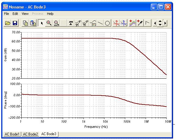

The phase shift for the AD844 circuit is minimal over a huge bandwidth. That may have something to do with it.
Here is the bode plot for the AD844 TDA5141 circuit of post 63. Bandwidth is just fine with very little phase shift. The distortion is huge. Something is wrong. I did not include the DC biasing circuitry in my sim.

Sorry, my mistake. I ran it on +/- 5 V instead of 15VDC.
Distortion is nothing to worry about.

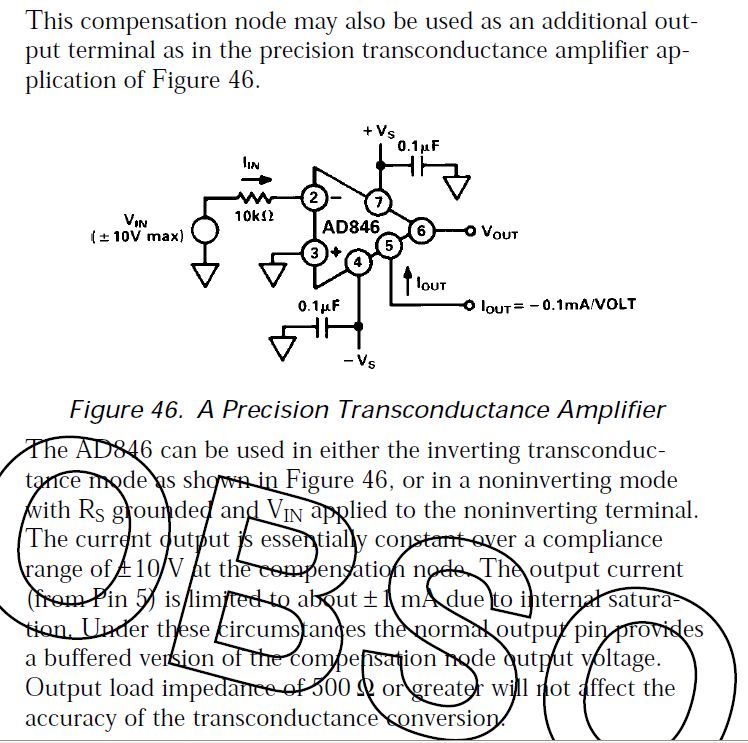

Here is a little from the now obsolete AD846 datsheet also can be used as current feedback opamp, seems it was the forerunner to the AD844, also had a TZ type pin 5. but was mainly used for bandwidth limiting compensation or as a low mA output point but they don't say what the output impedance is at that point either, looks to be similar architecture though.
