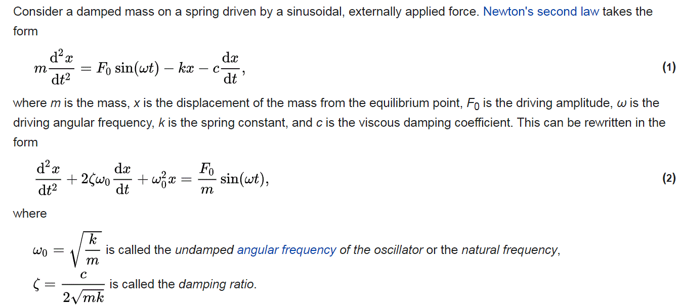

I am inclined to focus on resonance and damping. In practice, it`s all about damping. Damping is accomplished by increasing the mass (decreasing efficiency). Avoid efficiency at all costs if low distortion is of primary priority.

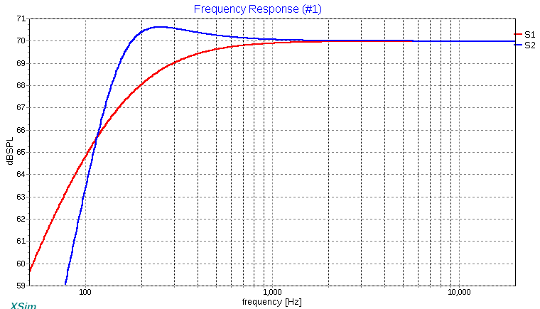

Maybe not a direct answer to this, but I thought about the bandwidth of the driver resonance, and how far up in frequency the box would be working on that resonance, if it weren't for the need to deal with modes. I simmed 0.3@50 and 0.9@150. Could be noticeable up to several '00Hz, as collateral for absorbing low.Is reducing the cabinet depth in order to increase the frequency of reflections making them easier to absorb a valid approach?
