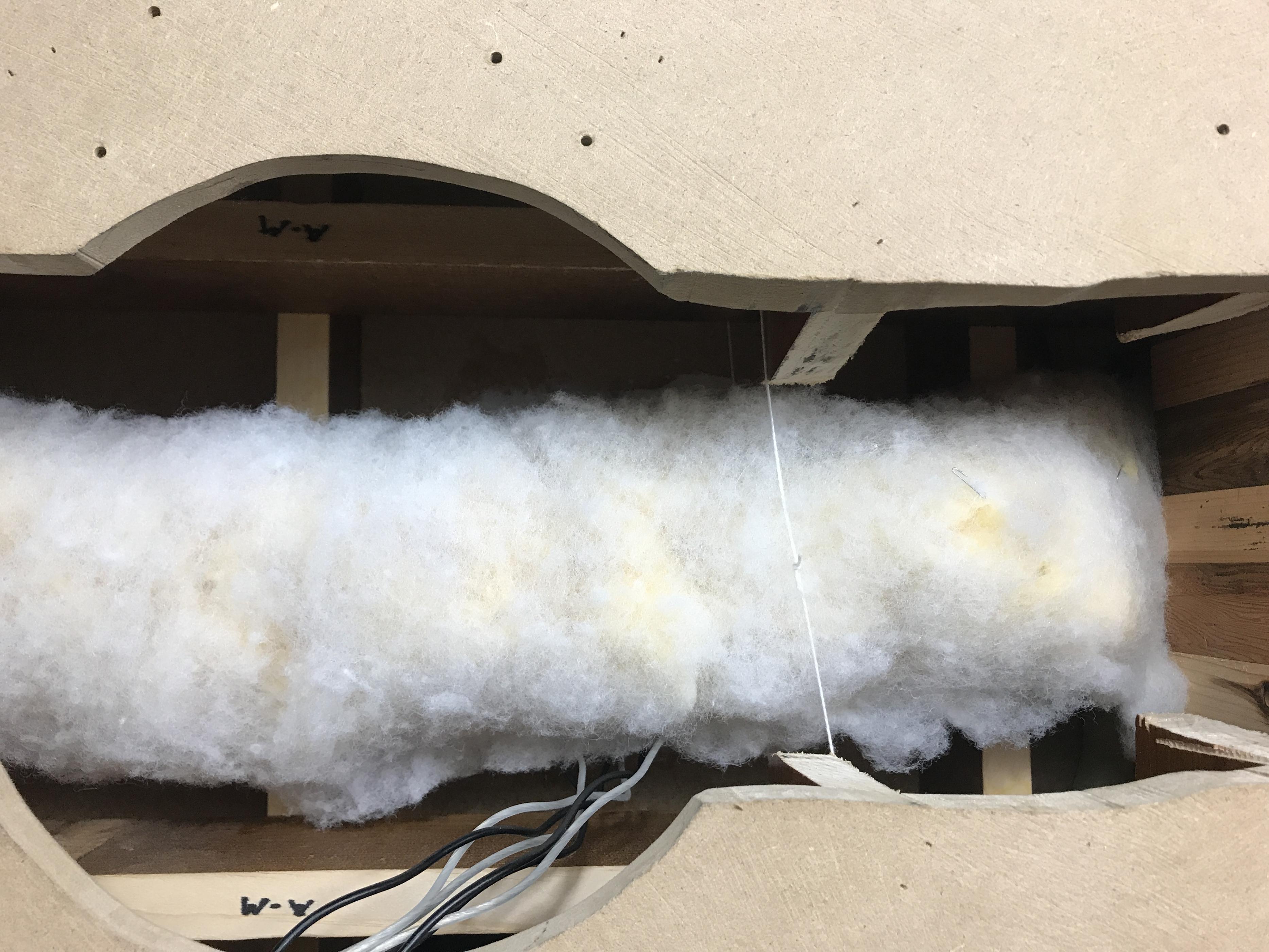

This subject has been talked about for a long time, but is still not well understood by even experienced speaker builders. What exactly goes on inside a cabinet is part of the art of speaker design.
One aspect is cavity resonances. These are different from panel or material resonances and are related to the size and shape of the internal air space of the cabinet.
The bottom line is that cavity resonances (which is what standing waves are) are generally not good unless they being used to generate extra bass.
One way to get rid of standing waves is to stuff the speaker. I have never liked the sound of a "stuffed" speaker. I believe what I am hearing is the sound reflecting back from the wall of stuffing due to an impedance change. Also the stuffing selectively absorbs some frequencies over others.
What's better is to put a sound absorbing structure in the center of the cabinet. I did this on a recent build and was pleased with the results. What this is is essentially a sound absorbing burrito. Its poly batting with fiberglass in the middle. Then its rolled up like a burrito and stapled together. It then sits in the middle of the cabinet behind the drivers. It sits between several braces and is also held in place by string so it won't move.
I noticed a very clean sound from using it. I don't think it significantly affects cabinet volume either.

If I was going all out I might look into complex cabinet shapes. One of the nice things about an absorber is that by sitting in the middle it prevents parallel sides from resonating. So its easier to implement. The burrito shape only took about 15 mins to make and I even weighed the amount of fiberglass.
One issue with using a sound absorber is that if it gets large it will begin to affect cabinet volume since the waves don't reach the center.

Well yes, but it's maybe not all that bad. :) If you use very good stuffing like wool or cotton, the absorption is fairly even across the audio spectrum, dropping off in the bass of course. Wool and cotton do better in the bass than do fiberglass or rock wool.
I do like the acoustic burrito idea. :up: Years ago we hung a wool felt curtain in the middle of the cabinet and it made a remarkable improvement. I've used that trick many times.
Do note that the presence of stuffing material will usually increase the effective box volume, as seen by the driver. This is because the material tends to act as a heat sink, such that changes in pressure resulting from cone movement are approaching isothermal (as opposed to the adiabatic changes in a box containing only air).

If you go to my thread on "3 1/2 way with sub..." I posted some photos. Essentially; I did something similar what you have said above. I located the woofer near the top on purpose. The Aperiodic vent is in the same chamber with the woofer but it is offset from center X,Y, and Z axis. This gives me an asymmetrical surface to volume "ratio" for "wave-breaking" as you mention. The idea was to not have everything at even multiples of dimensions as a further attempt to "break-up" standing waves (why we sometimes use the golden ratio; avoiding even multiples, etc). The woofer chamber has 2 thicknesses of felt on the largest internal surface areas; single layers in the smaller areas. The 4 inch foam pyramids do not completely cover the back or sides of that woofer chamber but approximately 1/3 rd so this is NOT a fill attempt in this region. Again; I have an Aperiodic vent so that path is supposed to remain clear of any damping, stuffing, etc. The 2 lower chambers DO have fill; poly' stuffing. This puts the stuffing at maybe 50%. Without measuring; I am getting a fairly flat in-room response from about 37 Hz to my X/O of about 300 Hz. I am not detecting any major peaks or dips. I literally just now ordered the microphone, interface and stand, etc. I will try what others have suggested including 2 channel loopbacks, impedance, etc. using REW.
Thanks for the ideas, experiences and inputs; that's what we're all here for...ideas and suggestions!
I tried to absorb the lowest frequency in towers in a similar way (standing wave top to bottom), but it did not work so well. It seemed to require too much stuffing to be effective, almost blocking the passage, and the woofer could not 'breathe' into the whole volume of the box, and the bass got 'constipated'.
The impedance curve showed a really smooth damped resonance, and the resonance frequency was not increased, but still the bass was not good. Putting the damping material in the ends of the tower seems to objectively give better results for the top/bottom standing wave IMHO.
However, a 'burrito' behind the woofer would probably take good care of the higher frequency standing waves between the side walls, and the reflection back to the cone from the rear wall, and very little felt would probably be needed on the back wall. Burrito sounds like a good approach since the damping should be most effective where the velocity is highest, and that should be in the center of the box.

Lining the walls helps to damp panel resonances. But one of the problems with lining is that it still presents a flat surface which gives the subjectively more hollow box sound. Lining the walls is still probably the most common approach.
I've been curious how woofer position affects the internal sound. Centered maybe the best spot since placing a driver at the end of a pipe will give the most standing waves.
I definitely like the sound of wool stuffing. It adds body to the sound and is solid sounding. Fiberglass is cheap and has more of a crisp sound. One could also stuff a wool sock with fiberglass to get real fancy.
For a standing wave that's a long wavelength (like in long skinny apeaker) I wouldn't think that a sound absorber would be big enough. Stuffing the length might be the only way to deal with it. I have a subwoofer that I've tried a few different stuffing materials and pattern in and nothing made much of a difference.
