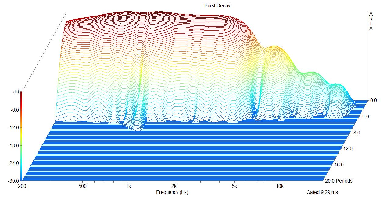

There isn’t enough room for a wave 😉 . The wedges in anechoic rooms indeed are designed to minimize reflections. But do you have any clue of the magnitudes we’re talking about here? With adequate materials for loudspeakers the reflection itself hardly matters. Whereas the change of acoustic impedance in the cavity as a whole matters very much, i.e. changes in the time domain are effectively reduced. So the cone ‘sees’ a lot more even (resistive) impedance.Actually its probably because the material causes a backwave when the sound hits it due to an impedance change, as has already been discussed here. THis is basic stuff. This is why the wall surfaces of anechoic chambers are unevenly shaped, because it is more effective.
The result is visible in the time domain, see the attached BD of a midrange with rather excessive damping of the enclosure. Even in this case not all cavity resonances were suppressed but given the level I then considered it OK. As you can see the cone indeed is rather transparent for these resonances, so keeping them low matters.

I don't many people here know much or anything about BDs. myself included. So please explain how you concluded the cone of an anonymous midrange is "rather transparent for these resonances" inside the box. Or are you just saying something obvious like the cone moves readily at its resonance?The result is visible in the time domain, see the attached BD of a midrange with rather excessive damping of the enclosure. Even in this case not all cavity resonances were suppressed but given the level I then considered it OK. As you can see the cone indeed is rather transparent for these resonances, so keeping them low matters.

Fair enough. It is a ZA14, close range (about 1cm) that I measured years ago. Wedge-shaped enclosure with two parallel boundaries. Unit mounted on a baffle 25cm wide and 100cm high. Measurement with cheap electret measurement mike on a Yamaha audio interface, single channel, ARTA software. Measurement I’m not completely sure here, with sine sweep, half-Hann window, gating is stated, 48kHz sample.I don't many people here know much or anything about BDs. myself included. So please explain how you concluded the cone of an anonymous midrange is "rather transparent for these resonances" inside the box. Or are you just saying something obvious like the cone moves readily at its resonance?
And just how much of that racket noise inside the box leaves through the little mid-range cone and is audible to the human who is listening?
B.
It is not the cone itself, that breaks up at 9k. Otherwise it moves like a piston, the measurement shows this. The unit is filtered band pass. I don’t have the measurements with lesser damping anymore, so you have to believe me here.
By the way, in my opinion these days one has no real excuse when stating that one has little understanding of BD or CSD plots, while suggesting one has knowledge of electro acoustics and perception in general.
To your last question: I don’t think that this specific resonance can be heard. That is why I endend up with it. The problem with perception is it’s adaptability. Worse resonances could or could not be noticeable, but only in true ABX tests the results count. I don’t have time or resources for frequent double blind testing. So I end up with results that, with my limited knowledge of perceivability (there has been done enough research) should be just fine for my listening room. That is again not the same as ‘just fine for any room’, I have performed listening tests in anechoic rooms and I know design objectives are not uniform.

Was the response of the driver flat to begin with? BD has its downsides, no sense making it more difficult.see the attached BD of a midrange with rather excessive damping of the enclosure.
