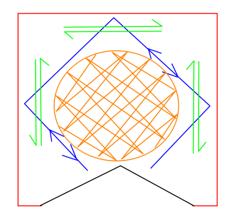

The question of standing waves and comb filters comes up when reflections are off flat surfaces, not surfaces that reflect off in different directions (which are the side walls of a speaker box). This has got to be the biggest issue in terms of insulation and diffusing of potential standing waves.
The flat wall first reflection points in a speaker box can only be the backwall and the flat walls at the top and at the sides of the protruding driver. In those cases the potential is a wave/s of sound reflect in a equal way off the wall to the back of the driver. It is in those places that having insulation off the walls more and or changing the shape of the wall will make a difference in terms of reducing the worst of the problems.
That is how I would make sense of comments about adding more stuffing around the driver, and I have seen on this site some treatment of the back wall to alter the flatness, and how you make sense of speaker designs with rounded backs.

May I add: even in a spherical enclosure standing waves can exist, given excitation. 😉
I believe stuffing the whole enclosure with appropriate absorption is the safest way of taming resonances, i.e. when you cannot evaluate results by measurements, revert to this method. It will tame the (wanted) resonance of reflex or TL speakers too, to some extent.I am mostly interested if a share of this group believes it works or not.
I believe also that less than appropriate stuffing will do in most domestic applications, because your listening room probably has far bigger issues regarding resonances. Weakest chain link.
The burrito solution will work better than traditional wall covering. Just because it is more effective at lower frequencies, where a lot of enclosure issues exist. But without checking the results, you could be missing a few problems with this approach. Just as with every other partial filling of the enclosure.
I would say stuffing the whole box will give the best results at low frequencies. But you would only do this for a sealed box anways. The problem is that the mid range will sound off.
Absorption in the middle sounds better overall.
