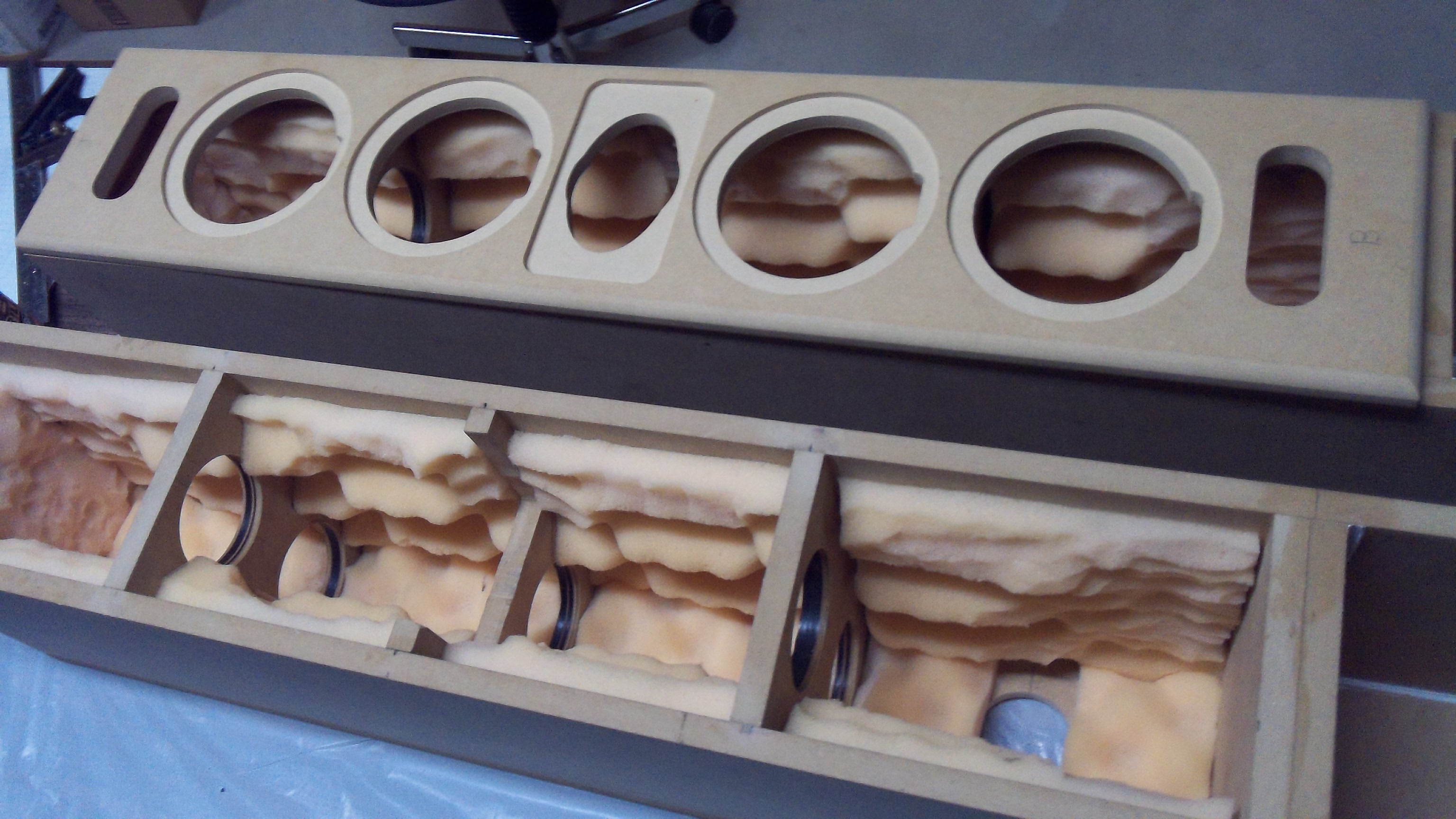

Here is a picture of a box I did that I lined with foam. I know a lot more now then I did then. But even then I had to admit to myself it sounded bad. Like a muffled foamy mess. Of course one speaker with one material doesn't prove much. I do seem to remember that the walls of the cabinet where less resonant with a knuckle test. I ended up tearing all the foam out.
But you're already predisposed to disliking that sound/idea/material. Same as people saying that copper cables sound warmer than silver cables which sound brighter.Here is a picture of a box I did that I lined with foam. I know a lot more now then I did then. But even then I had to admit to myself it sounded bad. Like a muffled foamy mess. Of course one speaker with one material doesn't prove much. I do seem to remember that the walls of the cabinet where less resonant with a knuckle test. I ended up tearing all the foam out.
If you listened to a Geddes waveguide with a foam HOM-reducing plug in it you'd probably say that it sounded muffled, whereas if you didn't know if the plug was in it (blind test), I'd venture to say that you probably wouldn't notice at all.

I eventually used clumps of stuffing in that cabinet. I do believe there was a bit of a standing wave problem in that cabinet. Additionally there was a +6db hump from when the 4 drivers are within a quater wave. Flaws in the design.
