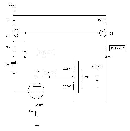

Why the extra tube? Can do the current mirror without it as well.
How about something like this. Throw the current mirror at the top.
R3 is selected so that Vcc-U1 > max anode swing.
C1 is the supply filter capacitor.
Can be no simpler, no? 😀
Benefit is also that the saturation of the toroid initially is less because one direction current through toroid is only half of the bias current.
- Elias

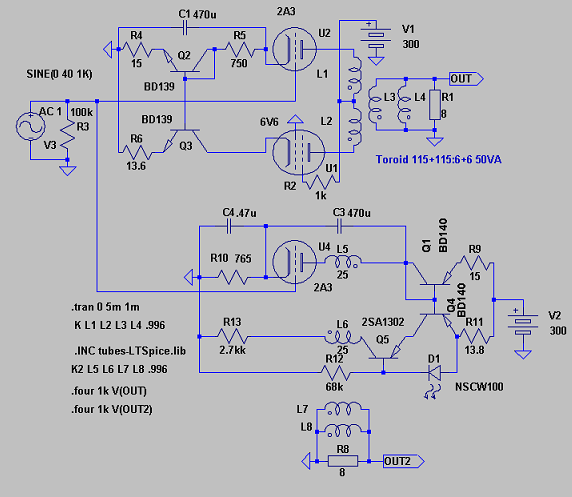

Elias,
Your solution looks far out but interesting, I´m not sure it will work IRL. Anyway I will sim it for you to check.
The reason for using a second tube is that a cheapo tetrode do not need a heat-sink. It is also foolproof, would not trust sand with 300V over it to be so.
Hello,
May I ask what is IRL?
I think voltage rating is no excuse as there are more than plenty of choices of BJT that can handle easily more than 800V.
The dissipation of BJTs are no problem as they do not take over whole supply voltage and because the fact that the Ibias is split into two. I calculated about 5W per transistor, so no heat sink needed instead can bult them to chassis.
If your simulation fails, I'll build a proto 🙂
- Elias

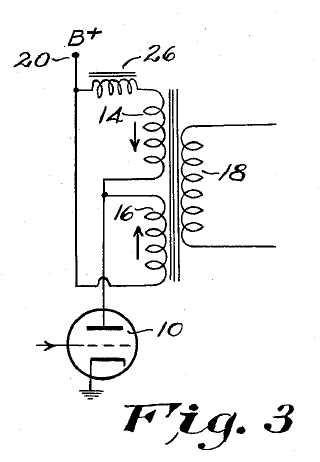

Hello,
I just realised my top current mirror concept approaches this very old idea from one patent. Mirrored current source imitates the choke. It was disscussed here earlier but I cannot locate that thread right now.

The patent works with normal B+ because the ideal choke has infinite AC Z but minimal DCR. The effiency will theoretically be doubled but it will cost a lot since the choke will cost to much. Also something must be done to equal the DCRs and then you loose efficiency again.
If you want your circuit to work you have to double B+(6-700V :hot: ) for a triode-strapped EL34. Didn´t think so far when I said it wouldn´t work:clown: . Then you have to let the resistor above the triode take the heat. So in that sense it will work but what you win in less current adds in voltage. The efficiency will be the same as in my suggestion. So there are no free lunches......
In my eyes this is a lot more complicated. It might be worth if the halved current makes it sound better......
KenPeter: We could do like you suggest but it was not what we aimed for. What you suggest is a self-split PP and the &V& should then be substituted for another 2A3, but our aim was to make a SE. According to the sims I have done the uneven distortion doesn´t look to promising though.

I think I tried to express the operation quite clearly:
I think doubling the voltage is a little bit of exaggeration. Let's say for 8ohm load we want 6Wrms sinusoidal power, so with the given 6V:115V ratio anode swing will be +/-190Vpeak. Can put Vcc = 500V and select R3 so that U1 = 300V. Set anode current Ibias = 60mA. In this case power dissipation in R3 will be 6W, and also 6W is the dissipation in Q2. I think this amount of dissipation is still well within the manageable level. Anyway we are talking about class A SE tube amps here so... 😀
Where is the complication? 🙂 I think this is wery worthwhile as this reduces the initial magnetisation of the core by halfing the DC current, as it can have a huge efect on lowering the saturation of the core in the first place.
- Elias

kenpeter: I simmed your (as usual weird circuit😉 )and mating the 6V6 with the 2A3. Think you got something here. Have you actually tested it?
Anyway, the decoupling cap is critical. To high and you loose low-end(!) to low and you get a bump in the 10-20Hz region. Found 150uF to be optimal in this case. Also when doing this the distortion spectra is evenly falling like a good SE, no traces of PP even order products. Looks promising, but I would call it an Unsymmetrical Class-A Self Split PP😀.

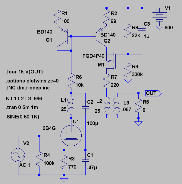

Elias: Please advise PNP BJTs that can take at least 50ma at 400V at a reasonable price. Googling didn´t help me.
Compared to the "standard" topology you actually need to double B+ to get comparable results. Also it works best with the cap from above the resistor to have its low end connected to the triodes cathode. No cathode bypass to ground needed even if a small plastic type would help a little. Also a resistor of a few hunderd ohms should be inserted between the power BJT and the winding.

Going back to your earlier suggestion, can you suggest any easy available, suitable PNP or P-MOS high voltage power transisistors?
High-V P channel
If you have an ON semi sales office, try the MTP2P50EG. 500V and 75W rated.
http://www.onsemi.com/PowerSolutions/product.do?id=MTP2P50E

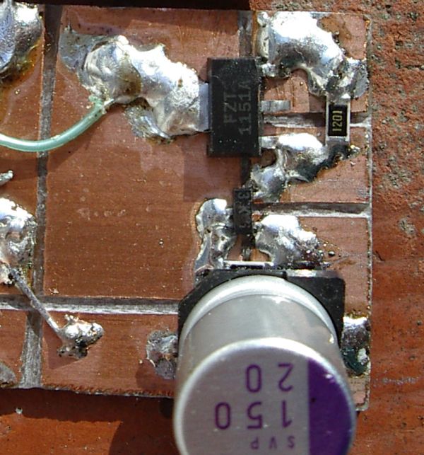

PNP BJT with 400V AND 50mA is very tough (and inefficient), because second breakdown effects are at their worst in that quadrant. A vastly overrated part would be needed. But if you are determined to try that, use multiple SOT223 transistors in parallel, with a resistor in each emitter to prevent "hogging".
Zetex make the best parts of this kind, all the way to 500V -
http://www.zetex.com/3.0/3-3-2b.asp?rid=10
So, for instance you can handle about 300V/50ma with 5 x FZT958, or 400V/50mA with about 14(!) x FZT560.
To build, just get a chunk of copper-clad board and use a hacksaw to cut "tiles" into the copper. Use the Tab to connect the collector, so you can ignore the centre pin (see picture)
