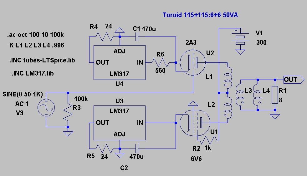

Got sooooooo excited of the idea😎 . Then I remember I saw some Italian guy, Ciuffoli(?), having used the other half of a PP OPT for SE current compensation with another tube.
Anyway, I did a sim just to check out that it basically would work.
In this example I used 2A3/6B4G(can also be a triodemode EL34)as active tube and a 6V6 in tetrode mode instead of CCS. According to the data sheets 6V6 has a Rp of 80kohm and it need no heatsinks as a sand-CCS would! Also used two LM317, at 50mA, as current sinks. Think Shoog used them in his 6080PP.
A 50VA 115+115:6+6 (6,8V unloaded) toroid, has a primary inductance of ca 100H which means 25H/side. This is enough for the 2A3. Load will be 2,3kohms.
Not very efficient but I am sure it will have a SE signature.
Is there someone who has already tried this variation on the theme?

Forgive me if I'm wrong, but I think you are possibly going to achieve the worst of all possible worlds. The bad distortion of PP and the poor control of SE.
As I said before, SE seems like a real waste of time with toroids. I can attest to the fact that a well implemented PP has very few faults and the toroidal transformer gives the PP a chance to shine.
This is because for the same reason that a toroidal core saturates very easily, it also has extremely low hysteresis. This is one of the main advantages that traditional SE transformers have over PP transformer's - but SE transformers have their own nasties in the form of leakage inductance. The toroidal has neither leakage inductance or hysteresis. It is almost by definition the best output transformer possible. The only issue to watch out for is ringing produced by interwinding capacitance.
Just build a PP amp. Consider trying a self splitting arrangement for phase splitting. This is almost exactly what you are proposing, but with the same valves on the output. The main distortion component will be 2nd harmonic which by coincidence is what you will get from SE.

Hi Shoog,
You must explain how the "bad distorsion of PP" will occur in.
About "poor control of SE" I can agree in general but it must depend on the loudspeaker used.
I can clearly see the virtues of toroid and PP but for some applications SE really shines. I was thinking of maybe trying it later for my horn-mids from 300Hz and up. But only if my PP 6B4G fails to deliver😉.
If I where to build a fullregister toroid PP I would go fully balanced without caps and with iron between driver and output. Didn´t you do something like that with your 6080PP?

My 6080PP had an SE front end feeding a toroidal as an interstage phase splitter and then into a differential pair output stage. This is the only application in which the toroidal has let me down in that the interwinding capacitance was to high. This would not have been a problem if I had been able to step down at the same time.
I got my SE flavour from the front end.
I would say, go ahead and build it, but be prepared to change it to a self splitting PP pair. Unfortunately in all my builds I have had to use cathode bypass on the finals in order to implement the cathode CCS.

Did a sim on Shoogs suggestion about selfsplit. The distortion lowered drasticly in the sefsplit but the spectrum was higher from 3rd and downwards with the uneven higher than the even. The SE had a gradually falling spectrum. A selfsplit also needs almost the double drive voltage.
We are building a prototype this weekend. See the last schematic in this Swedish thread:
http://www.hififorum.nu/forum/topic.asp?TOPIC_ID=70440
This surprises me a little because people who have built amps on this principle describe them as SE sounding.
The way I would implement it (and will when I get around to building my own), is cathode CCS in each leg. 1000uf bypass caps from the cathode. Tie the caps negative legs together and ground this node through a 300R resistor.
This is a differential output stage with a earth path for the error signal. Allan Wright experimented with it and said it was the best setup he used short of individual bias adjustment and a shared CCS. This is the setup I use in all my amps. I originally used a 1meg resistor in place of the 300R, but found the lower value to sound smoother.

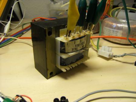

Hello,
I did some additional test with other mains transformers as well. If nothing else it can serve as a reference and a sort of proof for myself that going toroidal route is the best choice.
This is a 110V + 110V / 12V + 12V EI core transformer. Not sure about the VA rating but considering wire thickness I would say it's close to 100VA.
First of all with this transformer in my proto SE amp, f-3dB = 5kHz. Very poor! Also response at 20Hz is heavily distorted as well. Interestingly DC compensation didn't improve things nearly as much as for the toiroid. This one is abandoned!

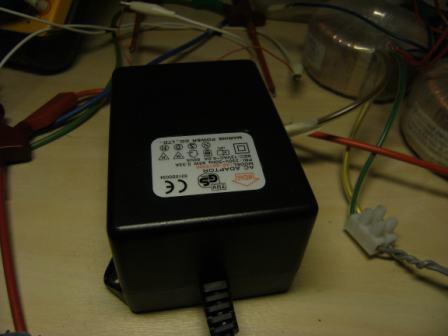

This is another EI core I tested in my proto SE amp. It's 230V / 12V 60VA transformer. As a side note, originally this one is intended for an indoor halogen light set.
I measured f-3dB bandwidth 60Hz...3.8kHz. No additional testing needed for this one!
