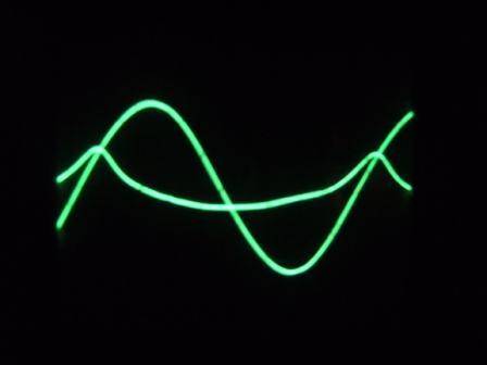

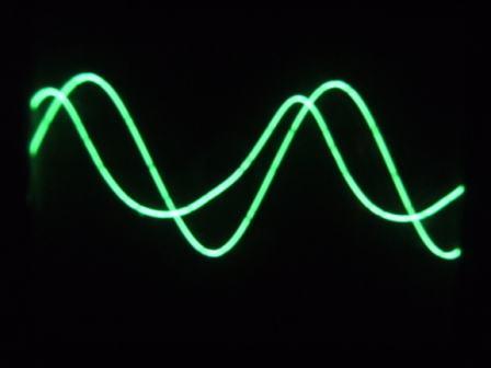

Hello,
I build a SE proto amplifier with EL34 and 115V+115V / 43V + 16V 105VA toroid. Nice weekend project by the way.
I achieved a breakthrough since I was able to make the core to saturate! 😀 But then I also was able to compensate the saturation.
Protoamp setup was like this:
EL34 in triod mode, B = 280V, Ianode = 55mA, toroid primaries in series, 8 ohm load at 16V secondary, DC compensation current at 43V secondary.
Without compensation response at 20Hz looks really horrible!
Power dissipation at the load about 0.5W.
In the pic there is input and output shown.

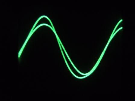

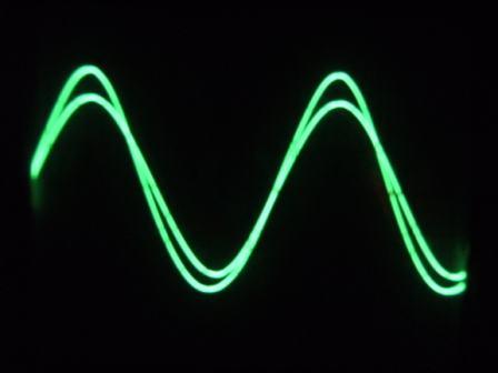

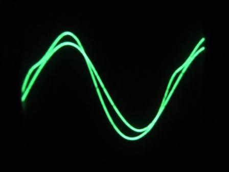

And 80Hz with compensation. Not only amplitude but also phase is corrected!
Using DC compensation freq response is much improved. Without compensation -3dB is at 80Hz. With compensation freq response is 0dB at 20Hz and -1.6dB at 20kHz. Cannot test lower than 20Hz with my signal generator, but it seems to go really low.
Overall quite promising results 😀
- Elias
- Elias

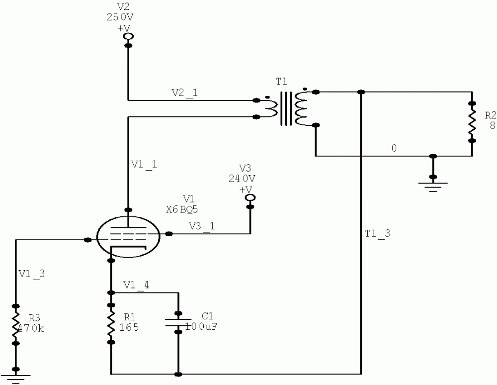

Hello Erik,
The compensation is very simple. I feed DC current from voltage source of about 270mA to the 43V secondary through 100ohm resistor. I know it loads the primary a bit, better would be using current generator with high impedance. That would be one of the next steps I'm planning to do. However, the impedance level propably is not a big issue.
- Elias
- Elias
