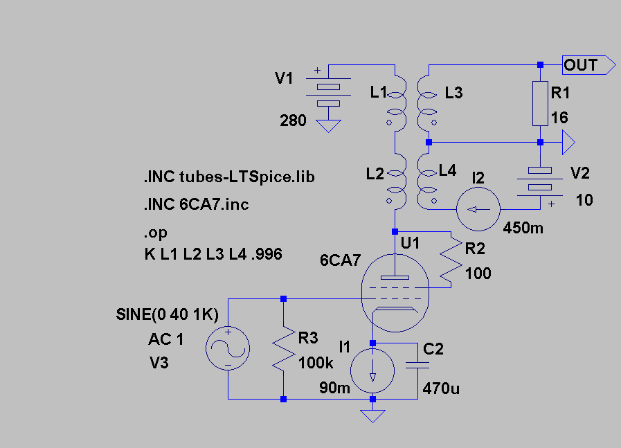

Hej Elias,
Your project is very interesting. This is something I must try😎.
Did a sim and schematic of it. Hope I understood your idea right.
When calculating turns/voltage ratio you should measure unloaded voltage at the secondary.
Also with 8ohms load on EL34 in your prototype you are loading it a little to hard, 16ohms will a more appropriate loading in the ballpark of 3k depending on unloaded secondary voltage.
To use a 6B4G like 316a did, would be even better. But not at all as cost efficient 😉 . For 8ohms load 12V, like you said in your first post, would be more efficient with any of the tubes. A typical 50VA has a secondary of 13,7V and this corresponds to 2300:8ohms.
Brgds

...Also with 8ohms load on EL34 in your prototype you are loading it a little to hard, 16ohms will a more appropriate loading in the ballpark of 3k depending on unloaded secondary voltage.
You are right, 8ohm load at 16V secondary is a bit too heavy load for EL34 and I cannot quite get the power I want out of that tube. Now the distorsion steps in too early.
With this set up I can get about 2W quite pure power. I'll investigate more with different kinds of feedbacks also to find the optimum.
Also increasing +B from 280V would help to get more power I suppose.
Anyway, I've been thinking to wind an extra coil on the toroid for the load let's say something between 9-12V. In theory it should improve things.
