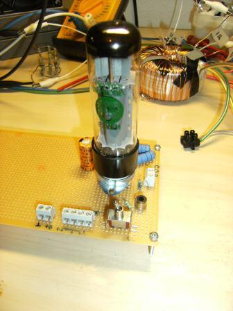

Hello,
My second proto of current compensated toroidal SE amp is coming! Next thing to do is to wire it up.
In the pic background can see the output toroid. I wound some extra turns to have more variety of impedances.
- Elias

Congratulations Hoktuna and Lars!
You have a working push-pull signal-mirrored amplifier.
The bypassed current mirror may be a very good solution to DC
balance and AC drive. I look forward to some measurements.
It looks like you're working into about 11K anode-anode based
on the transformer ratio. What's your output at OPT saturation?
Also, a great use of a pentode, pushing current around under the
control of a DHT.
