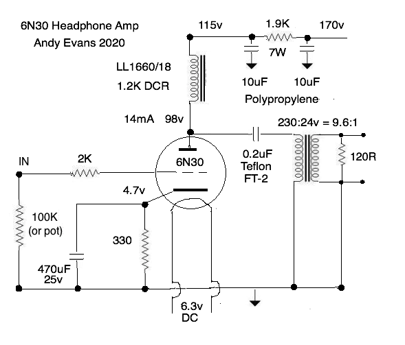

Yes - you're absolutely right. I need a test setup, but unfortunately I don't have one. I have a scope but never studied how to use it, something I should correct. I think I have all the necessary parts for the scope, what I need is an hour's tutorial which right now would have to be over the internet. I keep putting it off since I put time into actual builds, but in cases like this I really would need to measure the results to see if there is oscillation or ringing. I might be able to scare up some photos.
Thanks mondogenerator for the info - very useful. Are you saying that the small VA toroids might sound better for a headphone than the 60VA one I'm using? I have some smaller blue PCB ones I could try - they're Clairtronic but look exactly like the Talema ones. They're more like £15 from RS these days.

Hello Shoog - I was hoping you'd join the thread. So I should try out smaller VA transformers. I can do that. And reverse the primaries - can do that too.
I've put a 120R resistor across the output in the attached circuit. My K701 cans are 62R. Does that sound OK? I'll still get the same impedance matching for the cans?
Exact impedance matching in this situation is not at all critical.
Report back your observations.
Shoog
OK - preliminary observations....
- it sounded better without the 120R resistors, better timbre to instruments and a fuller sound. The resistors added a subtle "closed in" effect, and also sound was quieter.
- I do hear a difference inverting the primaries. The better side is like the above difference better timbre to instruments and a fuller more natural sound.
This is with smaller 25VA toroids, the encapsulated blue plastic type like the Talema ones mentioned above. I have a vague feeling that the 60VA toroids sounded better but could be wrong. I'll swap those back in and switch primaries as well and report back.
I suspect that the oscillations or ringing is in the tube socket. Will try some ferrite beads if I can find them and report back on that. I really need a scope for this - it would be so much easier. Must teach myself how to use it. Anyway, more listening tests to come.
Be careful, the "better timbre" may turn out to be the dreaded ringing and only extended listening would reveal its fatiguing quality. I have seen people report ringing as more "air" before. Ultimately its a matter of taste but be careful of quick listening impressions.

Update - switched back to the 60VA transformer and I prefer it. Not by much but the sound is a little fuller and more natural. I haven't tried switching the primaries yet. Will do a bit more listening as it is now to see if my feelings are correct. This is my initial setup before all the changes, though I have yet to try switching primaries. Seems to run counter to the idea of using a smaller VA and adding resistors. I'm new to all this idea of mains transformers as OPTs, so can't be of much help other than giving some subjective feedback. Thanks for all the help so far - I needed to try out these alternatives.
I also have a pair of LL1689/PPs that I'll swap in at some point. They should hopefully not ring and I'll be curious to see the difference in sound quality.
