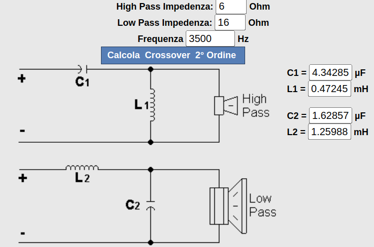

I reread everything and I think I will review the crossover cut, keeping the board and the scheme. I will also smooth the front because done in such a hurry you can see the chippings of the wood. what I have matured listening to them in hybrid mode, that is on the left a LS 3/5a 15ohm and on the right this is that I have to change the crossover cut, so it is too low, I have to raise it and bring the cut to at least 3500, but also 3800. the center that did not sound bad, just a lot of voice because of the two woofers, had a 0.25mH coil on the tweeter and a 4uF capacitor.
ok, in the meantime that the weather improves, too much rain and too much humidity to refine the front as best as possible, I concentrated on the sound and on how much I managed to understand about these WF 1334 & WF Tw...0326h
I redid the entire crossover returning to the 2nd order /12db see in pic.
the only change is on the woofer which has a lot of voice and therefore I increased the value of the inductance a bit. there is a magic that came out when I mounted a panel as if it were the crossover inside the box and this - divider - of the volume puts the woofer in a position to have more depth of sound.
:violin:
L2 = 1.7mH
C2 = 1.8 /2.2 ( there is not much difference )
R1 = 1.2 ohm
R2 = 23 ''

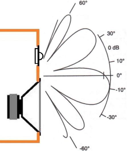

Because a woofer and a tweeter are a certain distance apart, lobing occurs when they play the same frequency.
I'm not sure there's much you can do about that in your circumstances, but you can read more about lobing here:
https://audiojudgement.com/speaker-...apart, and use a 3rd order crossover topology.

but of course yes, in fact as you will have seen I changed the inductance on the woofer compared to the classic 3500hz cut, but these woofers with so much voice do not give up. I was thinking of treating the woofer with the 3rd order to see if by cutting it to 2900 it calms down and adapts.

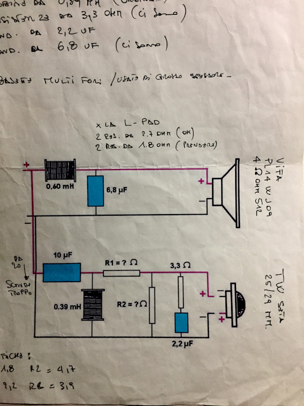

there's another thing i wanted to know from you all - this you see is a crossover a friend made me in 2008 for a two way in a car with vifa woofer and morel tweeter. on the woofer a 2nd order, but on the tweeter i still don't understand what the hell he invented. you?
You can see the second order high pass. It will see everything to the right of that as a lump sum load. The two resistors reduce the tweeter level. The R and C reduce the impedance where it rises toward the higher frequencies, causing the other components to reduce the response of the higher frequencies further than they otherwise would.
The impedance of a woofer will slowly rise with increasing frequency, due to voice coil inductance.
If the impedance changes then so does the crossover frequency. The use of a Zobel network on a woofer keeps the impedance constant so that the crossover frequency stays the same.
Doing this may not be of much help to you in your circumstances. Importantly, you need to know certain parameters of the woofer to calculate the values of the Zobel components: https://audiojudgement.com/impedance-equalization-circuit-zobel-network/
Woofers are generally connected -ve terminal to input ground. Mids and tweeters may be connected +ve terminal to ground depending on the order of the crossover.
