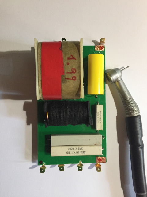

a substantial improvement made last night and tested for a long time:
the inductance/coil on the woofer from 1.7 to 1.2 - on the tweeter 4.7uF*2 in line, coil in parallel 0.45 + resistance in line of 1.5 and 3 resistors of 3.3 in parallel. volume decreased by 6cm, little change. I'm starting to think that I should do a test with the old modified box and with the reflex.

Your current values of C2 = 9.4 uF, L2 = 0.45 mH and L1 = 1.2 mH
- are not far removed from -
my suggested values of C2 = 8.2 uF, L2 = 0.5 mH and L1 = 1.0 mH.

I made the suggestion in recend posts to use a 1.3uH coil and a 4mF, then add resistors for the tweeter. This was simply based on knowing the resistance and size of the drivers and some experience. That is how we build speakers in, maybe 1978.
Make an educated guess, then try to refine it with more and different parts.
If you find such a starting point, it boils down to your ears (and often the parts you have at hand, as these are expensive), how far you can get from there. We spend endless hours listening to speakers under construction, switching to a reference from time to time and trying endless different combinations.

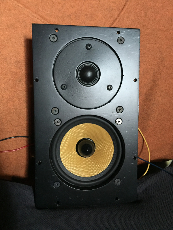

remember those ugly things i assembled to hear how the components mounted on the front LS 3/5a sounded? here is the finished crossover with your suggestions.
I updated the front to a more LS 3/5a look. I'll place the crossover the same way above the tweeter and tomorrow I'll do the satin black finishes.

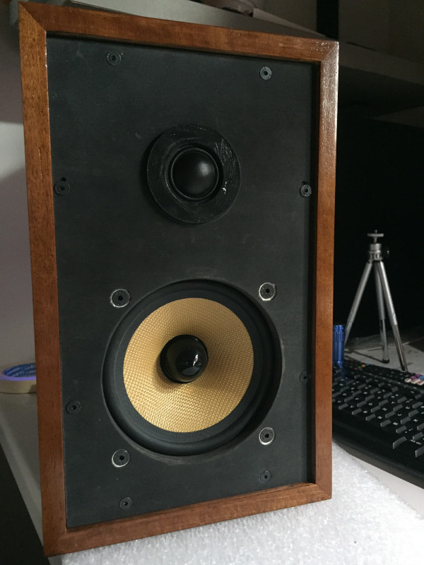

initially, the idea was - what if I mounted a woofer of a different brand, with the same diameter of 5.15/5.25" in the same box (LS 3/5a) what would change, can they be there?
but also from the answers of some I immediately understood that the title was not a great one 🙂
a title could be:
¹ different woofer in the LS 3/5a box
a title could be:

final front baffle( LS 3/5a) hybrid, for PC desktop destination with amp valve hybrid. (next)
