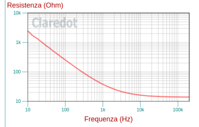

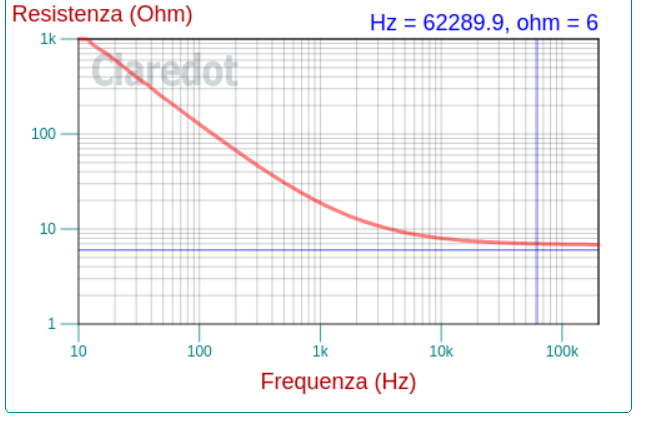

in my personal experience it is a good step forward, but there is still one thing: to create a Zobel network, so I can also experiment to understand the effect on the woofer, to make the Zobel I have to insert two parameters - Le and Re - what would be the best way to obtain them?
if I use those values from your patterns:
Re = 5..5
Le = 0.4
I get this in this simulation
I made a reasoning, tell me if I was wrong - looking at the page you linked me I noticed that the woofer was an 8ohm, so I doubled the values and this came out:
Re = 11
Le = 0.8
C1 = 6.6
R1 = 13.8
I'm alternating the Jeff Rowland and the Carver M1.5t, with the polarity inversion on the Tweeter, not on the Woofer.
I still have to understand why it sounds better than before 🙂

you see that the first time at the beginning of the project I was wrong - I had also inverted on the woofer. then if you remember we had decided on your suggestion to use only the inductance and at that point I had put the normal polarity back. now with 3rd order and the zobel on the woofer normal polarity. I think I got myself mixed up in some tests, now everything is ok.
do you mean that the resistance with too high values, puts the amp in difficulty right? like the Zobel - better if I lower the value of R1 and try to make a Zobel as if the woofer was an 8ohm?
