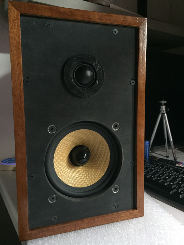

Here's a suggestion of inductor and capacitor values to get you started in experimenting with Turbo's suggested crossover arrangement.
C2 = 8.2 uF, L2 = 0.5 mH and L1 = 1.0 mH
I'm assuming woofer 16 ohm, tweeter 4 ohm and a crossover frequency between 3.0 and 3.2 kHz.

I understand your general observations @Turbowatch2 believe me I don't want to improve my LS 3/5a. It's just an idea to make two computer/desktop speakers using one of the various Ls3 boxes I've built and I find it fun and satisfying if they also sound good.

Put a few bricks from Styrofoam (Polistirolo) inside the box to reduce volume. Anyway, this will not change anything important. The woofer will keep its sound signature.
Try a single coil of maybe 1.3 mH, no capacitor for the woofer. This does more for what you seek.

I opted for a 5db attenuation, but I think I'll go towards 6db, maybe I'll try 6db.
on the woofer single inductance of 1.7, no capacitor.
on the tweeter 9.1uF and parallel inductance of 0.47mH, then the two resistors 1.5 + 6.6
on the tweeter polarity inversion, on the woofer no.
for now without reducing the volume it's a good goal.
