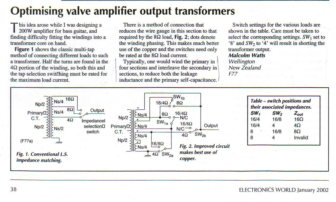

One thing ive learned is how you have to interleave the primary and secondary windings on an OT.
I was told one way around it is to have 2 seperate 8 ohm secondarys, and use in parallel or series to suit the load, but then you are limited to the impedance of your speaker of either 4 or 16 ohms.
I think you still need to learn just the basics before conceiving a custom transformer shop. When paralleling two 8 Ω secondaries of the same transformer, the transformed output impedance still is 8 Ω, and it is 32 Ω if connected in series.

OK, so it gives more gain, im assuming that naturally equates to higher power output?
I really was only considering adding the option of tetrode mode to experiment with and learn from, so Im not concerned if it doesnt work as intended. Kinda gives me 2 amps in one. Im not going to bother with triode mode.
Best regards!
Im going by what an old amp builder told me who used to build guitar amps for a living, his theory sounded correct to me, as i thought he was just treating it like you would with resistors in parallel or series.
Come to think of it, I think he actually talked about 2 ohm secondarys, that would make more sense then?

No, it's the same with 2 Ω windings: Two of them in parallel will yield 2 Ω also, two of them in series will result in 8 Ω.
Best regards!
2+2= 4 doesnt it? How is that any different than the 4 ohm centre tap on an 8ohm secondary? How do you get 8 ohms from 2x2 ohm?
nzoomed,
The impedance of a transformer coil is proportionate according to: (the number of Turns) squared
A 25 turn 2 Ohm winding in series with a second 25 turn 2 Ohm winding is 50 turns.
25 squared = 625
50 squared = 2500
2500/625 = 4:1
2 Ohms x 4 = 8 Ohms
Of course, whether you series windings, or parallel windings, be sure to pay attention to phase.
2 identical windings in series that are connected out of phase, does not have any output.
2 identical windings in parallel is a Dead Short, if they are connected out of phase.
Example, there are some smoked 6.3V parallel windings that were connected out of phase.
25 squared = 625
50 squared = 2500
2500/625 = 4:1
2 Ohms x 4 = 8 Ohms
nzoomed,
25 squared = 625
50 squared = 2500
2500/625 = 4:1
2 Ohms x 4 = 8 Ohms
OK, I understand now.
That would make sense. I dont know what this guy was smoking, but I just trusted he was correct, since he was a manufacturer of guitar amps.
His theory was you needed to make full use of the secondary winding to make it work optimally. He said if you use the 4 ohm tap for instance, you are only using half the secondary, then rambled on about his method of wiring in series or parallel on the OT to match the speaker impedance.
Whenever possible, use all the secondary windings.
I have some output transformers that have 4 each 1 Ohm windings.
Using the proper connections, and all the secondaries, I can get the following output impedances:
1 Ohm
4 Ohm
9 Ohm
16 Ohm
Connecting it the right way is a little tricky, but all 4 windings are used for all of the above impedances.
1 Ohm
4 Ohm
9 Ohm
16 Ohm
OPT All Copper Used
Devised by Malcolm Watts
