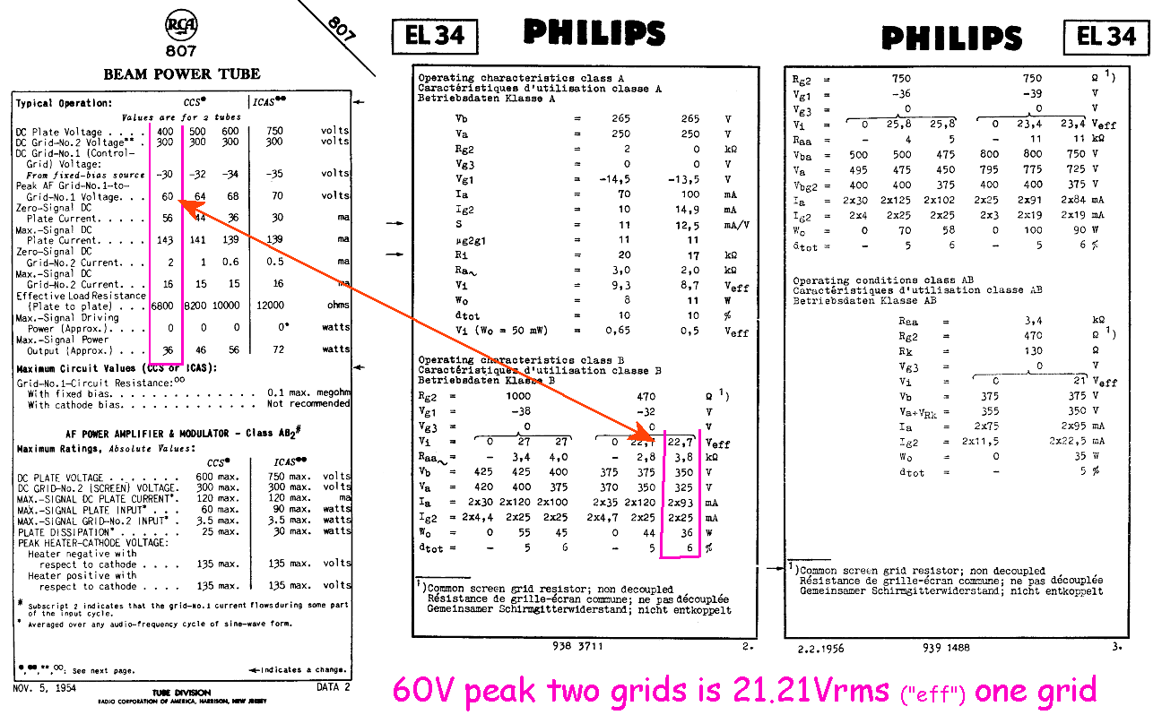

Wouldn't it be nice if tubes had datasheets? Where you could actually look-up and ponder tube performance? From white-shirt junior engineers sweating in pre-airconditioning labs? Instead of ill-formed opinions from "the web"?

Its not like i have not read the datasheet for the 807, as you can see, it confirms that the 807 tube requires a higher grid voltage which is what I already know, its actually higher than what I thought, I had 40V in mind from what i remember, but its about 10 years ago I did anything with 807's.

PRR's point was that for the conditions he highlighted, the 807 actually required slightly lower drive voltage compared to the EL34, and that one shouldn't believe everything one reads on the internet 😉
Im not too sure how he is getting those figures. TBH those philips datasheets are pretty hard to understand, that figure of 22.7V doesnt even have a label saying its the grid1 voltage, nor does it say anywhere that its RMS volts.
Im still not sure how 60V peak would work out to only 21.21V RMS either, my calculations give me 42V RMS from a peak voltage of 60V which is the figure ive always had in mind for a while.

the data sheet from the Philps EL34 is written more in EU standards.
Then take a look at the Mullard Datasheet.
https://frank.pocnet.net/sheets/129/e/EL34.pdf
there ist Vin 55V g1-g1.
Phillips give the Vgin in Vrms against ground per tube. Veff means Vrms and is dutch/german abreviaton for effektiv. Veff x root2 = Vpeak . 22,7V x1,414 = 32,09V peak . 2 Tube with 180 degrees means twice the Volts grid-grid 64,2V peak-peak
It is not a big difference between the grid ac Voltage of an EL34 or an 6L6GC/ 807.

The data sheet clearly said peak to PEAK grid voltage. Not just one peak, but twin peaks.
Think about it. The peak grid voltage is what is required to overcome the BIAS and take g1 to zero. You may actually clip at a bit less depending on your load line, which for a real speaker is elliptical and variable. So you do want a bit of overhead. Whatever vg1 you set the bias to is what you need to drive it with, give or take a volt or two. Then you don’t even really need a data sheet to determine your output stage gain or drive requirement. Set it deeper into AB and it takes less drive for full output, with the penalty being heat.
