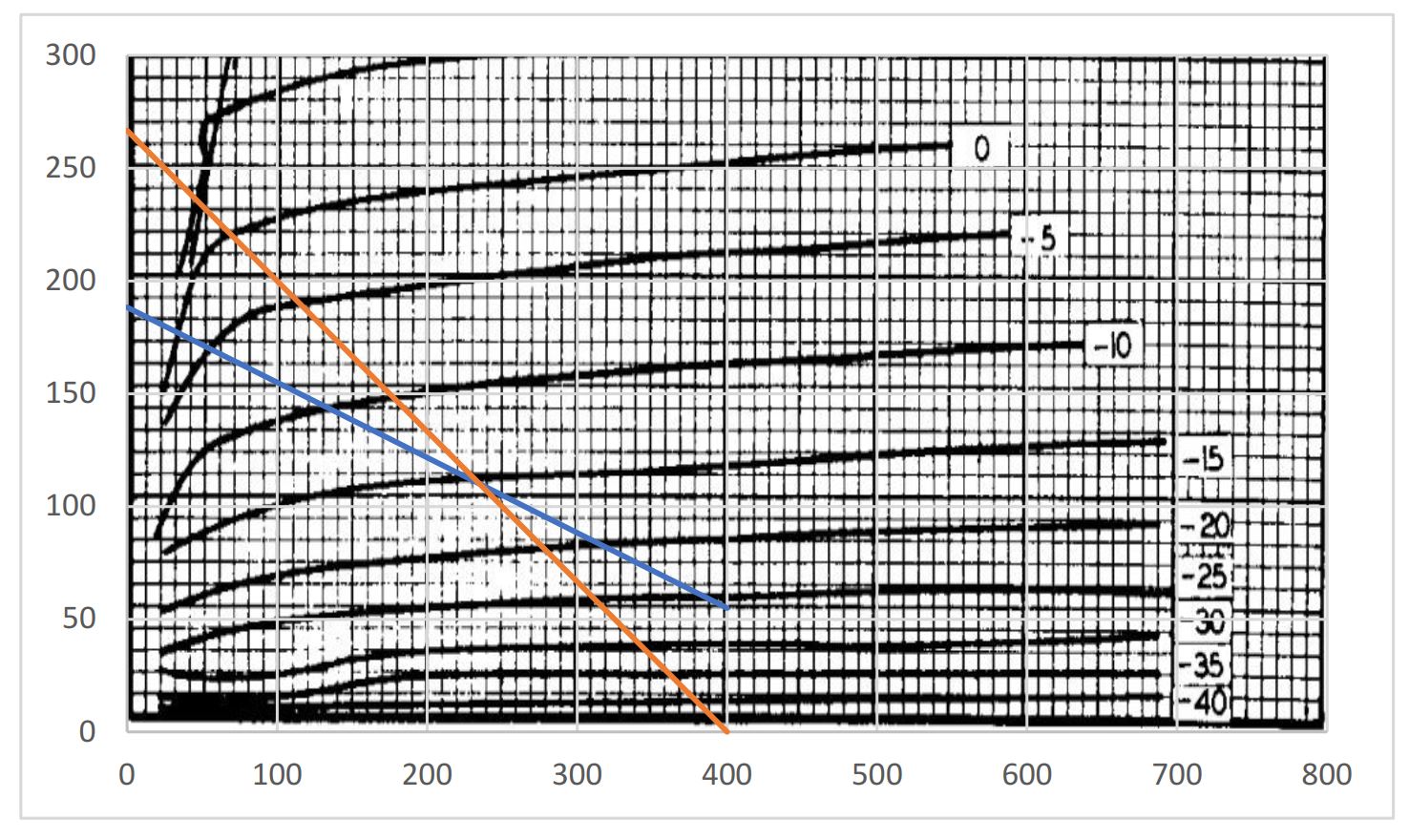

Since Hafler and Keroes invented ultralinear operation using the 6L6GB, you can be pretty sure that 6.6k is about right for the 807. I have seen references to 6.6k-7.6k and modelling confirms that. This for plate-cathode voltage of ~400V and bias of 50-60 mA.
For tetrode operation at 400V plate, 300V screen, a 6k load line looks good (see attachment), but everything that Chris says above is true :).
  • 807 6k 300v screen.pdf

I have been looking at this guide for building a williamson amp using 807 and it specifys a Stancor A8072 transformer for UL operation
http://www.tubebooks.org/file_downloads/stancor_ul_schematics.pdf
The specs for that transformer is 7.6K I thought that may have been high going by what is being thrown around, but the datasheet seems to support this impedance if im running at that voltage which I intend to do somewhere around 440V
Reading back, it appears the figure of 6.6K is for class A, so if thats the case 7.6K seems about right from what I cam make out of it all.
Would you go with this if you had the means to wind your own transformer?
I have a bunch of winding machines, bobbins and rolls of wire, so Im sorted as far as that goes.
With a real speaker load there would be little difference between 6.6k and 7.6k, anything around there will be fine. You're keen to wind your own transformer, hopefully you can track down a suitable winding diagram to follow. I've attached an edited load line for the tetrode connection, I stuffed up the class A loadline (blue line) in post #53.
