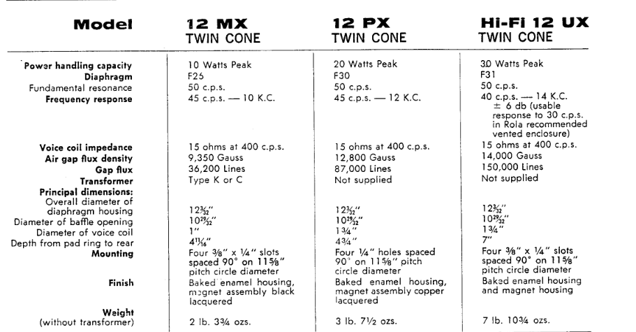

From memory they measured around 7 ohms, but I now have since got a better meter I can test with again.
The impedance is essentially the resistance at a given frequency. Since the speaker has to take a range of frequencys, do the manufacturers typically take an average over a given range?
I will take another measurement today when i pull them out. Its probably worth making the transformers suit them if they are decent enough drivers, even for the sake of testing them out.
I susepect they should have a fairly high efficiency.
1. The drivers should have a data sheet with the impedance curve versus frequency in free air (no enclosure).
Otherwise you are at the mercy of the manufacturer's marketing department.
They can call the impedance whatever they want, nominal is just that, no two judges will call it the same way.
A single full range driver that is in free air (no enclosure), might be called a nominal 8 Ohm driver.
At 20Hz it will probably be equal to the voice coil DCR. But at the cone resonance it might be 20 Ohms or even 100 Ohms. And at mid frequencies it might again be equal to the DCR, and then increasing at high frequencies to be 20 Ohms at 20kHz.
What would you call the average of that?
You begin to see the problem.
Putting the driver in a very large area flat open baffle; or an empty closed box; or a very heavily stuffed closed box; or a ported box; or a transmission line enclosure; or on an extremely large horn; will give different impedance results for each.

Interesting that the impedance changes depending on the enclosure, im assuming this has to do with the interaction of the magnet depending on how much air resistance there is on the cone?
This is all the info I can find on these drivers.
Your right, its 15 ohms according to this.
That could make winding the transformer complex if i want to optimize it for these drivers, I think long term I will stick with 8 ohms however, as these are only rated at 20 watts, and my 8 ohm speakers are rated higher.
