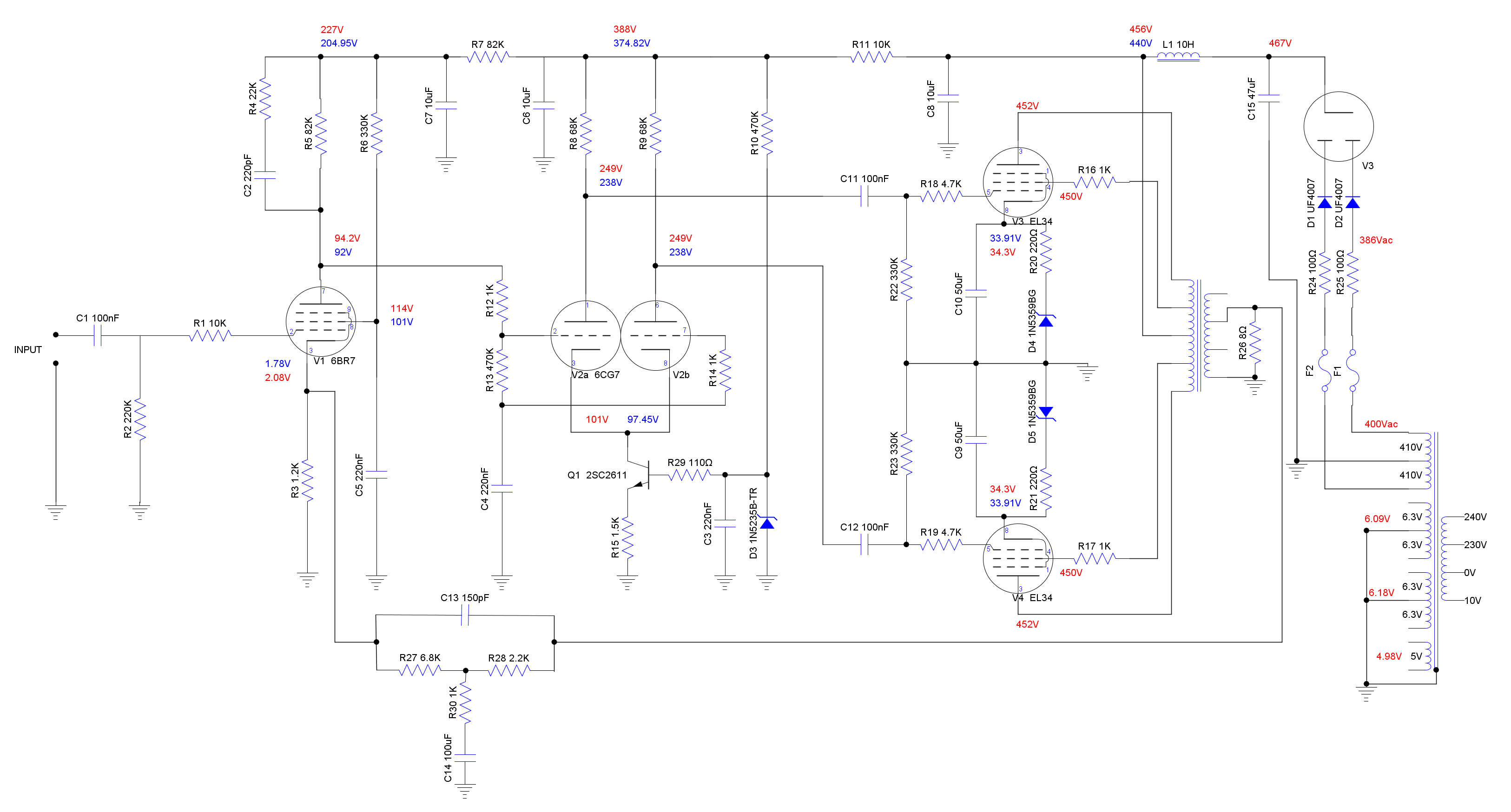

OK, i understand, it certainly looks like there are alot of tradeoffs by the sounds of things.
The guy who used to wind the transformers started his business with little to no knowledge, yet was able to pick it all up and his work was widely regarded as high quality.
Im sure I will be able to figure things out with enough time.
I think its safe to say that going for 6.6K is the safest bet for a first go anyway.
One thing ive learned is how you have to interleave the primary and secondary windings on an OT.
This explains why alot of amp builders always like to use the full winding of the secondary, as having a tapped secondary with a 4K load and you are only using one half of those interleaved windings.
I was told one way around it is to have 2 seperate 8 ohm secondarys, and use in parallel or series to suit the load, but then you are limited to the impedance of your speaker of either 4 or 16 ohms.

If it helps, this is what I ended up turning a standard 5-20 build into. My output transformers are 6.6K sowters with 43% taps that I specified with tapped secondaries which bit me in the backside when it came to stabilising the feedback. I was unaware at the time of ordering them that tapped secondaries had the issues mentioned earlier in the thread.
I just tried dropping 6L6 into the spice sim I have for the amp and they appear to work just fine. With a lower supply voltage, they should be fine. My 410-0-410 transformer ends up feeding nearly 460V B+ so pushes an 807 beyond it's dissipation limit in my circuit. With 420V B+, idle dissipation is under 20W. Looking at it has peaked my interest in possibly getting a set of 6L6GC's to try.
