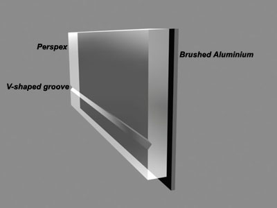

I am building a case for my aleph ono, and I need to do a special glue-action: I have a sheet of aluminium with text printed on it, and a piece of plexiglass.
With the info found in this thread, I bought a small bottle of Chloroform, and I am now ready to start glueing.
Apart from the dangers that Chloroform has, does anyone know how this will work? How sticky will it get? how long does it have to dry?
This is what the construction will have to look like:
attachment.php
The original question is on page 15 of this thread
Bouke
If that stuff is basically a solvent for the plexiglas, I would be willing to bet that it will adhere to the aluminum. The dissolved plastic should grip into the "tooth" of the aluminum, since it is brushed. I wouldn't attempt it without some extra material with which to do a test though. Chances of getting it right immediately without experience seems low to me.
If it's anything like model cement, I would be worried about bubbles. You want to be able to see the aluminim through the plexiglas, right?
:xeye: 🙄 :scratch: :dunno:
Good luck
/Vince- thinks it could be tough to get it right.

I have made a specially painted frontpanel, and the connection between the aluminium must me crystal clear with no bubbles.
I've got enough to practice... so that woulnt be a problem..
Thanks for all the tips
Bouke
