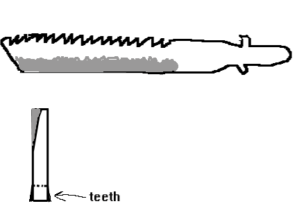

Maybe I reinvented the wheel, but when cutting the driver holes in my sub with a sabresaw I found out that if grinded of a little of at the back of the blade, it was much easier the follow those curved lines. The grey areas in the pic below is what I grinded away. Try it! it makes a huge difference.

Here at Home Depot in the states, the sell blades that are exactly as the one you drew in the top of your picture. They don't cut straight lines as well, but for circles for speakers, they worked great for me.

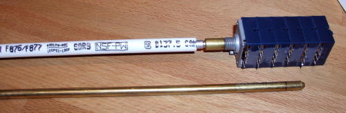

Sometimes you need extention on a pot, yet a proper hardware is hard to obtain. Just recently I found out that 1/4" plastic tubing for water supply and 1/4" brass rod available from home hardware stores (HD) are perfect for that purpose. You don't even need screws, everything is tight fit.😉
