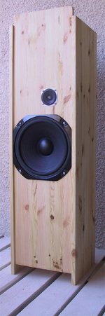

That was the saw that I tried once, it was not bad (for cutting wood, never tried metal). Also, WalMart (where I bought that from) had some replacements blades (for fine cut, fast cut, etc., but not metal IIRC). I subsequently returned it as I do not have enough space in my appt to use a saw. Also, my approach has been to keep the contruction as simple as possible: my Zen4 has only 2 cuts (wood), and this TB open baffle has none (other than the circular ones) - I like simple designs (circuit as well as construction). Part of the challenge (for me) is to make use of available (nearest HD) materials without modification to achieve desired goals. So far I have been able to get away with just a router.
