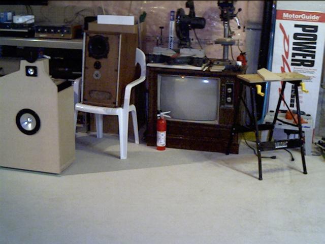

I picked up the TV by roadside and mounted the drill press on it.
I have also mounted the 10 inch mitre saw on a surplus kitchen cabinet door so that it can be moved and used anywhere easily including flush resting on top of the TV.
OLD strong TV can be used as work table bench.

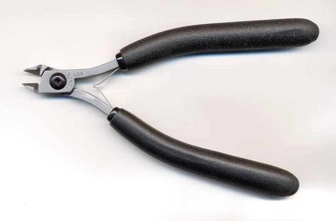

i asked my wife for some new diagonals for Christmas -- from the Future-Active catalog of course -- the kids had used my good Xcelite snips to cut coat-hangers or spark plug wires -- these new Xcelta dikes are kept locked up!
