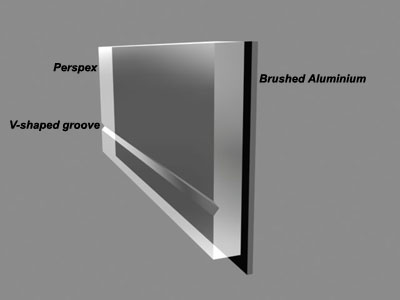

I have two questions, relating to the picture below. The goal is to have text on the aluminium (photolithic process), glue the perpex plate over it, and have blue leds shine through the perspex on the aluminium. The V-shaped groove should remain matte, and light up in the blue glow.
- How do I glue the perspex to the aluminium in an "invisible way"?
- How do I make the v-shaped groove without a milling machine?
Thanx for all help.

GLUE
Hello Bouke,
You could try a spray-on glue.
Personally I would use some screws though since I fear the glueing will show up sooner or later.
To hide it you could use a tainted perspex.
For the rest of your QQ,I wouldn't know.
Cheers,😉

One way to make a V shape groove is to use a table saw with a blade for plastic. You just have to tilt the blade 45 deg and adjust the height. I imagine you woud still have to polish it, to have it matched with the rest.
On visible part I wouldnt use glue, because it will always show and with time might change properties as well.
Just a thought, if you plan to use pots knobs there, you could use the nuts on the pots to hold everything together.
Alternatively...
If you drill and tap the perspex from the rear, the effect is actually quite nice.
Make sure the blind holes are all the same depth, and positioned exactly. They will just look a cloudy white colour.
Bouke,
2 options to glue the plexiglas (i guess that's perspex)
1)
use 1,1,1 trichlorehtane to dissolve the plexiglas on the surface and one can expect supersmooth glue joint without any bubbles or air cavities.
I tired it out with plexi2plexi joints and plexi2metal, works fine. Just .... the stuff is deadly poisonous, you normally don't get it without a master degree in chemistry and a company letter head.
2)
Röhm sells some plexiglas glues under the Acrifix brand which meant to harden/settle from the ultraviolet component in our daylight; those glues also make fine glue joints. If you glue the plexi on brushed alu, should be fine.
I used to use AcriFix 92.
V-groove: i agree with Peter. Leave the goove unpolished, you want the blue light get scattered on the groove's surface; the rest of the blue light is caught within the plexi by total reflection if you couple the light into the edges of the plexi frontplate.

Gentlemen,
Thank you so far for the glueing advice 🙂 I'll ask my University chemistry friends to arrange some of that 1.1.1 trichorethane or similar stuff.. I like the idea of perspex (plexiglass) solveant... Maybe they can think of some less lethal solveants
Bouke
