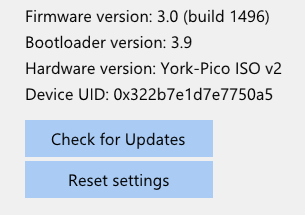

Hi Marcin,I'll send you a new version of the config tool with new feature: set all settings to default.
I've added a new button to the about tab to reset the settings:
After click it would set default setting which is I2S 2 channel output with on-board 512fs clocking. Try checking I2S right after that, no need to change any settings. I've checked on my side, if it does not work - then something happened to the hardware.
Link to the new config tool: https://york.eclipsevl.org/config_tool/york_config_tool_06_jan_2025.zip

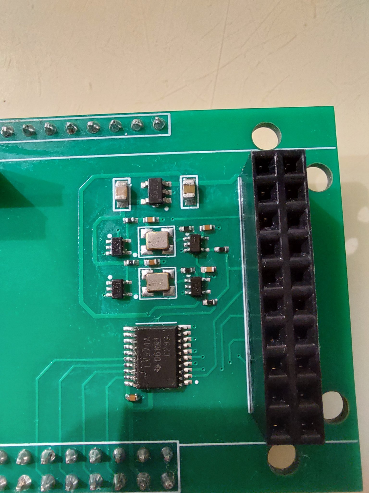

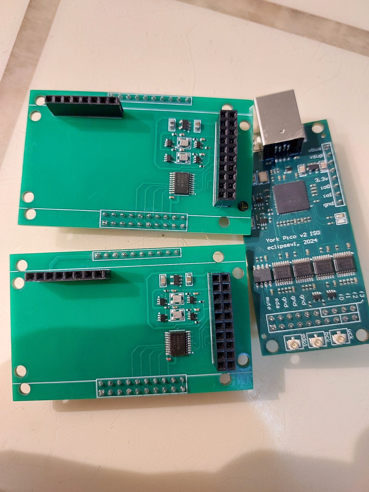

Hello @MarcinGD ,My question is can we replace these oscillator on reclock board with let say NDK NZ2520SDA?
Yes it is possible. I have done on two of my reclock board.
I believe @eclipsevl will have some good news soon on a new reclock board that allows XO of different footprints.
For the oscillators, yes. The schematic was posted in this thread.Ceramic caps and ferrite beads?
Only one the oscillators is enabled at once (if they have OE functionality).
Not sure if I understood it correctly. If you are referring to ground layout, the bottom layer of this board is a ground plane and all connections are done directly to it with via's.Shared IC ground bounce?
