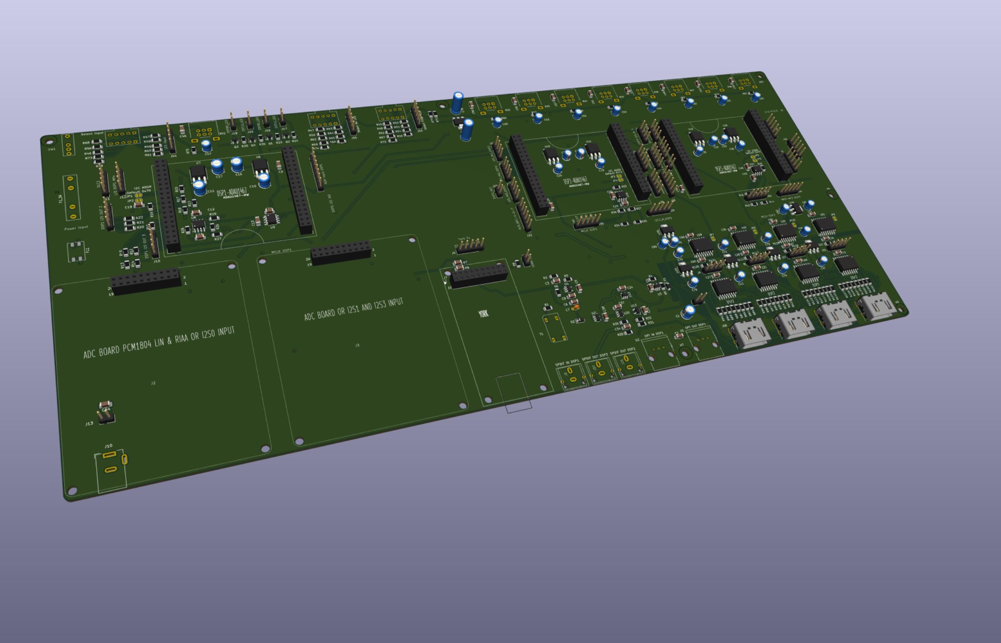

Hello Vladislav,
I want when on my ADAU1467 card the USB is not used that the I2S used by YORK can be used by another interface. I use YORK mainly with SigmaStudio and very little in musical USB. On the ADAU1467 there are only 4 I2S inputs, it's not huge.
Thank you for your response.

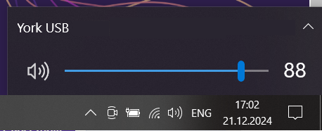

A bit of news from the next firmware update.
Currently York does not have volume control feature and if the volume is adjusted in Windows, for example, it is in fact done by Windows mixer. In Linux/MacOS volume control does not work and York always outputs 0dB signal.
But it is possible to "ask" OS to send current volume level to York and either do volume control on the MCU or send the volume value to external dsp/attenuator.
So this is the feature I wanted to implement for quite some time.
Here is an example with implementation of volume control on relay attenuator (I designed this module about a year ago):
The attenuator is connected by I2C bus, DAC input is always 0dB level.
I recorded a short video as a demo, in the video I scroll Windows volume control slider:
Also tested in MacOS.

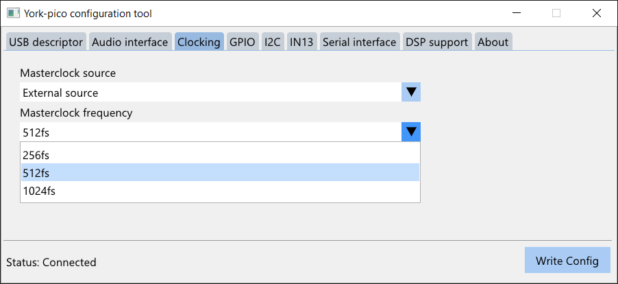

Hello Marcin,
the two most important things are frequency and output level.

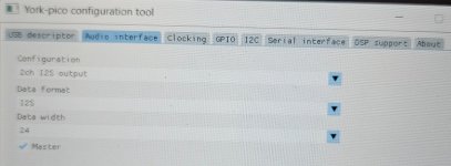

The frequency options available are 256fs, 512fs or 1024fs. Where fs is 44.1 and 48kHz.
By default York uses 512fs (22.5792 and 24.576 MHz). If you choose 256fs or 1024fs, please adjust the setting in config tool accordingly on clocking tab:
The output signal level of the oscillator should match power supply of the isolated side. For example, if the iso side is 5V, then the clock level also should be 5V, 3.3v is not suitable.
On the reclock board I use 3.3v oscillators but there are level shifter ICs that move the level to 5V.
Also, in pin F2 indicates which grid is selected: 44.1 or 48kHz. Low level means 48kHz grid, high - 44.1kHz.

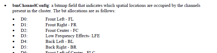

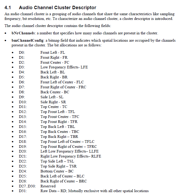

One dumb thing I might ask, is whether the interface will allow for a 2.1 setup. Today I use my PC sound card in 2.1 mode to allow for a sub.
You could of course do the split in a DSP down stream, but just wondering.

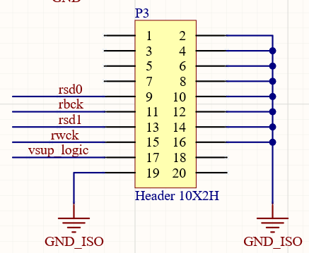

Hi Marcin,
For the reclock board:
2ch nos output
pin 11 / rbck is the bit clock
pin 15 / rwck would be the latch signal
pins 9, 13 / rsd0, rsd1 - data signals for left and right channels.
2ch I2s output
Here it will be a bit confusing for the reclock board. The York pin functions will be according to the datasheet but signals on the reclock board schematic would not match with the wire names:
pin 11 / rbck - bck (bit clock)
pin 13 / rsd1 - wck (word clock)
pin 9 / rsd0 - sdo (data)

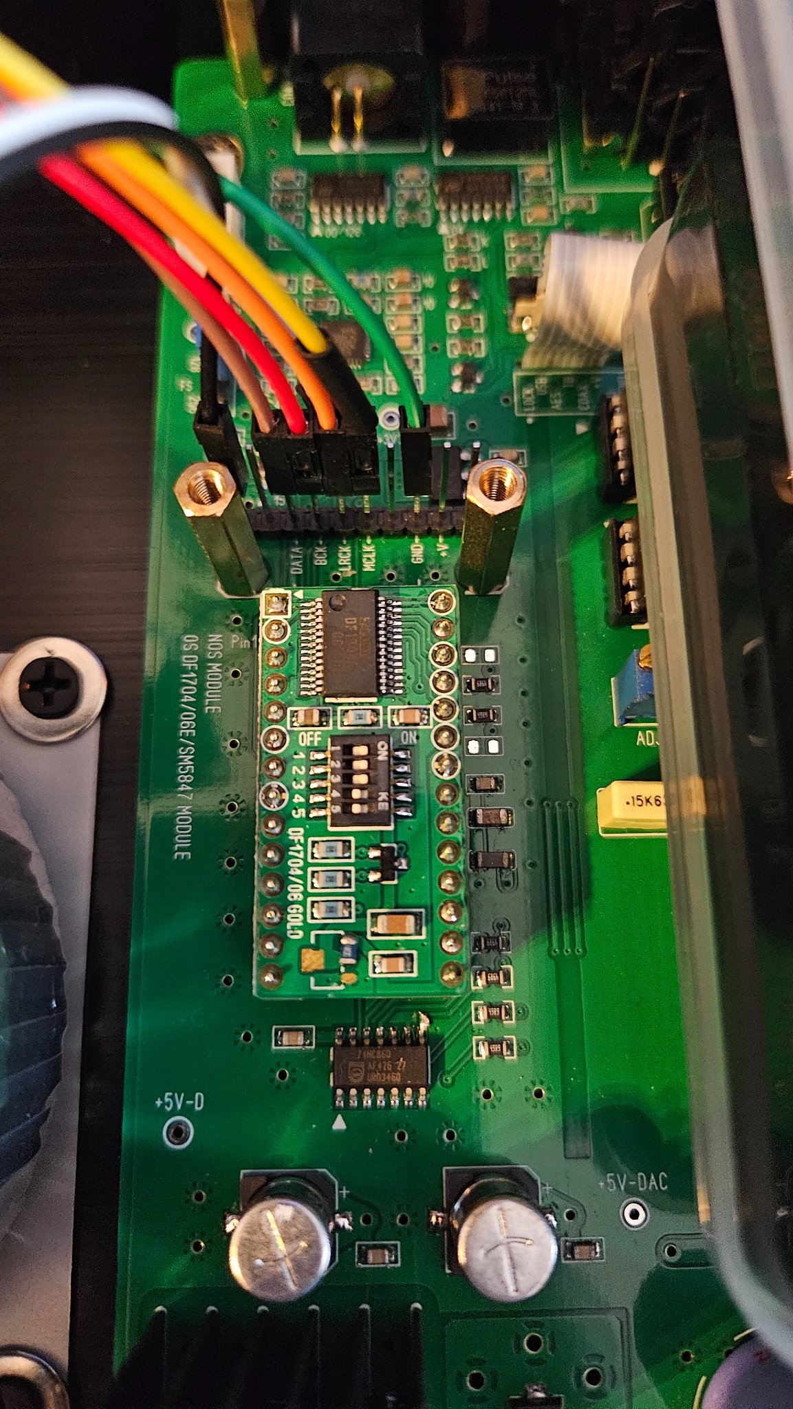

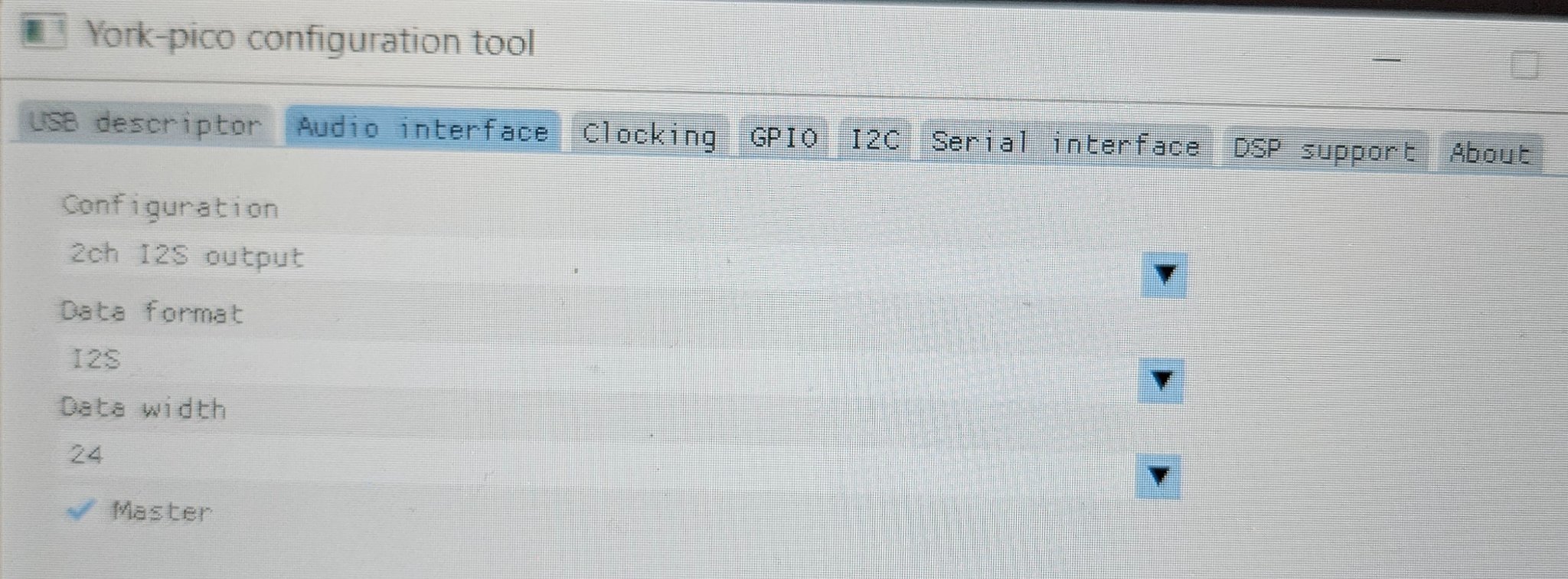

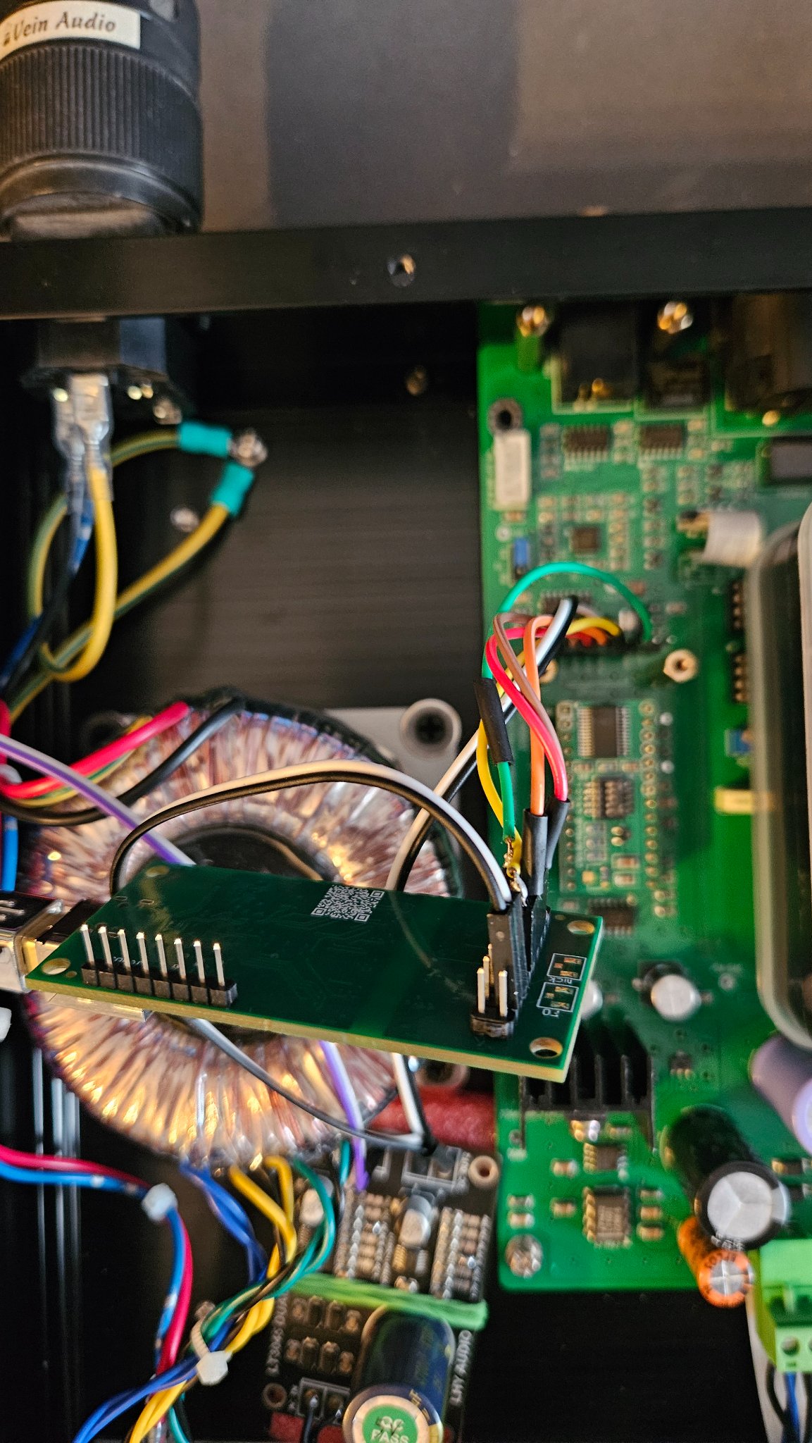

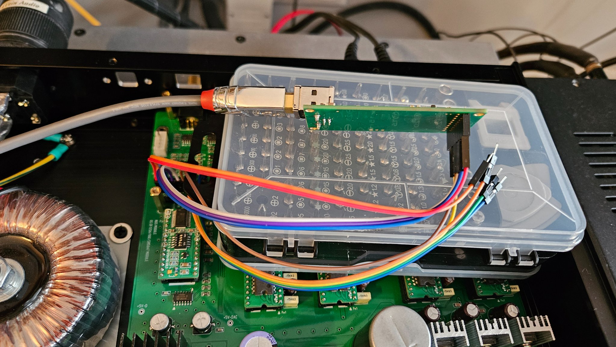

I have pcm1701 dac with Chinese amanero that i wanted to replace with york. I can't get it to work in this application. Dac have input selector utilising pin 1 plug where on Chinese amanero when source active it gives 3v and on york it gives barely 1.48v which is too low to get usb source active. To bypass that for test I placed 3.3v on that pin on dac board to have usb input active.
I've checked what signals I need to have to work with amanero.
1 - plug
3 - data
4 - bclk
5 - lrck
6 - mclk
8 - gnd
After this test I connected york as below.
3 - 5 sdio1
4 - 7 bckio1
5 - 9 wckio1
6 - 11 mclkio
8 - 6 gnd iso
And of course 1 to 3.3v to have usb input selected. Unfortunately no sound from output. Iso side powered with 3.3v.

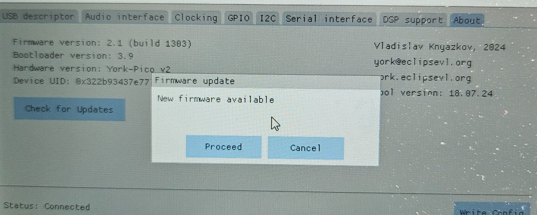

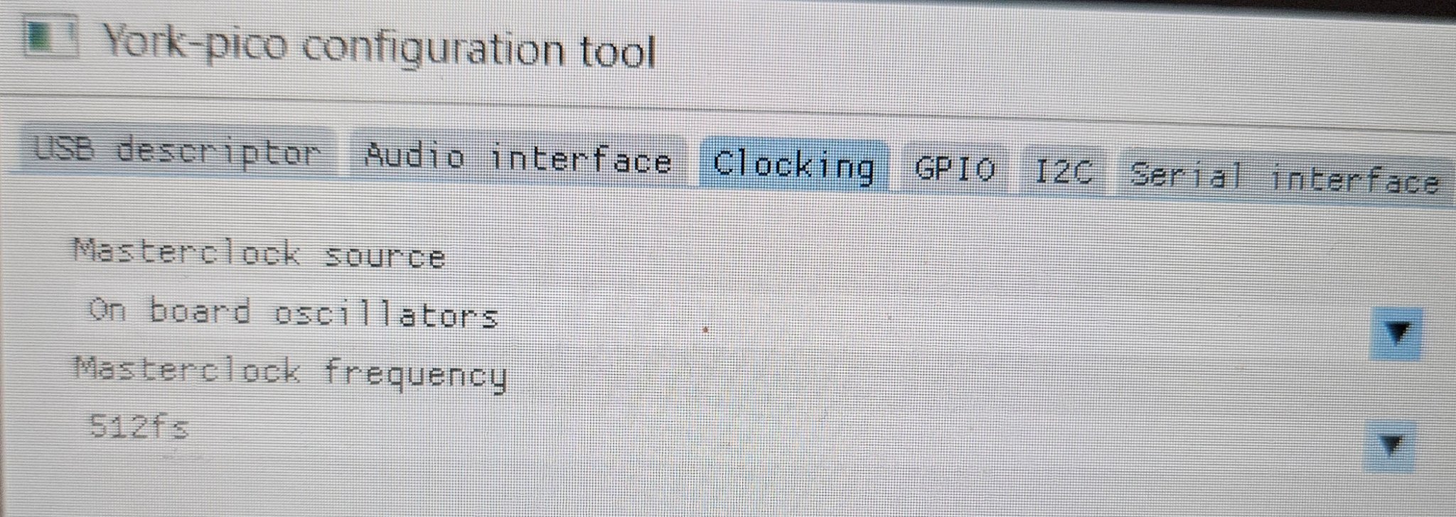

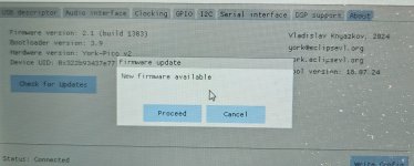

Another thing is on the update page even though I made an update it all the times find new firmware.20241225_110422.jpg20241226_121522.jpg20241226_125544.jpg20241226_130731.jpg
Hello Marcin,
Sorry for the delay. I see that the fw version you have is too old, looks like when you updated it was in fact rolled back.
So I see two options what happened:
1. The module was updated before dec 25 (when I put the latest version which supports ISO hardware.
2. I messed up the version on the server
Either way, can you please try to update again?
Great! Sorry for the confusion.
I’ll implement version check in January

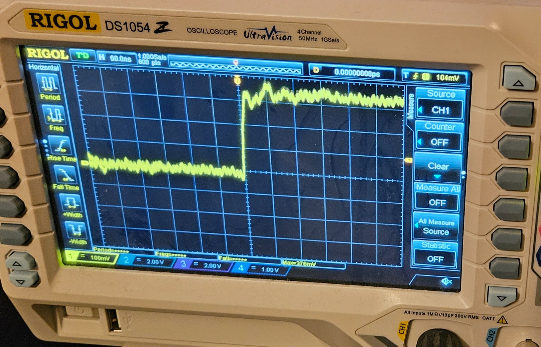

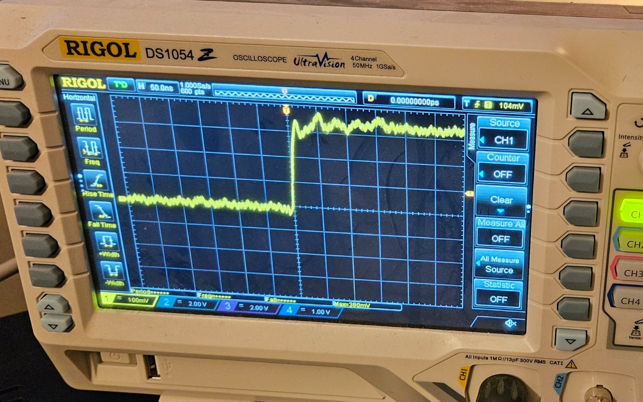

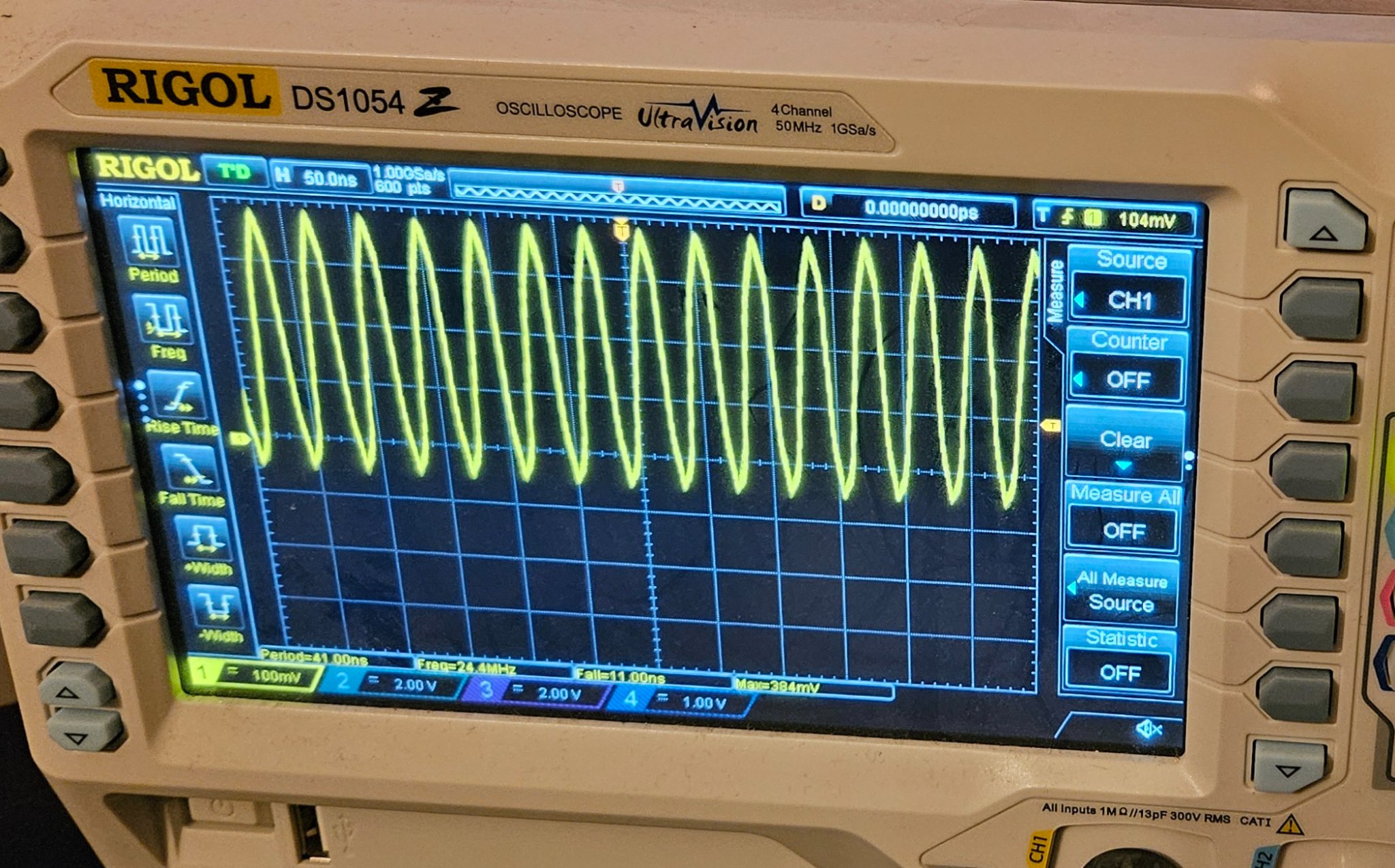

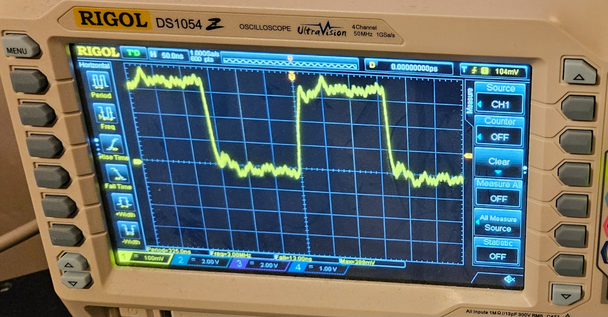

I have a lot of noise. I can hear it and see it on the scope. I need to check if it's from psu board.

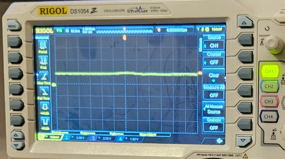

I’ve never noticed that. Please let me know if you manage to identify the source. In my experiments the ISO version signals were significantly cleaner than regular USB powered one.
