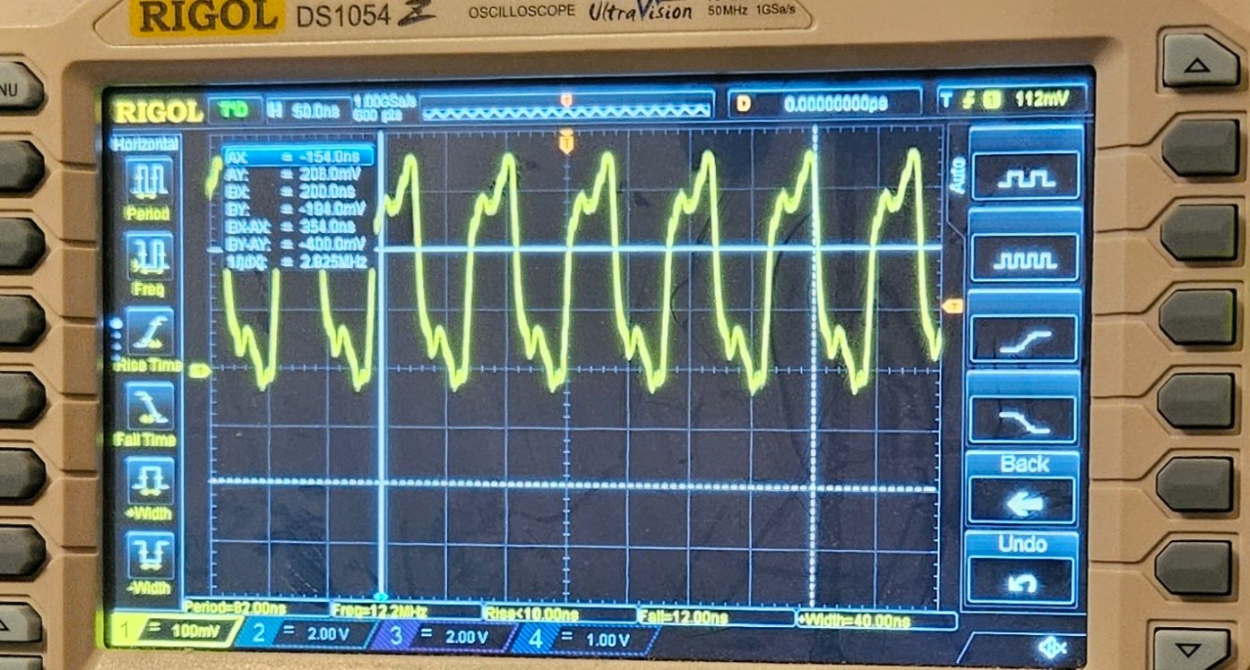

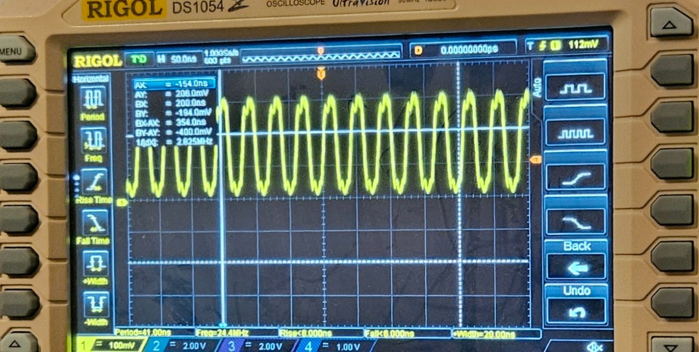

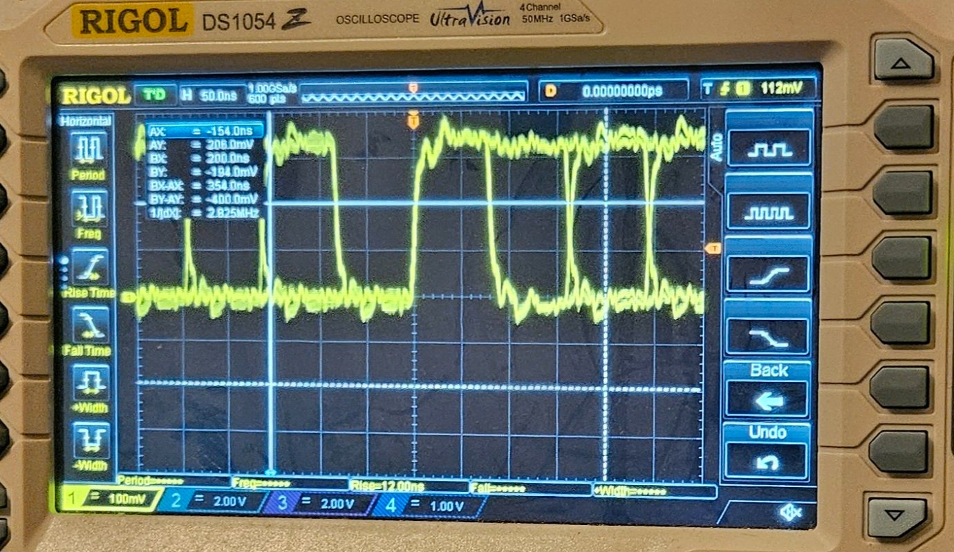

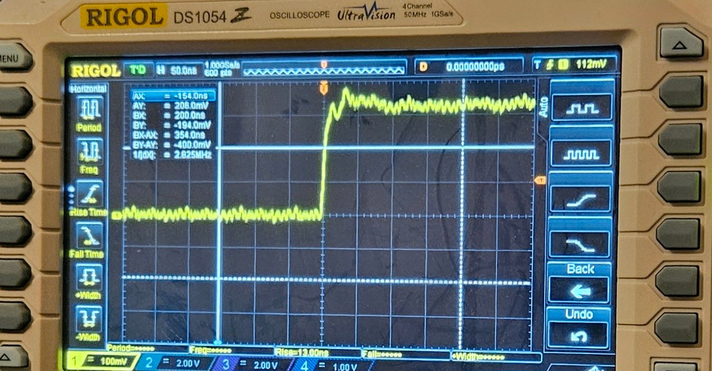

To eliminate psu problems i just hooked my laboratory linear psu. Below is what I got on the scope. Data, bclk, lrck, mclk. Data and bclk are not as should be. Audio is heavily distorted.
If the sound is distorted, something is indeed wrong with the signals. Other than ringing (which can be setup issue), the shape looks correct.
One weird thing I noticed on the waveforms is the frequency of mclk and bclk. If it is 192kHz stream, they must be 24.576 and 12.288 Mhz, on the waveforms the scope shows 24.4 and 12.2. Is that correct measurement or just rounding error? What is the behavior at 176.4kHz?

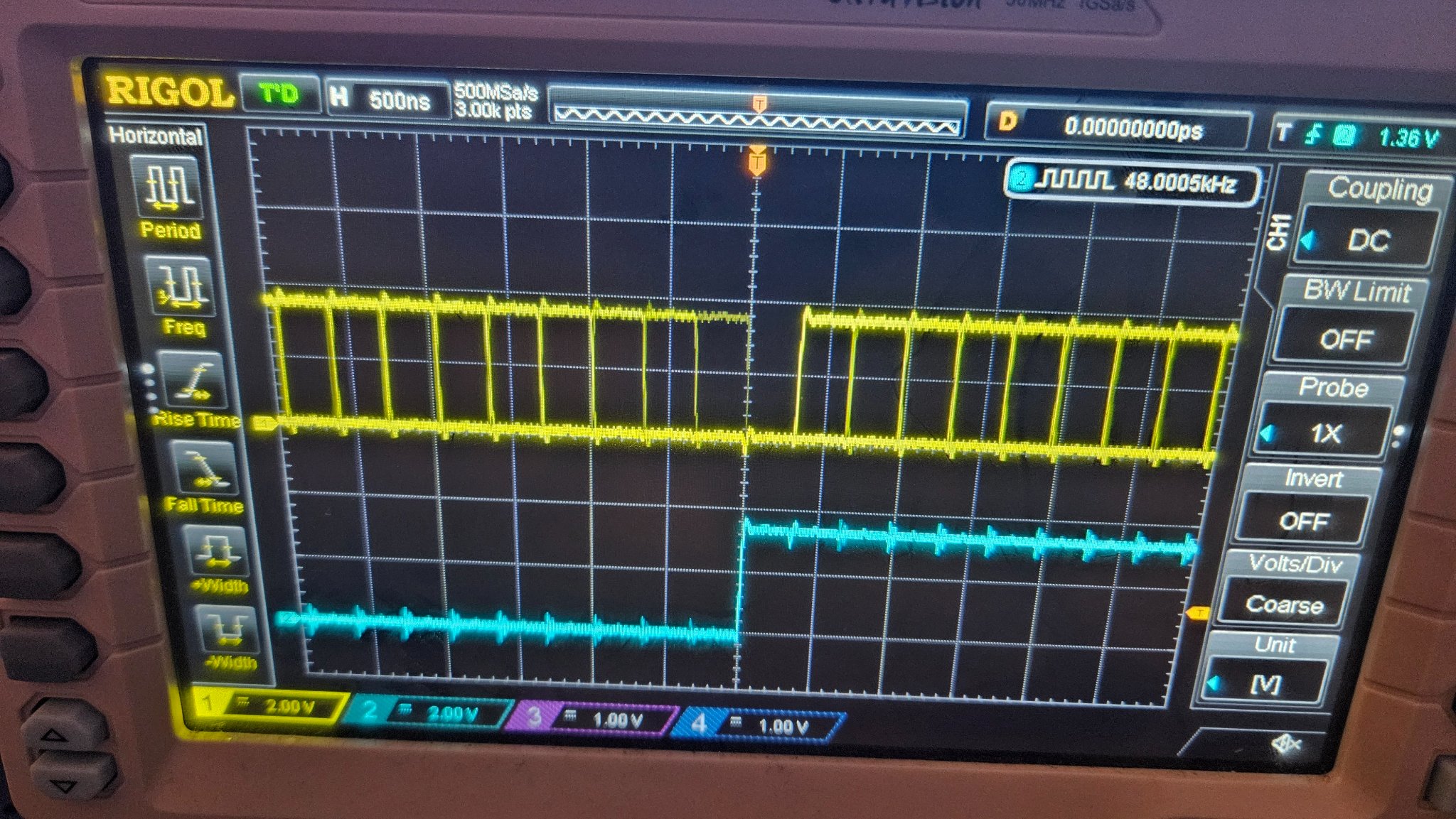

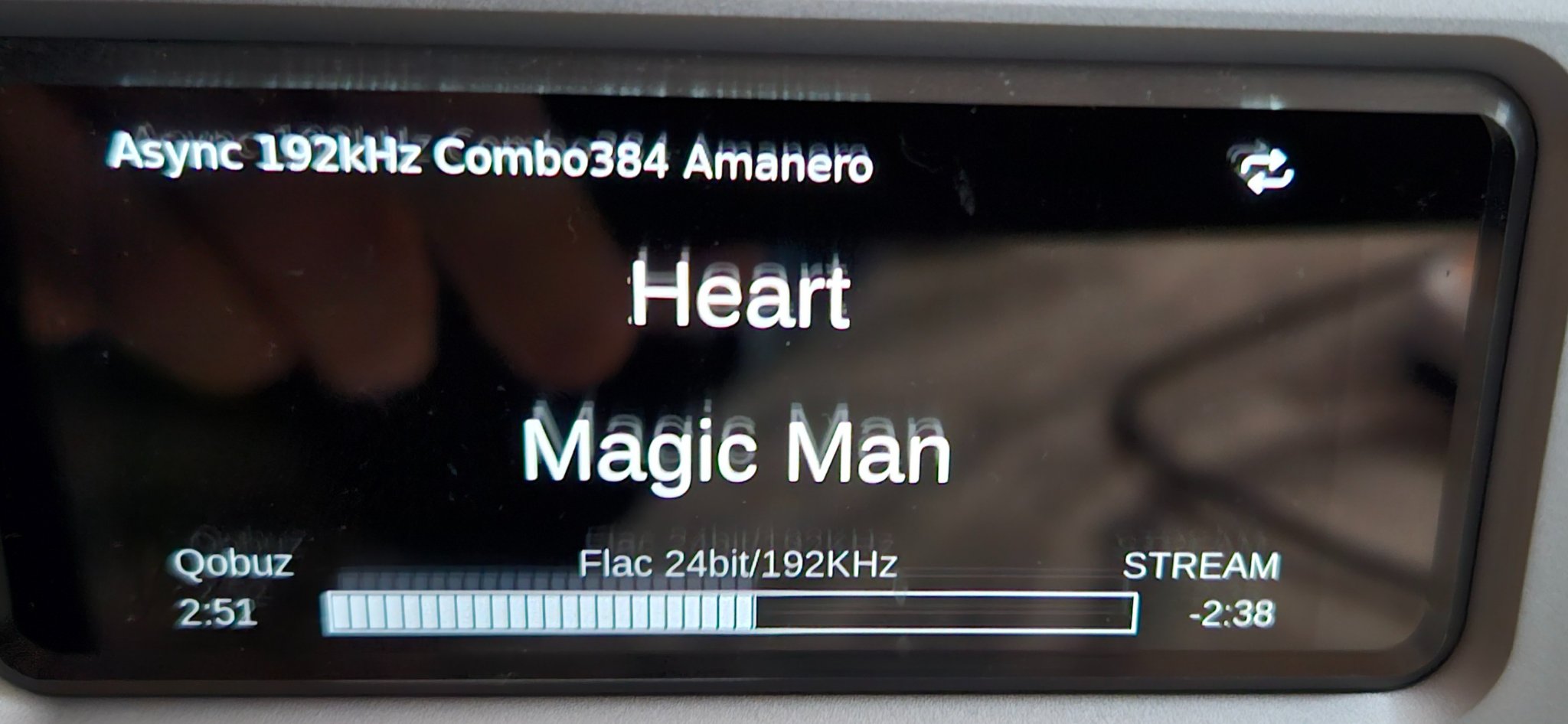

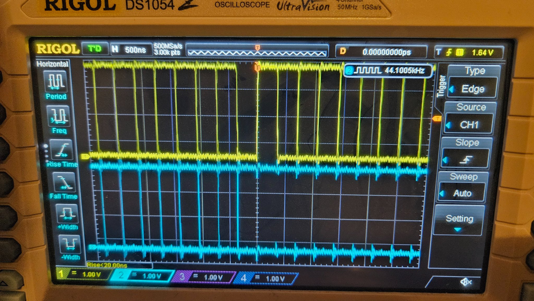

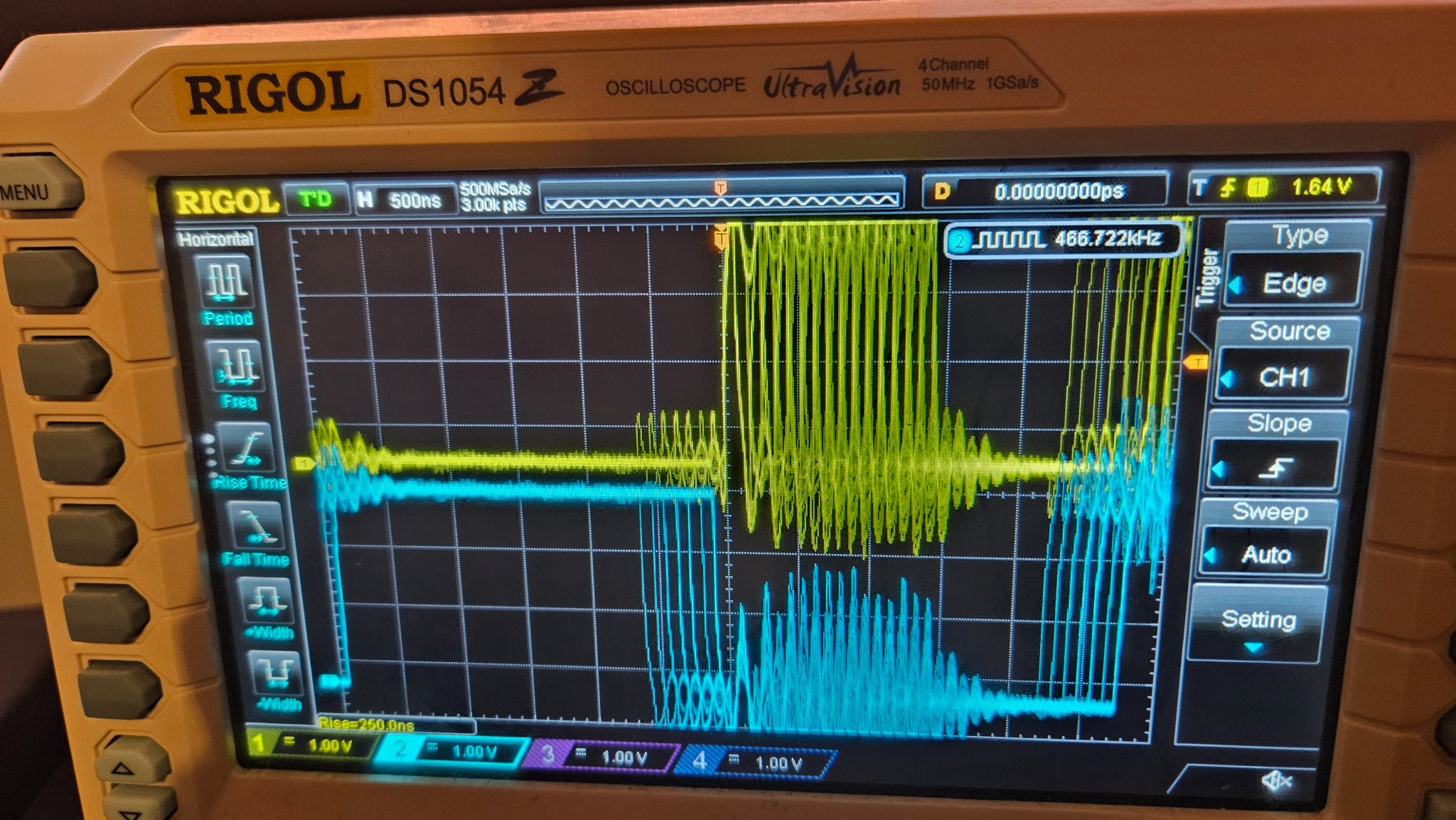

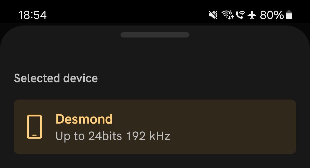

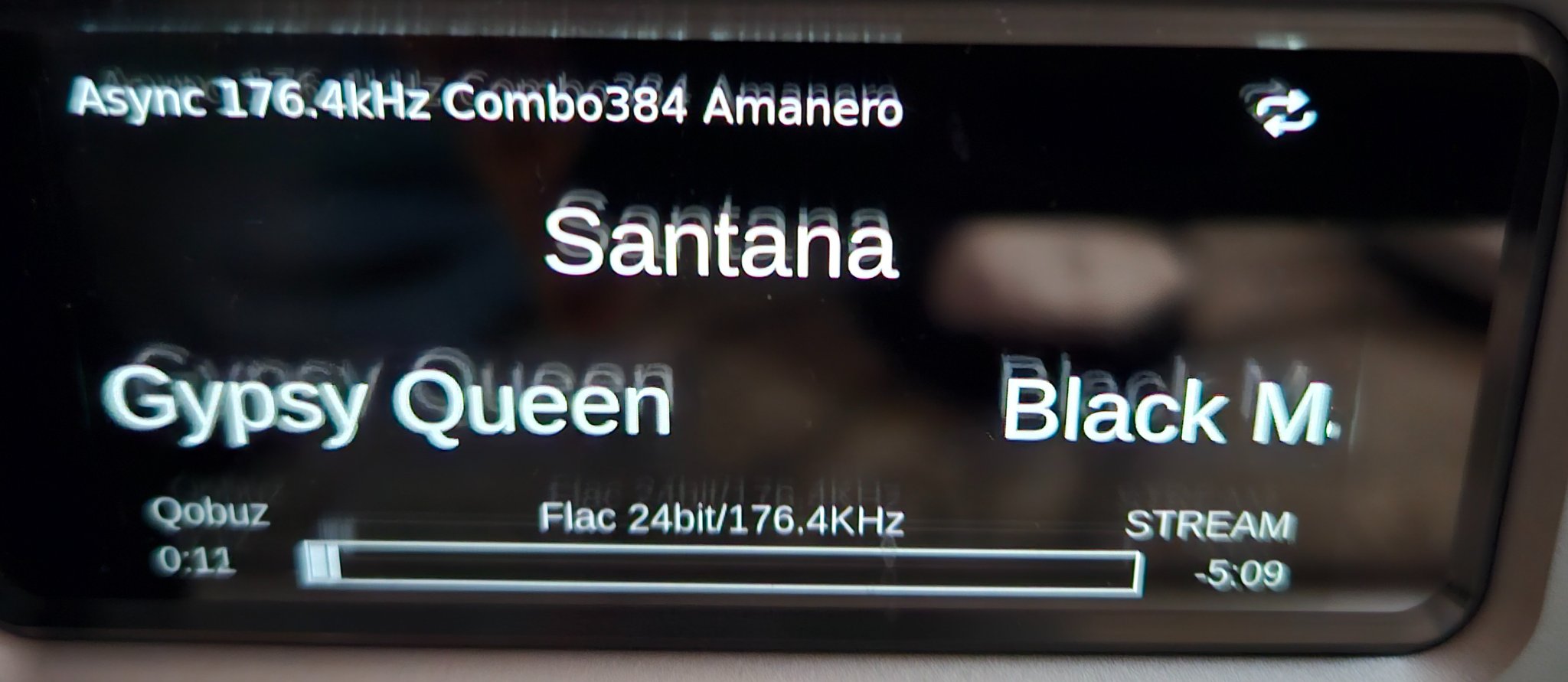

48khz is set in windows. Like I said the same is on aurender n100h which also don't have even upsampling capability. It doesn't matter what i connect even macbook my wife have gives same result. 20241230_181428.jpg
Android phone as well. I just noticed one regularity that it pops out as usb device up to 24bit 192khz and that's how it set wck which I don't understand. Screenshot_20241230_185405_Qobuz.jpg

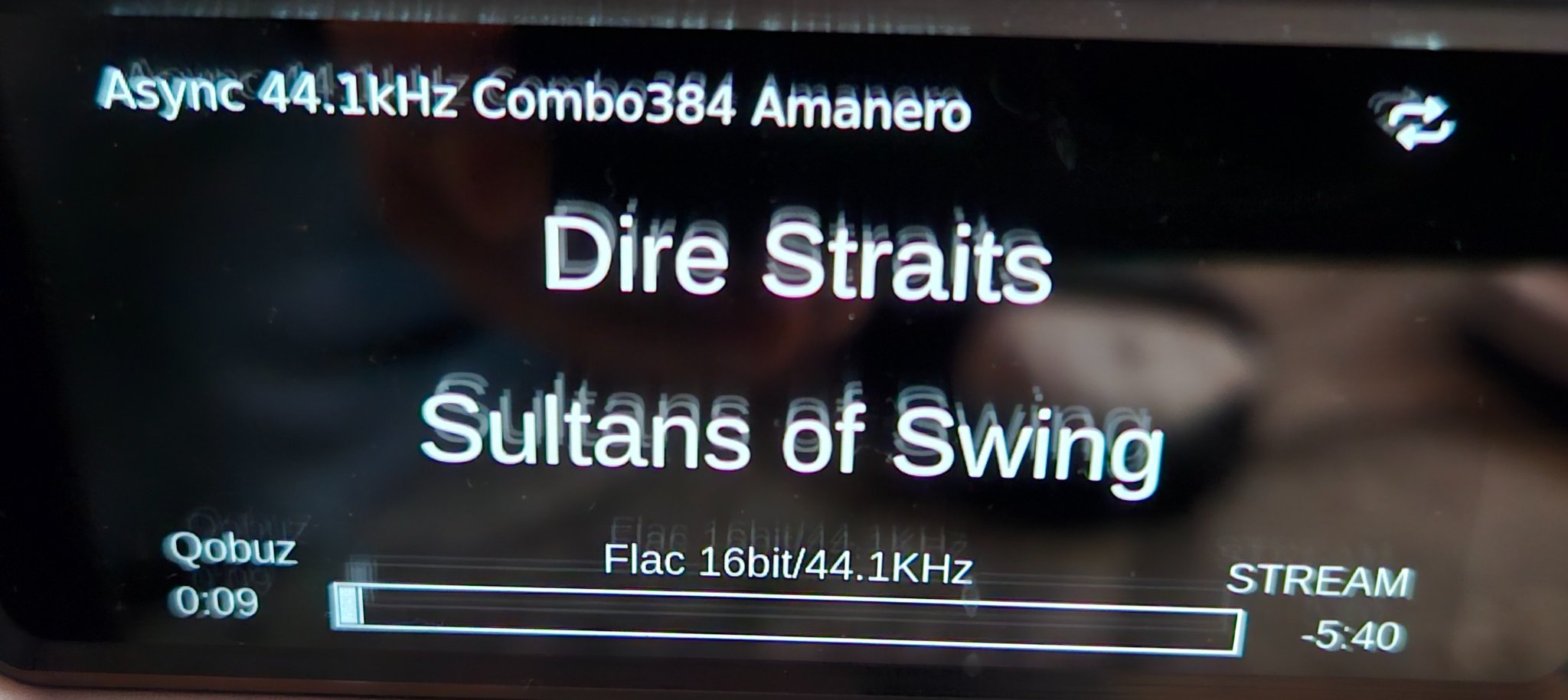

Hi Vladislav,
If you can check tomorrow setting of wck on york. As you can see on amanero whatever file i play wck is set correct and it set when file is playing. When pause no wck. While on york I have all the time 192k on wck even when file is not playing. My dac plays 192k now with 8nos filter that I installed. All files on amanero including 192k are sounding correct.

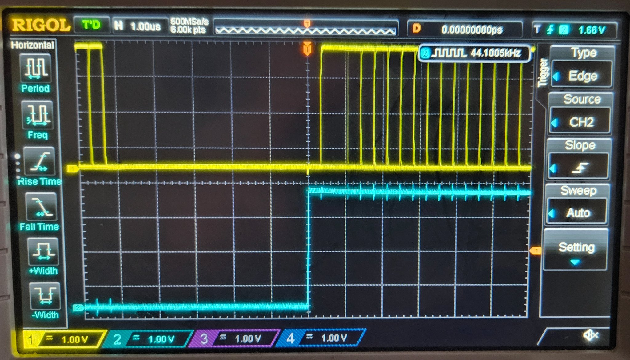

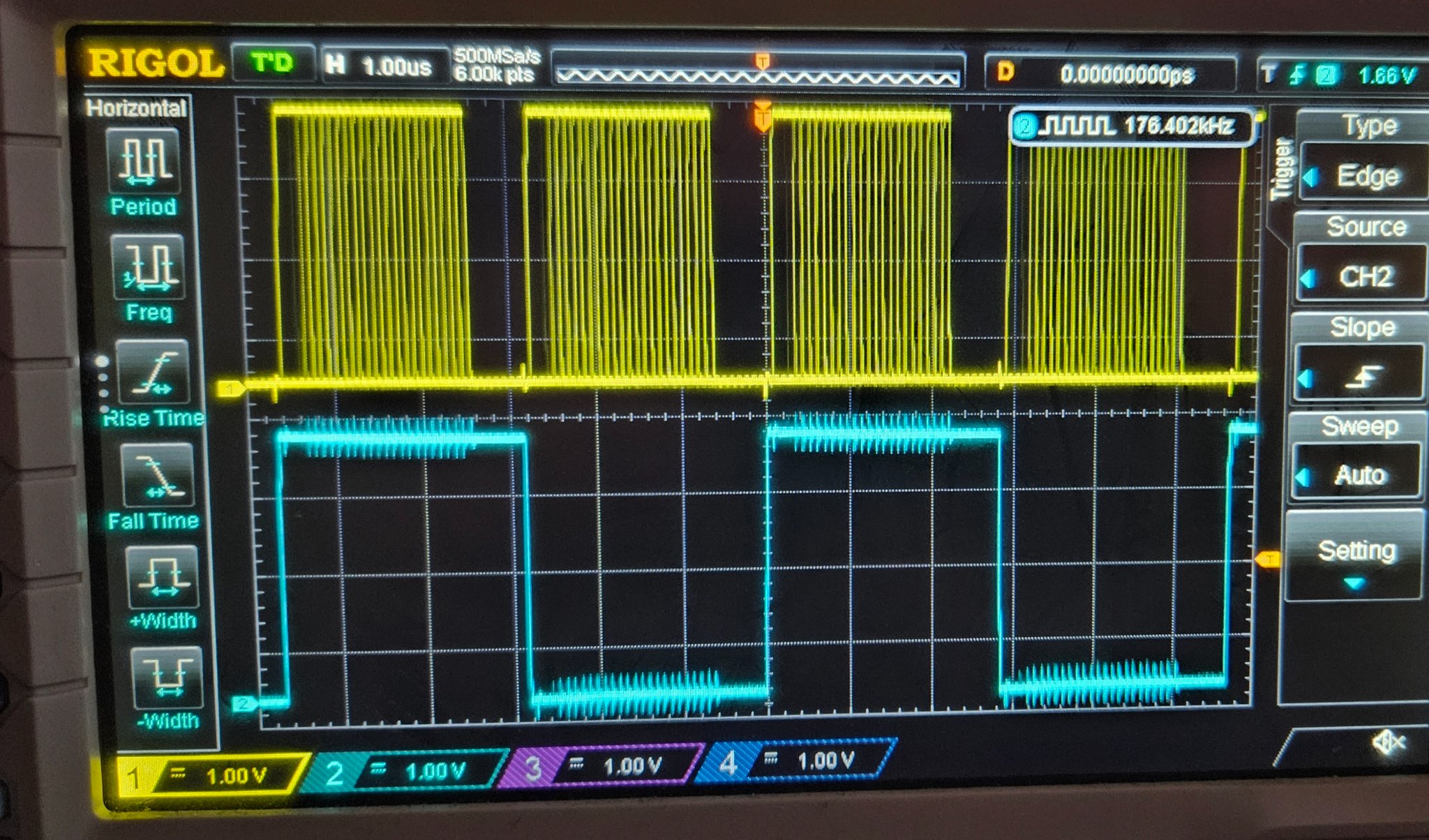

Hello Marcin,
I did quick test today:

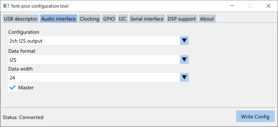

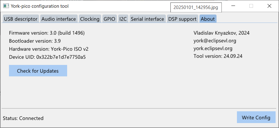

1. Updated to the same firmware version using same version of the config tool
2. Set configuration to I2S 24 bit output, on-board clocking.

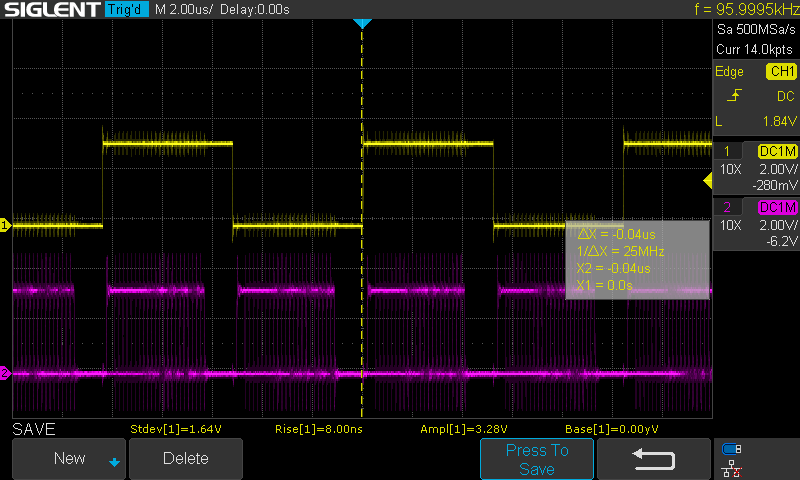

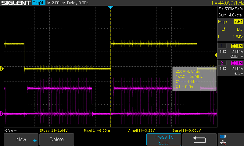

3. Tried to play audio with different sampling frequency setting in Windows, the waveforms below.
I'll do more tests tomorrow.

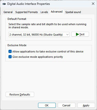

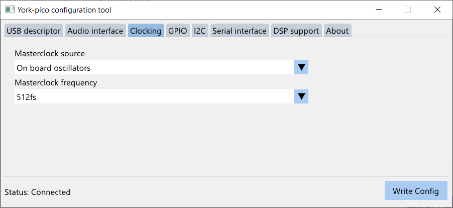

Just to double check: can you please confirm setting in this window?

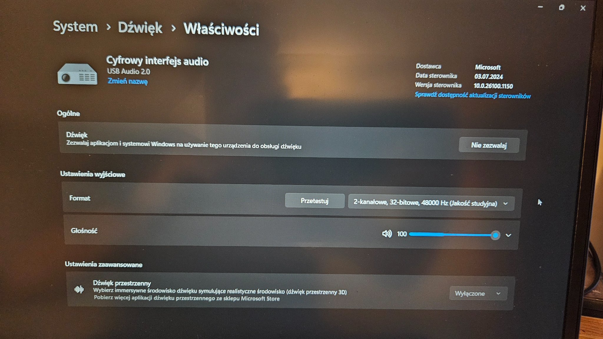

Hi Vladislav,
On mine Windows 11 is 2 channel, 32bit, 48000 Hz. Changing that doesn't change behaviour of setting WCK to 192k permanently even no sound play. And like I said it doesn't matter what I connect to it, windows PC, MAC or Android Phone. Your card set correct WCK I guess from the scope pictures. Then something must be wrong with my card.
