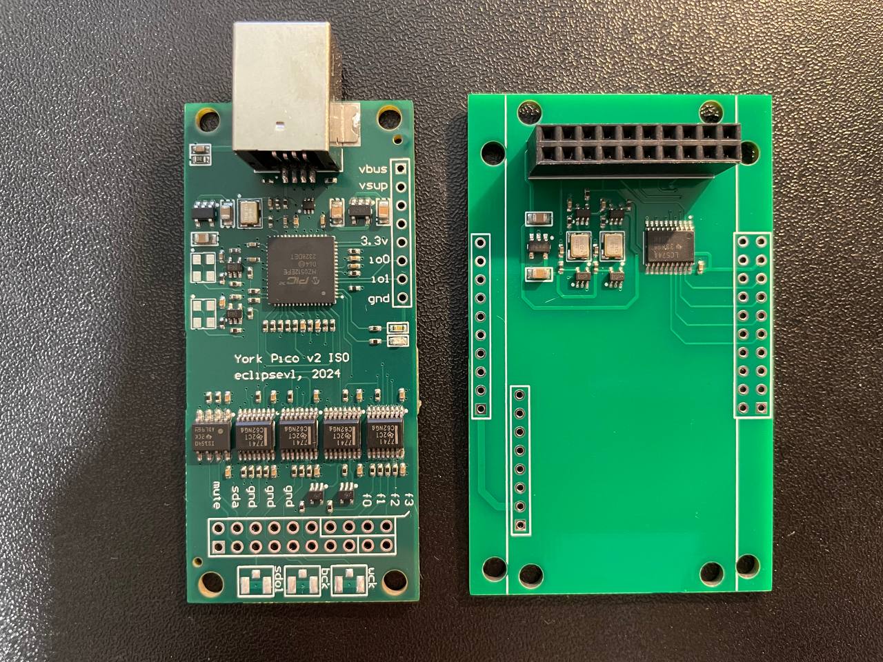

So, the isolated version is tested and the firmware for it is updated 🙂
There were also couple of things to fix in the bootloader and I still have couple of things to do to make support of now 4 different hardware options in the firmware. I've finally implemented BSPs (Board support packages).
(As an option I put pads for ufl connectors and option to provide external supply for the USB side)

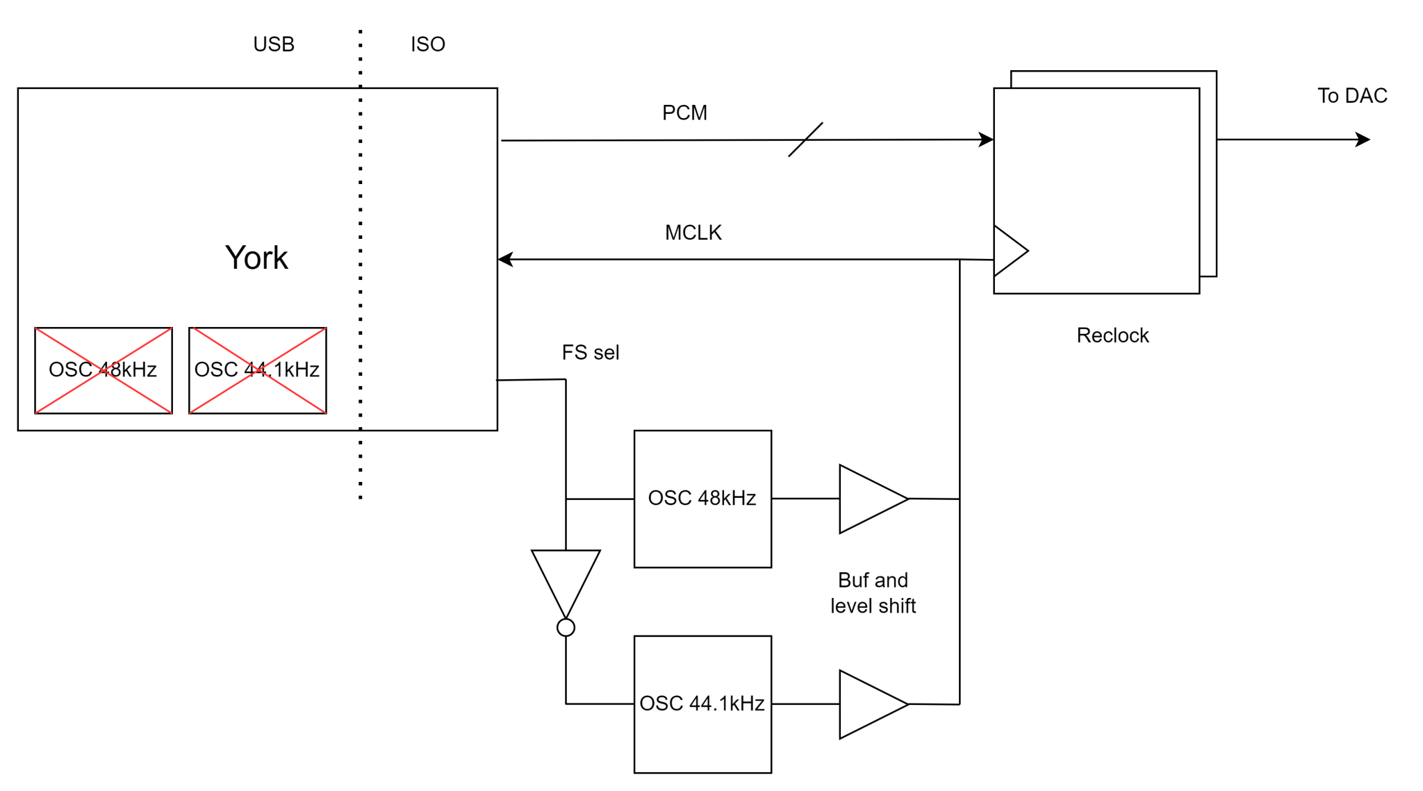

I also tested it with the reclock interposer board I posted above, everything works fine.
With that board York is configured to receive masterclock from isolated (DAC) side, on board oscillators are disabled in such case.
So it looks like this:
Use of external oscillators is not strictly necessary, the hardware supports full duplex operation on mclk line. So York can provide masterclock from the oscillators to the isolated side as well.
Such implementation of the reclock should be better than just FPGA: it uses one IC for all signals and each path has the same delays. Whereas FPGA implementation would always have slightly different delays based on how the place-and-route is done. In many DACs such reclocking scheme is used even after FPGA.
This is only important for the PCM DACs, of course.

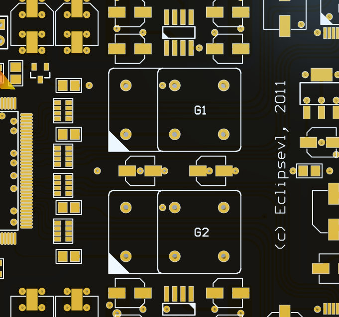

Maybe a stupid question; why not make the clocks upgradable?
Got a couple of amanero (clone)/xmos cards to test out for a new project and they all have either sockets or pads for different size clocks. Just to have some thinking fun and see where it leads to.

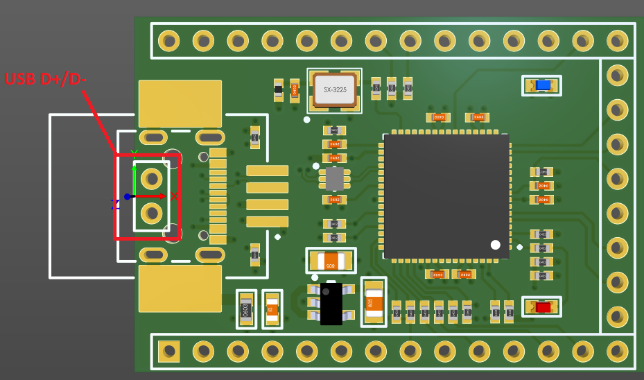

BTW like the daughter card as it looks like it changes the mounting direction; something I require for the upcoming project (internal USB connection).

Hoi 🙂
+7050/5032 etc SMD footprints. But I was in a bit of hurry to send it to production. But if you have an idea what it can look like - please let me know 🙂
For the board posted above (BTW, I'm attaching the schematic just in case someone is interested) I was thinking about something like that:Maybe a stupid question; why not make the clocks upgradable?
Then perhaps the nano version is better in that case because it has USB routed to 2.54mm header (hidden under the USB socket):BTW like the daughter card as it looks like it changes the mounting direction; something I require for the upcoming project (internal USB connection).

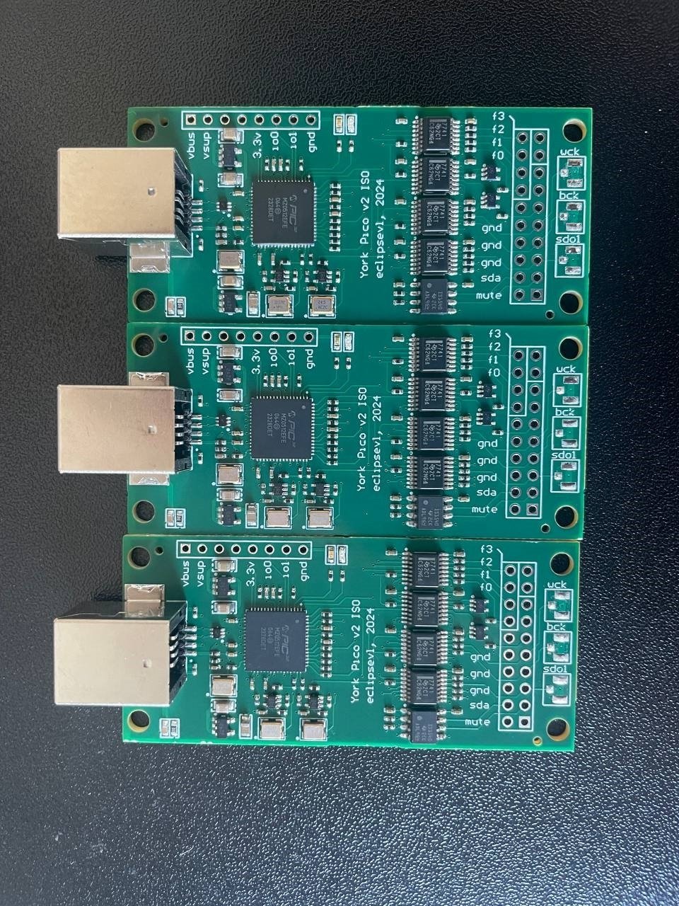

The ISO version is now available on Tindie 🙂

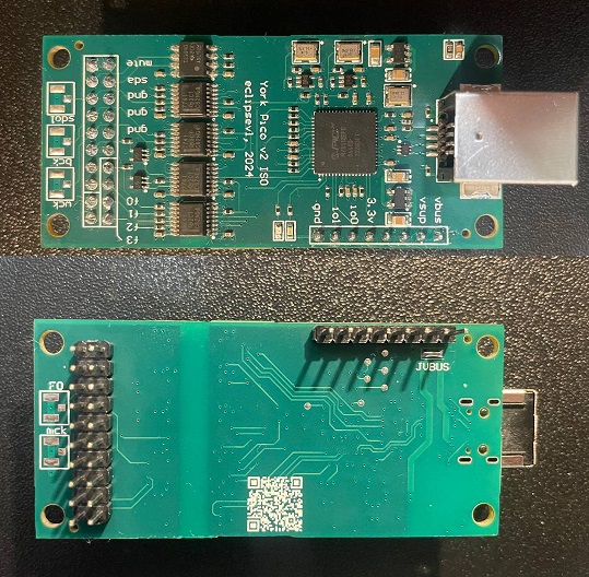

I looked through your user manual and realized that the setting up of the power supplies were not mentioned.
Can you provide some guide on how to power the USB with an external PSU, and also how to supply the 'clean side'? This clean supply is 3.3V or 5V?
Thanks.
nice boards, I have placed an order for York + reclock version. thanks.The ISO version is now available on Tindie 🙂

Have look on the back of this board and you will find jvbus. It's soldered jumper if you feed power through usb port. If you want to connect external 5v psu you need to desolder this jumper and connect psu to vsup pin.Hi @eclipsevl,

Clean side should be supplied with 3.3v.

My question is can we replace these oscillator on reclock board with let say NDK NZ2520SDA?
If I want to use external master clock what parameters should that be? My dac don't provide mclk.
if I understand correctly without mclk fed from dac or external clock I need to set clocking from on board oscillators or PLL and then it will generate mclk that will go through recklock board? That way I can use outputs from reclock board to feed 2ch i2s to df1704 or 2ch nos?

That is correct.Have look on the back of this board and you will find jvbus. It's soldered jumper if you feed power through usb port. If you want to connect external 5v psu you need to desolder this jumper and connect psu to vsup pin.
actually 3.3 to 5.0v, the isolation ICs allow that.Clean side should be supplied with 3.3v.
The board is designed for oscillators in 3225 package but I think it will be possible to solder 2520 as well. I'll check.My question is can we replace these oscillator on reclock board with let say NDK NZ2520SDA?
Let me add more details in the manual regarding that.If I want to use external master clock what parameters should that be? My dac don't provide mclk.

Yes, it is possible to solder this oscillator (2520 package).My question is can we replace these oscillator on reclock board with let say NDK NZ2520SDA?
