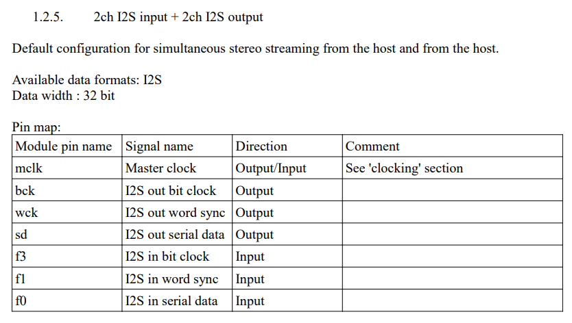

Can you share the new firmware? I found a September 24th version with the original link but now it doesn't seem to be there. I did try that Sept 24 driver when it was there but still had the driver error when I2S input was selected. I have tried it with an ADAU1467 board SDATA output connected as I2S input to the York so the ADAU generates all of the signals - BCLK, WS and SD but the York board still has the driver error.

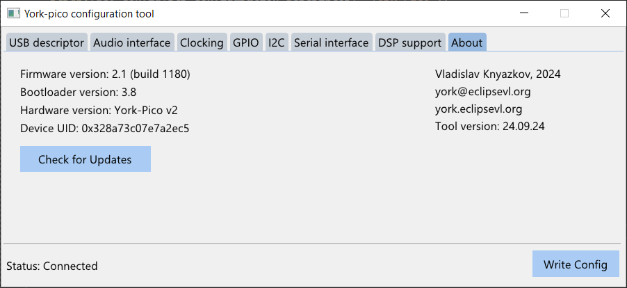

It is published, to update module please open config tool, go to 'about' tab and click 'check for updates':
(you need internet connection)
After update firmware version should be 2.1 (build 1180) - this is the latest published, which has fix I mentioned.
I'll send you PM with relevant document and instructions regarding that.

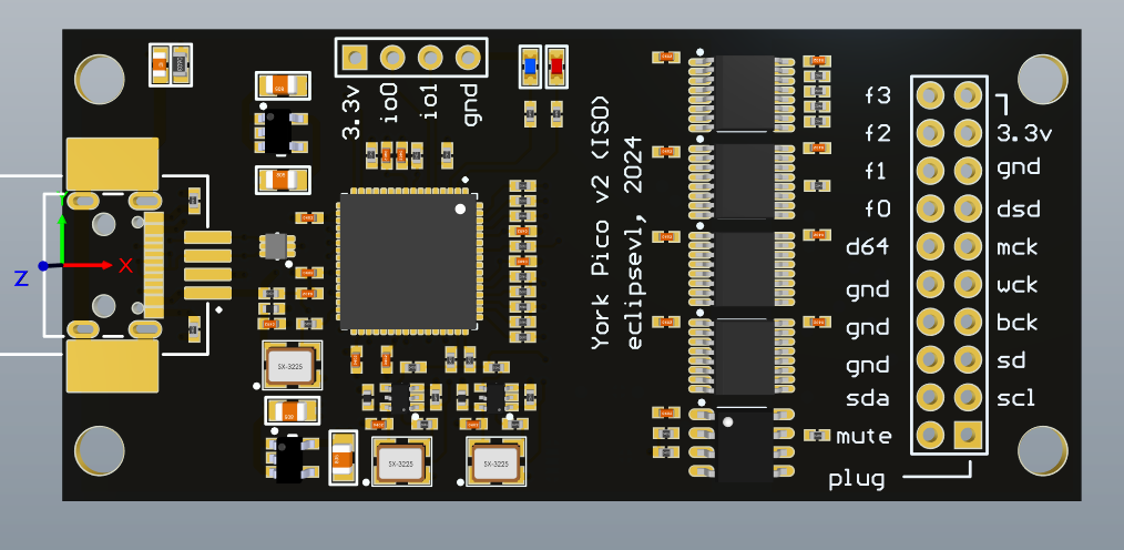

Couple of times I've got comments that this module lacks isolation. Perhaps it's time to fix it 🙂
It is not final. I've included HW to to support as many output configurations as possible including aux signals (plug, mute, dsd etc) as well as isolation of the I2C bus. Both external or onboard master clock are supported.
The "3.3v" on 20 pin header became input in this case, to supply isolated side. Actually it can be 3.3-5.5V.
Presence of this supply can be detected and used to enable MCU's USB.
You certainly have my interests now.
Is it possible to provision for an option for external 5V supply for the USB side?
Good point. Yes, definitely, I just need to think where to put the connector.

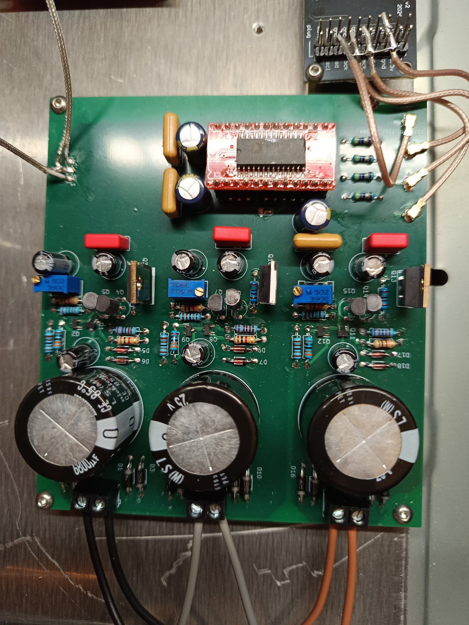

I've been using Pico York for a few days with my AD1865 DAC
Everything works great!
A few comments:
The additional PCB for the u-FL is a great idea
It would be good to think about an external power supplyUSB power supply from a computer is not state of the art
Other than that - great device
Thank you and I highly recommend it!

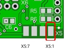

One of the configurations I noticed wasn't under tested was non-TDM I2S output, I2S Input at the same time. Would this be a setup that could function?
For example. PCM1808 2ch input, 2x PCM5102 output for 4ch.
Indeed, currently there is no such option, I only have 2 ch in + 2 ch out and 4ch output separatly.
I think it is possible to do, there is still one pin (F2) available to output one more I2S data line:
