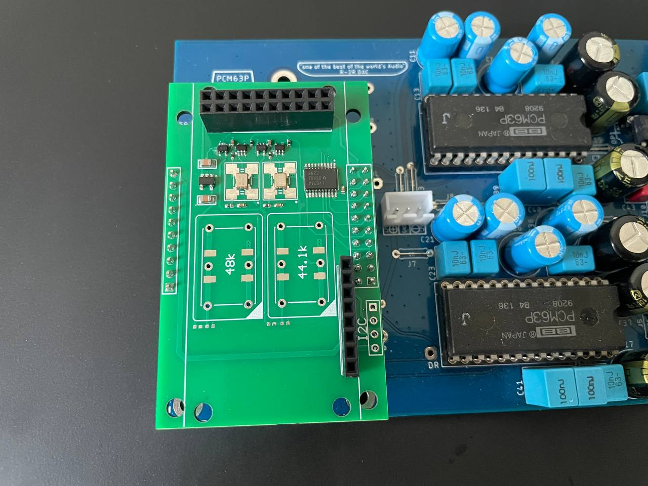

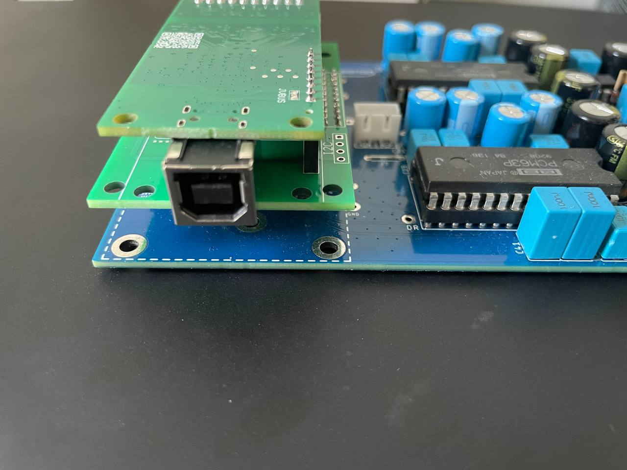

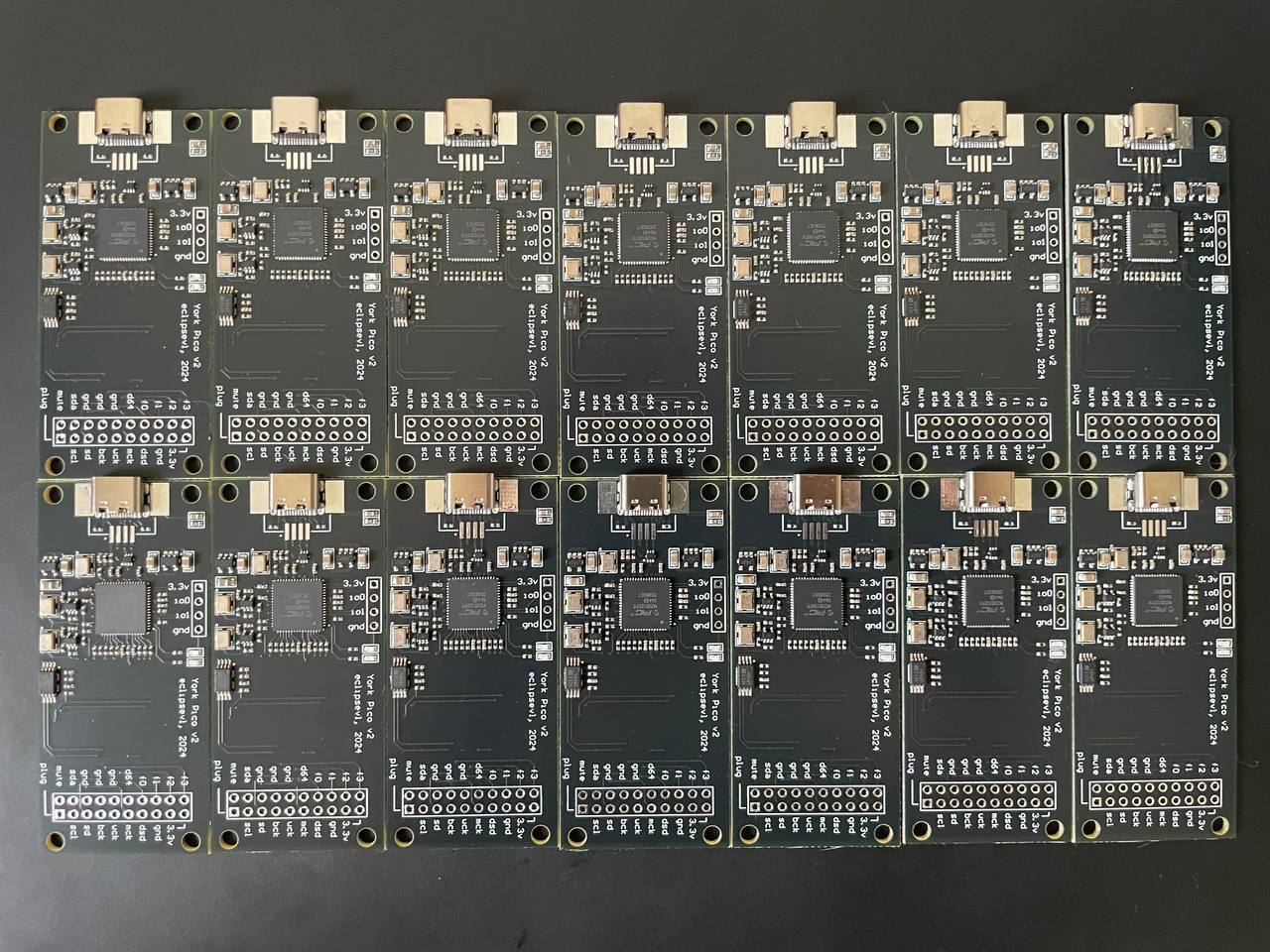

An update on the hardware:
1. I've got new batch of Pico v2 version so it back in stock:
2. I've also ordered batch of nano (or mini 🙂 ) version. It is still not fully released yet, I would need to work on documentation. So in next couple of weeks it will be available in the tindie store as well.
3. New version of reclock board

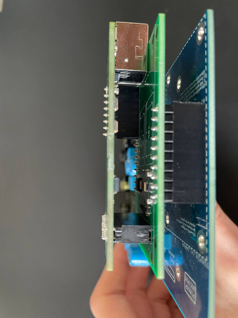

Based on feedback for the first version, I've added more footprints for oscillators:
Another update is that York is flipped now so that total heigth of DAC-Reclock-York is not that high:
And there is enough space for any clocks:

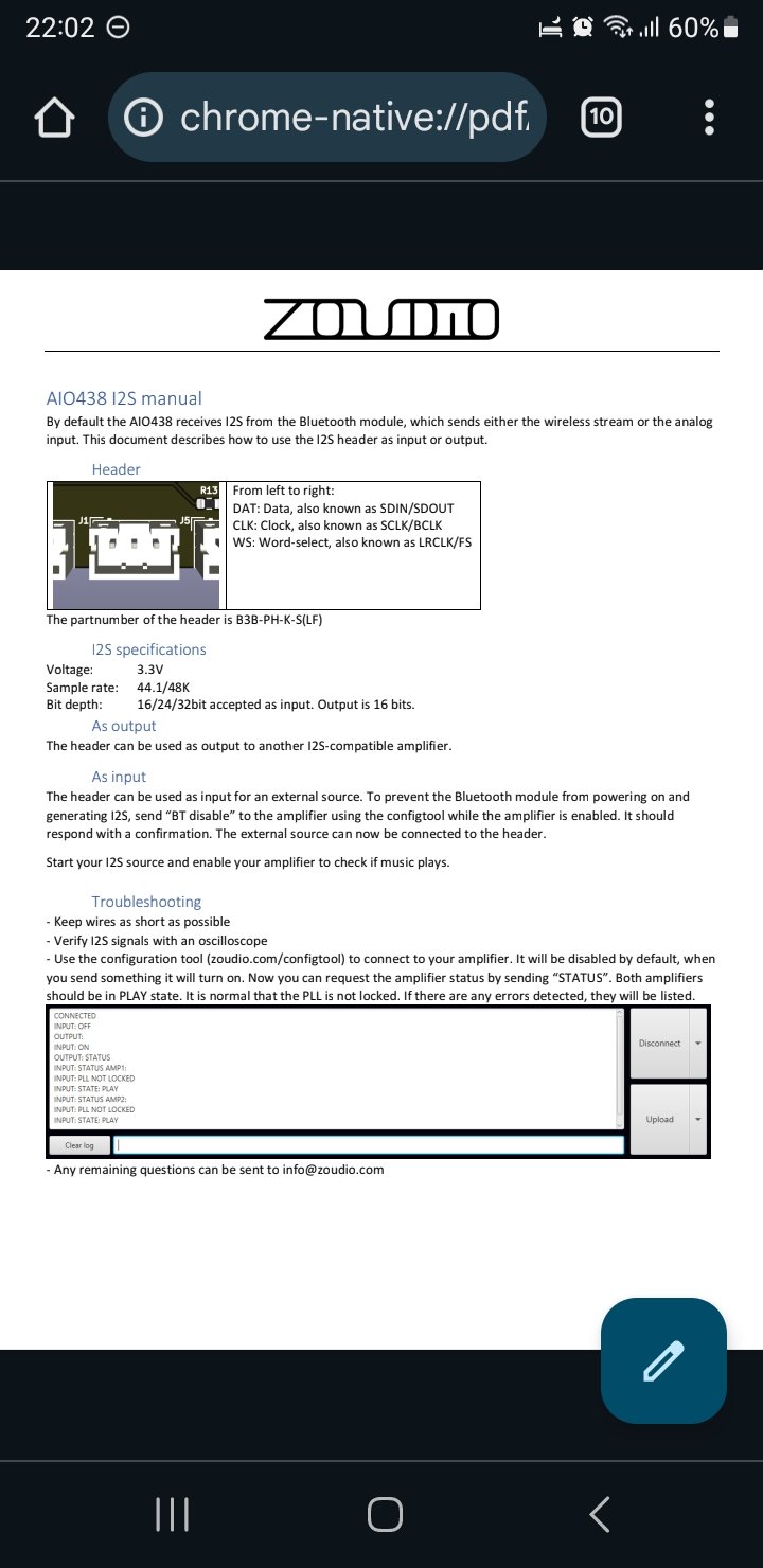

I think this device are just what I'm looking for. Can anyone confirm that I can do as following:
Connect this device as an bridge between:
HTPC running Ubunto on USB
Feed two Zoudio amps
with I2S 48kHz 24-bit?
https://zoudio.com/product/aio438/

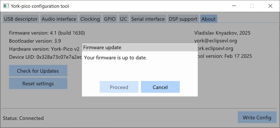

Updates on the project:
1. I launched a very basic webpage finally.
It took just one evening to make it so a long overdue. But now the docs, config tool and some updates of the firmware will be available in one place. Welcome!
http://york.eclipsevl.org
2. The config tool now really checks the firmware version:
3. In a new config tool it is now possible to change not only name and vid/pid but also manufacturer and serial ID string of the descriptor.
Also it is possible to specify the terminal type. It changes how the interface is seen in the os:
On the firmware updates:
Biggest one is the fix of device enumeration with iPhones. Now York is iPhone compatible.
