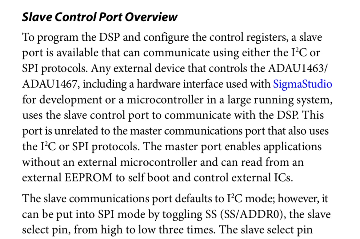

Hi @trungdtmc
It same as for adau1452, it can use both SPI and I2C but the default protocol is I2C. Here is screenshot from the datasheet:

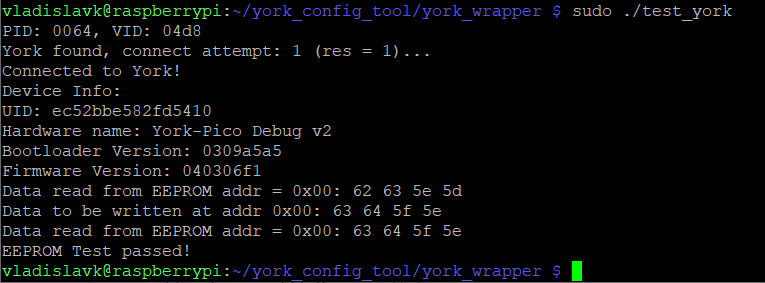

One of the missing parts for the cross-platform operation is the config tool: now it only runs under Windows.
Recently I did a lot of code clean up in the config tool to separate OS-dependent stuff from the rest.
With that, now the tool also becoming cross-platform.
Along with that, I am going to make some of the HID API public and provide code examples to do i2c/gpio transactions:

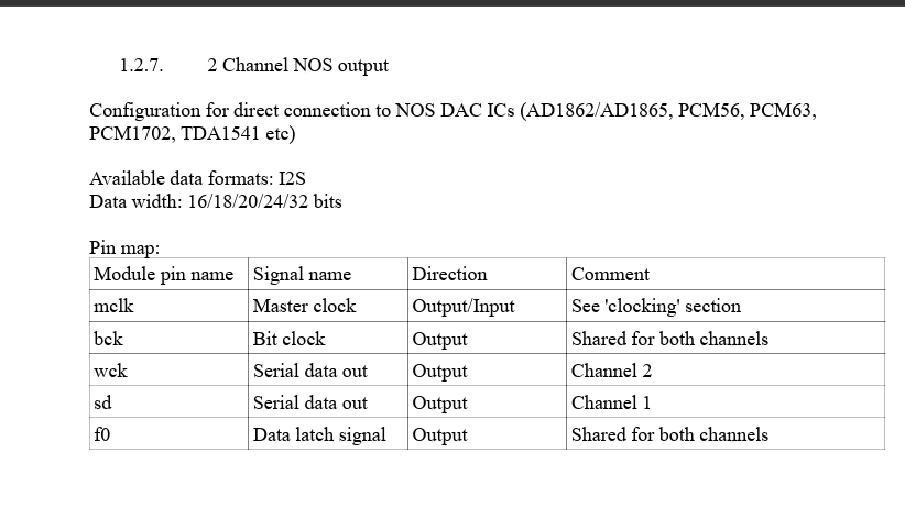

Hi
Does York Pico support TDA1541 in simultaneous mode?
It is stated in the manual it does support.. Maybe I am missing something. I will try again when i have the time.
But I am aware that JLSounds has a specific configuration just for TDA1541, and the CPLD by Miro also has a specific program written for the TDA1541, on top of the usual 16 bit ones for the other DAC like PCM56, AD1851, AD1856. It could be because the TDA1541 requires data to be in offset binary , vs the two complements of the other 16-bit DAC chips.

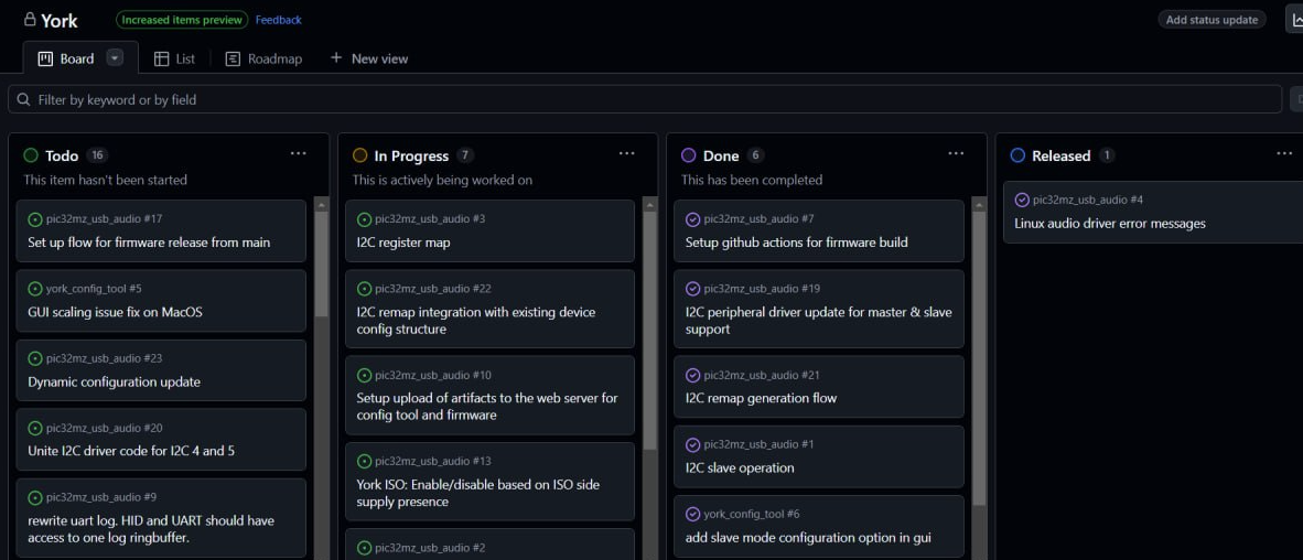

In the past couple of weeks I was thinking about introduction of some kind of firmware release procedures and overall task tracking.
For source code control I used git but not really. For a long time everything was done in one branch and commit frequency wasn't great.
In next couple of days I'll write a post about the new firmware release procedure and how the development is organized now.
Github also has functionality for issue tracking so I added one. Here is how it looked after one week 🙂
