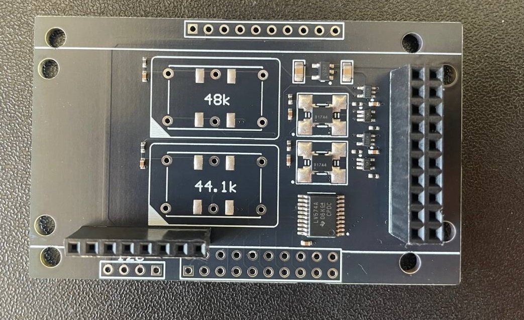

Just a quick question, could an isolated version of York with a relocking board be used in the 2ch in, 4ch out mode?
More specifically how would the 2ch i2s input be delt with in this hardware configuration
Hello,Hi eclipsevl
The reclock board is designed just for 2ch I2S/PCM output, and the ISO version I2S input port can only work as master (because of the on-directional isolators).
So I would say it is not the right choice. It would be better to use non-isolated version and add isolation and clocks on another board to meet requirements of your project.
The ISO board may still work however with some restrictions:More specifically how would the 2ch i2s input be delt with in this hardware configuration
1. Both In and Out I2S ports must be masters
2. Sampling frequency of input and output must be set to same value (both 48kHz or 192kHz, for example. 44.1 and 48 would not work)

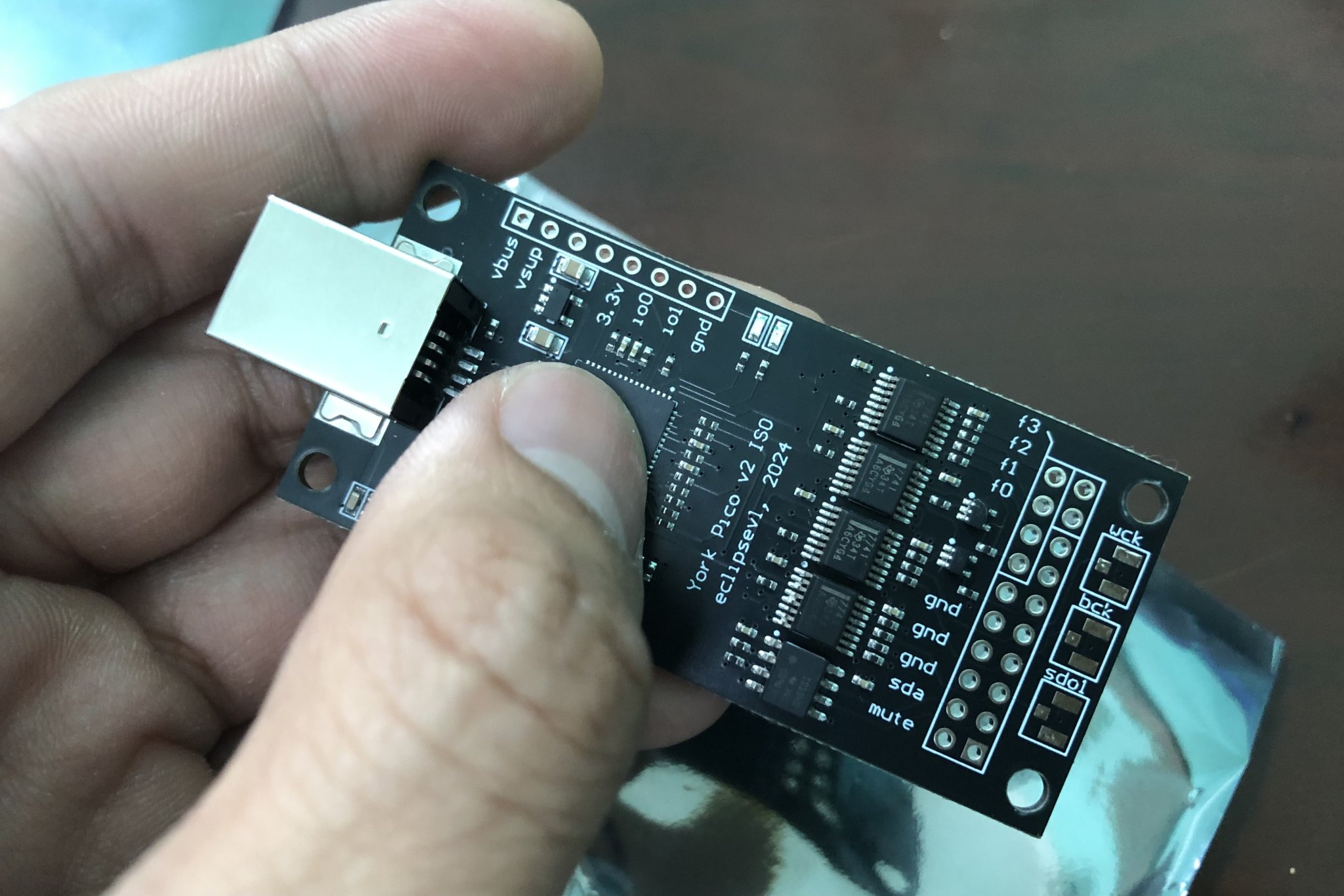

😱 2 months at Vietnam customsAfter almost 3 months, it finally arrived 😂
That is crazy.24/03/2025 08:39:30
Item presented to import Customs/Security (VNHANA)
30/05/2025 08:18:38
Item returned to Import Customs (VNHANA)
The ISO version is out of stock, I am expecting new batch in 2 weeks.
Pico USB-C/USB-B and Nano versions are available.

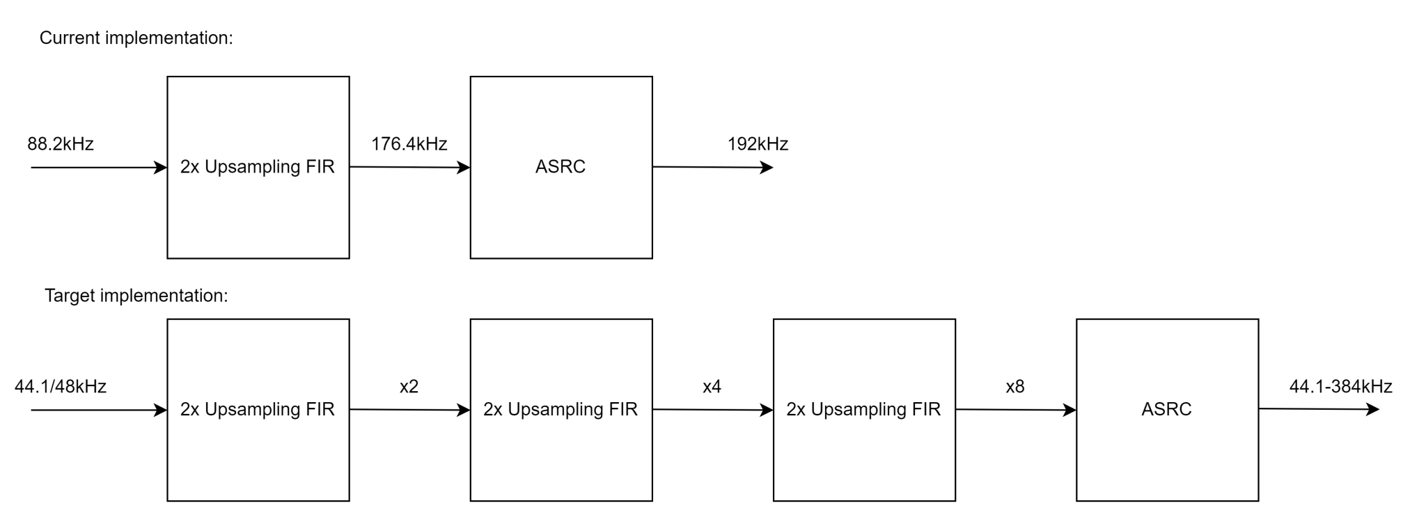

A quick update on the DSP features.
I have made a first ASRC implementation for York. Of course York can just use external clock but in some cases ASRC still may be required. For example, if one needs to input I2S stream into PC and do not worry with matching the sample rate in Windows settings - ASRC would handle that. Another case is simultaneous input and output of audio from/to PC. Or to stream 44.1k/48k content from PC if only one masterclock frequency is available.
This is first implementation which is a bit simplified from the target, thus has a bit higher THD.
Especially at high frequencies.

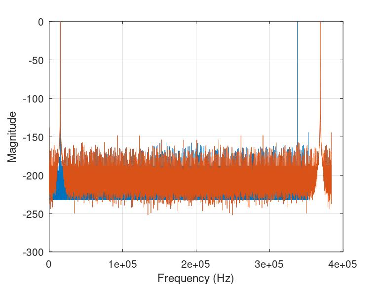

Simulation of current ASRC implementation at 15kHz 0dB input tone:
Blue is the input at 352.4kHz, orange - oversampled to 384kHz.
There are many harmonics up to ~-113dB level.
Simulation of target model:
The THD is much lower, harmonics are below -148dB.

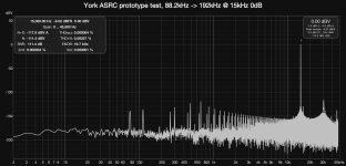

And the test with real hardware with oversampling from 88.2kHz to 192kHz.
The 30kHz harmonic level matches well at around -115dB. 15 kHz is close to the worst case for this implementation. In comparison, this is how 1.5kHz looks like:
With that it may be possible to add S/PDIF input as well. Not sure at this moment but I may try in the future.
