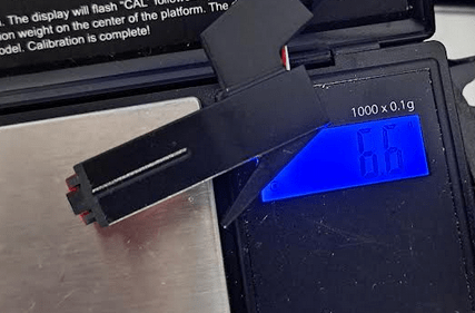

The record arrived earlier than I expected, it was supposed to arrive on the 14th of June, but with a knock on the door I received a thin, rectagular package that left no doubt that it was a record.
The vinyl was in very good condition for what I paid for it, around $10 including shipping off a vendor on Ebay. I placed it on the turntable, and, without adjustment, promptly placed in on the wrong track, I had chosen track 4 on side B as the sacrificial track, so I quickly changed to that.
The song came out through the onboard speaker, clear, if not loud. Next were the headphones plugged in to the line out port.
All expectations were fulfilled in a few seconds of listening. The sound was equal on both channels, and full. Details I had never heard since I first listened to the CrO2 cassette in 1984 on my 'personal stereo' with headphones and on the home Hi-Fi system, details came to light. The sound of the vinyl, I would not call it warm but 'fluid' flowed out through the device. I wasted no time in using the on board USB recording function. Once again, the unit did not disappoint. Initially, the sound levels were very low, but with the 'normalization' on Audacity, everything was set right.
Wow and flutter was inaudible to me, and the particular track I played had a natural wow to it, a pitch change that seemed about right. Quickly placing my phone on a roll of tape and the turntable, hurriedly a little off centre, netted the result of 33 and 34 rpm, with 0.22% . This had been my main concern.
How was it possible, then, that a decades old format, played over a $34 player which is your worst nightmare, could sound so good? I could only imagine what awaited me with the proper equipment and upgraded speakers. The quality of sound that I heard on YouTube was suddenly confirmed beyond all doubt in front of my very eyes.
I am now in a quandry: do I play the thing once, and only once, and get the sounds in an mp3 (which, by the way, sounds very very good - for an mp3) or do I shelve the record and wait for a few months for a gentler stylus to preserve my records? I think I will run the record once, and record it. A few records of lower quality will be just fine for the next process - getting good music and converting it.
I have requested a relative to repair and ship the JVC turntable that was promised to me, so things are looking up.
The whole point of the exercise was to find out if vinyl was worthwhile, right now it seems to be the only thing that is.

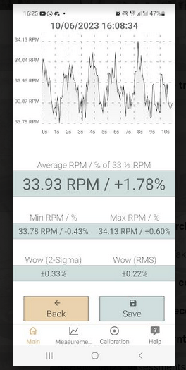

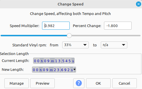

Around 1% speed error is considered maximum before pitch error can be detected, e.g., 0.33 at the 33 RPM setting.
I can detect the pitch change between the two speeds, thanks to Audacity, and thanks again to Audacity I can fix that.
I cannot detect any wow and flutter, so leave that as it is. The speed adjustments screw was not accessible with the screwdriver I have.

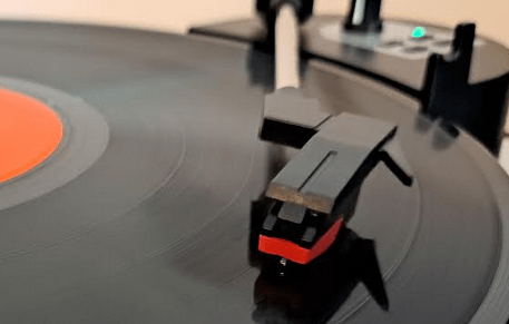

Problems with skipping
Initial testing on track 4 side B showed no skipping at all, but after my cleaning and wiping attempt, there is quite a bit of skipping on almost all tracks.
The record is a little warped to begin with, and the type of turntable I have could be responsible. I never encountered this much skipping on any turntable I used in the past, including the Yorx all in one unit.
Let me see if I can trace this fault. If all that is needed is a better record or turntable, that will be fixed soon enough.

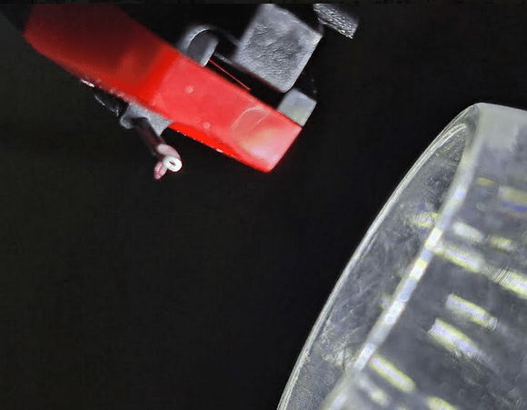

Skipping much less after stylus inspection and cleaning with a sponge.

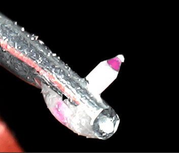

Before and after: (USB microscope). Looks like they were right about taking cleaning seriously.
Again, stylus has picked up dirt, which may have been the reason for skipping on last track. Dirty just visible in mobile phone blurry photo.
Stylus brush is all I need? Magic eraser? Sponge? By the way that 'dirty stylus' in the picture is much worse.

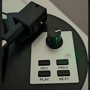

Recording is simple: attach an USB drive to the USB port, turn the volume knob to power on, and place the stylus on the record.
Next, press the REC button briefly until the green LED starts flashing ( the LED is off in the picture, in between flashes), and the music will be recorded to a folder named TAPEMP3 that the hardware creates on its own, and saves the first file as FV0001.mp3, each subsequent file being named 0002 and so on.

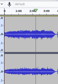

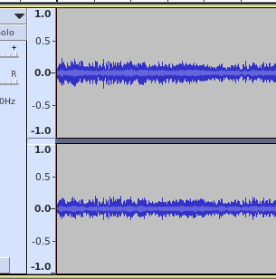

Recording quality is good, even on both channels, and very close to the direct output from the LINE OUT to headphones.
When processing the files, should I normalize or amplify or something else.
I notice the signal does not seem to be the same strength on L and R channels, however, sound with my HP laptop from 2015 and Sony labelled headphones, sound is very clear, fluid, and pleasant. I have been listening to this album on tape since 1984, and I still have the tape that is in very bad condition now. The quality of sound is better than I ever heard on tape (personal stereo), and as for the playback on the home Hi-Fi rack system, a Technics, we did not pay any attention to details too much, just wanted it loud. Sound quality was good, as far as I remember, a good tape deck can do wonders.

The different L and R strength is probably related to the album's production, at least, that's the issue on many of my conversions. I use the Normalise Audacity setting, which increases the source gain by a set same amount, i.e. the instruments/vocals maintain their relative loudness. I've used this tool many times, even on new CDs where the transfer level is very low.I notice the signal does not seem to be the same strength on L and R channels, however, sound with my HP laptop from 2015 and Sony labelled headphones, sound is very clear, fluid, and pleasant. I have been listening to this album on tape since 1984, and I still have the tape that is in very bad condition now. The quality of sound is better than I ever heard on tape (personal stereo), and as for the playback on the home Hi-Fi rack system, a Technics, we did not pay any attention to details too much, just wanted it loud. Sound quality was good, as far as I remember, a good tape deck can do wonders.
Geoff
I used normalize and I used amplify, the question is whether there is any advantage since amplify will push the signal past the peaks, but sound louder than the normalize setting does. What about 'Loudness Normalization?'
Just checking: compression ( a moderate amount ) can it be of any use in this situation?
I've never used the compression or amplify functions, I assume that Normalise will give me what I want in terms of gain and dynamic range; also, I don't let the signal go over the peaks

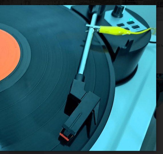

Skipping problem solved (partly).
I guessed that the skipping on some tracks could be fixed by decreasing the anti-skating force. There was no way to adjust this on the EZcap, however I had an idea: what if I attached a weight to the tone arm and slung it over the side of the player? That worked, and the sound quality was not affected. I played through one complete track without skipping. This means this player can be used to transfer records to mp3 even if they are damaged, if someone wants to use this thing anyway, to get started in vinyl. The effect may be due to an increase in tracking force of about 1.4 g, I can reduce the weight of the tether by using fishing line, for example.
It seems like it is record damage, since some tracks play without skipping, and the same repeated section of the song does not cause skipping every time, for example, if there was too much bass.
Apparently the suspended weight anti-skating system is used on some brand name turntables.

I should mention that this is not a permanent solution. I will be getting this record onto mp3 and .wav, and then purchasing a few more records that are in G+ condition, and try to convert some of my older, scratched records.

The anti-skating system I created works fine. Track 1 on side 2 skipped, so I added one more paper clip. Each paper clip weighs 0.4g
Now to 'process' the recording and change the speed of the recording to match 33.33. Will track times help, I wonder.
Audacity was used to slow down the speed of the song. The turntable rpm app suggested that the turntable was turning at 33.93 rpm which needed a correction factor of 0.982 to get it down to 33.31. A song that was listed at 5:07 now played for 5:12 seconds, that is 307 seconds vs 312 seconds, an increase of 1.6 %, which is close to the readout on the rpm app. The entire side, (almost) however, was originally 18 minutes, 54.341 seconds was stretched to 19 minutes, 15.134 seconds, an increase of 1134.341 1155.34 of 1.85%.
