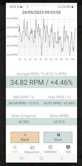

I suspected that the phone had to be placed at the exact center of the turntable, and according to the instructions this was the case. I was able to record the marginal values of 0.2 % which is typical for run of the mill cassettes, and detectable under certain conditions. This site says .20% is OK.
Again, you’ve probably selected a good turntable if it has a wow and flutter under the .25 percent range. The idea, for most, is to purchase a turntable which won’t produce any distortion. Today, some high-quality turntable models have wow and flutter ratings below the .10 percent mark.

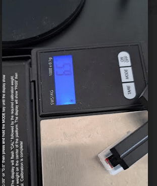

When looking at this unit and the reviews I was concerned about tracking force, and if it would destroy records. Some reviewers say that no, it will not. This remains to be seen. Anti skating is a matter of conjecture, and I see no tracking force spring or weight.
Tracking force is a high 6.5 g at about the level of a turntable. I tried playing back an mp3 file from an USB, however there was no output. It may be that the mp3 recorded from the Ezcap are named music01.mp3 and the like, so maybe it was looking for that type of name. No output from the speaker or line out at all, though the turn on click came through.

View attachment 1177941View attachment 1177942
See that transparent plastic stylus guard? You need to remove it before measuring, or it will be included in the VTF-measurement.

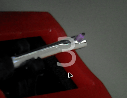

The tone arm swivels freely in the up and down direction, however does not make more than one swing from side to side, when the device is held vertically, and the tone arm given a short push. The stylus or cartridge or both seem to be tilted to the right, when seen from the front.

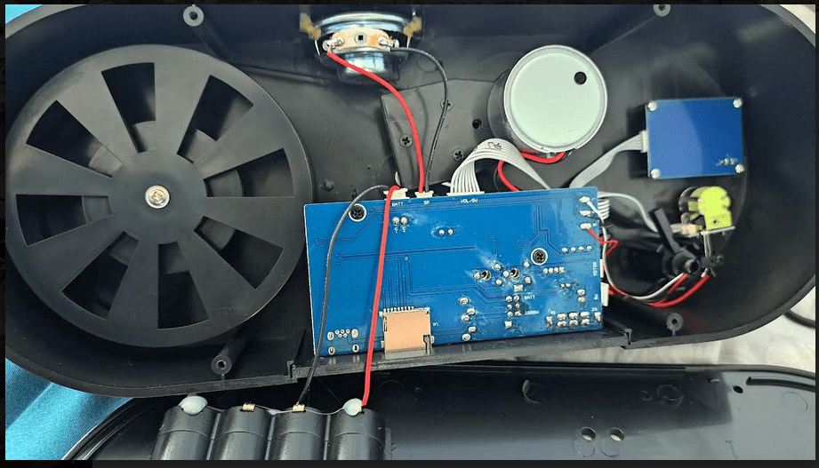

I suppose it is a good time to take it apart.
Internals. It has a nice little motor, and the belt is in place. The platter has something like a screw at the bottom of its plastic structure, and it does not look like a real bearing. There is an neat switch that activates when the arm moves all the way to the middle, that must be auto stop. The motor is held in place with some sort of bracket and then some screws. The board at the bottom houses the USB ports, and the AD converter, and two speed adjustments screws. The right side board host the play and record and other switches. The green thing is the bottom of the volume control.
That's honestly just a toy. Its nothing more than a novelty and no way it will produce any results which are respectable enough to be designated as "hifi", but rather just a crude implement for vinyl torture. In all seriousness this is just a garbage plastic POS. I wouldn't even call that a turntable of any sorts. If you're 80 yrs old and can't hear well anymore, its probably good enough, but as a means to actually enjoy music, its just a pitiful joke.

BTW, tracking force itself isn't the actual killer here. It's the mistracking which occurs with sibilance and lack of antiskate compensation. A properly set up and aligned stylus even at 5g VTF won't introduce much appreciable wear if the record surface is kept clean and the stylus itself hasn't been damaged or (even worse) worn out unevenly.
