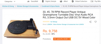

This one looks good. Are my records in good condition? Well no, some of them are not, and it is a case of recovering what I can.
Think of it as data recovery for vinyl disks. I hope my player wont get damaged.
From the article, the wear after 100 plays is acceptable, and I will be doing 2 plays max per record, then convert to digital format.
Considering this one:
List price of about $ 130, reduced to $50 (US Dollars) equivalent. Of course there are used ones around but I am very reluctant to try my luck on those. Let's see.

Perhaps the previous posters didn't make it clear (although they surely tried). A cheap turntable will wreck your records. Wreck. The cheapest half-reasonable cartridge costs about $60. You can probably buy a reasonable RIAA pre-amplifier for $100. You can probably buy a reasonable (not good, but reasonable) ADC for $100. So that's $260 and you haven't even bought a turntable with arm yet. There are plenty of old turntables available, although unless they've been in regular use until recently, they will have issues (perished rubber parts such as belts, dried up oil). People tend to store such things in the roof space - a place where it gets extremely hot in summer and cold and damp in winter.
To sum up, digitising LPs is expensive. Doing it well is seriously expensive. Far better to replace the LPs with CDs bought at car boot sales. But perhaps you have some LPs that never made it onto CD? In which case, they have significant value. Probably each one is worth more than the $50 you are contemplating spending on USB junk.
I hope this is clear. Either do the job properly, or not at all. And since it will cost so much to do the job properly, it's probably not worth doing. Sorry, but that's the truth of the matter.
