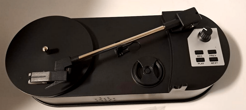

I went ahead an bought one, and it has arrived. I have also ordered a record to test.
I do not run through my entire record collection with a $34 USB 'turtable' such as the Ezcap 613.
What I plan to do is to test the quality of the conversion of vinyl to digital, using the most inexpensive equipment available. (By the way, the above model was the only one that shipped here, and I was in a hurry). If the quality is comparable to my existing conversions, then I may just proceed to purchase a turntable that will not damage my records, or repair an existing one. It can only get better.
I will not play the entire record either, but run through the one track I do not like, and check if there is any change in audio quality. I have some damaged records at home that I will get down and try to convert those. Those records are not in good shape and cannot be transferred properly although it has been tried.
I want to answer the following questions:
1. Will the player damage my records, and how bad will it be after 100 plays?
2. What is the tracking force used?
3. What is the sound quality of the mp3 conversion, and can equalizer settings help?
4. What is the sound quality if an transfer through RCA cable is performed?
These questions can only be answered by testing. If all goes well, I will be looking for a decent turntable that will not damage my records. I need to know before I get my records down and start purchasing online and on location. Vinyl seems to sound better, from my informal tests and listening to converted CDs that I have. Standard CDs sound a little distorted in the high end, but this needs further testing.

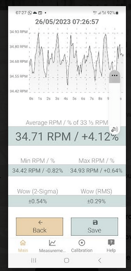

I still do not have my record, so I started testing what I could. Powered on with the USB cable and an USB charger, the platter turned smoothly it seemed, with a classy green LED indicating the power state of the unit. I searched for and downloaded the best wow and flutter app I could find. Would my phone be too heavy to place on the platter? The phone weighs 189 grammes, which is about the weight of an LP. These things are heavy.
I had to wait until the analysis finished, with the app, and it gave me some readings, which are not too bad. The question is, how much wow and flutter is detectable by the human ear?
If you’ve ever heard a recorded tape become distorted, you’ve witnessed wow and flutter. To an extent, all turntable decks have wow and flutter—even if they’re new. Wow and flutter can be slight, too, and a lot of listeners can’t “pick up” on wow or flutter ranges up to .25 percent. Under this percentage, the sound distortion simply can’t be picked up by most.
On the other end of the spectrum, high wow and flutter amounts will be displeasing to the ear. High levels of distortion are avoided, and a lot of turntable enthusiasts rightfully shun decks which product a lot of wow and flutter. A lot of today’s average turntables pack a wow and flutter range between .10 and 20 percent. Yes, this means today’s regular turntables have an incredibly low amount of distortion when they’re first purchased.
...Again, you’ve probably selected a good turntable if it has a wow and flutter under the .25 percent range...
So how does the EZCap 613 measure? When new? Here are the results: between 0.54 and 0.29. Maybe the phone was off center. An actual record may have some effect on this, I fear.
