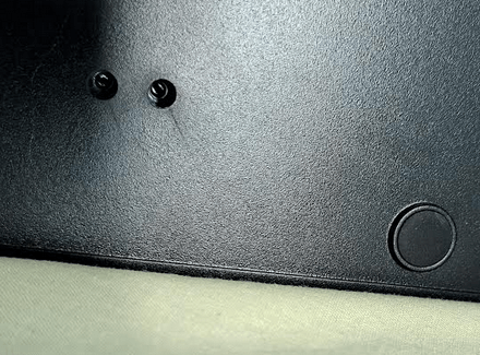

Speed Adjustment
It was time for speed adjustment, actually, I should have done this in the beginning, but I did not have the jeweler's screwdrivers to do this.
Instead of adjusting the speed while the turntable was running, I turned the screw 90 degrees clockwise. This turned out to be too slow, at 32 rpm or so, from the initial 34 odd figure. Next, I turned the screw to 45 degrees, and that worked! 33.33 on the scale. Wow seems to have increased, will have to test.

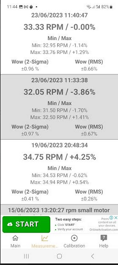

This time, testing the record speed with the app, after speed adjustment done yesterda, wow readings went from 0.20% to 0.62% and o.55%, measured on two separate tests, with the phone moved to a slightly different position each time. I was eager to listen for any change in the sound, and playing one or two tracks, the music sounded slower than before, of course, and possibly a little wow was detected but tolerable. This thing is still usable.

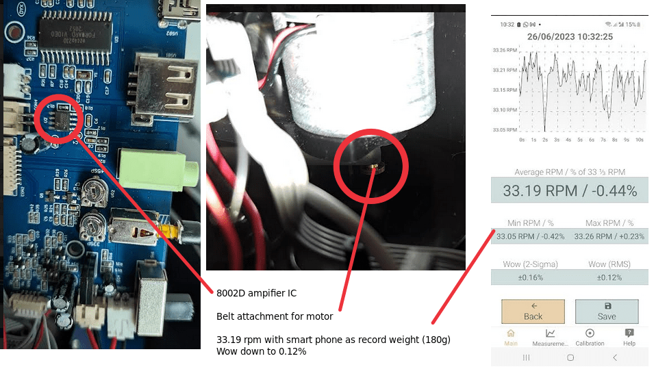

With the wow reading high, I decided to open up the case again and check out the internals of the EZCap 613. I planned to remove the belt from the platter and run the wow and flutter app on the turntable alone, spinning by itself. If the spinning was even, without any peaks, denoting pulses from the motor, I could then attribute the speed variation to the motor controller system. The motor puts out its own whirring noise, which I recorded through the smart phone placed in contact with the case, and some of this gets through to the recording as well, in the quiet sections.
Opening up was easy, and the single board contained a 8002 IC that served for amplification, in mono, that is, to the single speaker. That explained the low volumes, thought the 8002 is a fairly nice sounding chip.

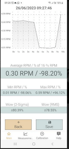

Removing the belt, I spun the platter with the smart phone app running. From what I could see, the speed variation, the peaks and valleys were not seen in this analysis, so I concluded that it was the motor and speed control system. Everything back in place, and it was not too difficult to put back the belt at all, which attached to what I know is a smooth turning turntable platter.
This time I tried the speed test with the record on (weighing 180 g or so) and the smart phone (another 180g). This slowed the record down a little, which I hear is usual, however, it left me with some concern about the bearings. I obtained excellent figures with this setup, but weight will have to be less than this if I expect any sort of longevity. I wished for the large platter model I originally wanted to buy that 'would not ship to your location'. I was not able to find any wow and flutter testing of lower cost turntables, this is a major factor with these things.
I even tried connecting my headphone input to the wires from the cartridge, the wires going to the board, but heard nothing at all through headphones.

As for weights, these are the figures:
12 Inch LP: 115 g
Smart Phone with cover: 246 g
45 Adapter: 2.4 g
Smart phone without cover: 196 g
The weight that was used to reduce wow is therefore a total of 250g over the record weight. This seems to be extreme and may place an undue load on the bearing. The cardboard platter I use for testing speed without the record weighs in at 16g.

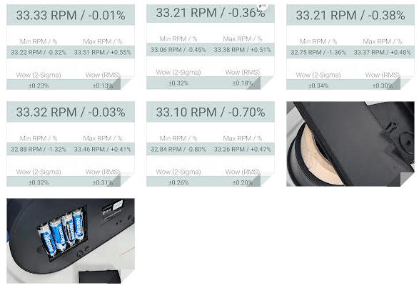

With the EZCap 613, the strobe marks move more like the ones in the video of the gramophone than the rock-steady modern turntable here.
Clearly something must be done. The app I use is strobe engineer. Strobes are supposed to be more accurate than the rpm app, (RPM WOW) that I am using.

Testing with batteries powering the EZCap was performed. As an unintended benefit, the platform for testing rpm was changed to a simple roll of masking tape placed atop the platter, and the phone placed on top of that. The Smart Phone was centred using a ruler. Results were much improved, both for the wow readings with battery power and with USB 5V power. Low results of 0.16% wow was recorded, admittedly with the load of a 180g smart phone instead of a 118g record, but with the listening tests, this seems to be reasonable. Better than the Audio - Technica.
Confirmed results:
On battery power: Wow (RMS): 0.13%, 0.14%, 0.13%
On 5V USB from USB out of phone charger: 0.18%, 0.18% and 0.19%
Confirmed results:

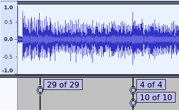

Here are the wave forms: the one on the left is the recording I got done about 5 or more years ago, the one on the right is the unprocessed EZcap 613 recording.
When normalizing, -3dB seems a better option than 0 dB, it seems to generate some distortion, although not showing any peaks in Audacity. Maybe the amplifier cannot cope.

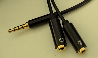

The mini stereo jack of the laptop consists of three separate connections: from the tip of the mini-stereo jack outwards, Left - Right - Common - Microphone.
Connecting a splitter cable did not work for some reason, and even if it did, microphone input is mono.

The question is how to proceed: The pictured devices are not working. As an aside, I have an EZCap Casette Tape converter, and I got it working with the USB output into Audacity. The quality of the 30 year old casette left much to be desired, so I have to decide what I am doing with my tapes. It does, however, raise the possibility of using a converter of some sort from the line out and connecting that to the USB port on the PC, just like with the casette player. The EZCap record player does have an USB out, but that is specified as a power in connection, so I will not be trying to connect that to the USB port. It will I guess just provide power.
The image on the right is of mini stereo jack from headphones: includes the microphone connection and the microphone on the headset works fine through this, to capture sounds through Audacity and write them to a .wav. This is called a TTRS jack, as I found out.
The image on the right is the cable I purchased, surprised it did not work, however only mono input.
There are two options : an USB sound card or a vinyl converter cable. Has anyone used these? I know some other devices suggested, but these are not for right now.

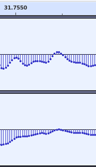

Normalizing -3dB (show below zoomed in ) and speed changes do not work well for audio quality. Better to start with the right speed and use FLAC.
Shown is an mp3 normalization. There is a reason for the quality changes on digital signal processing, even recorded in Audacity at 44100. Oh wait I can record at higher resolution: 384,000.
