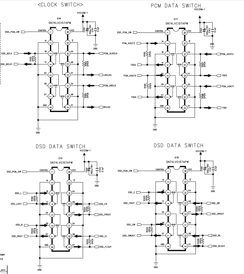

Do you know which chips between Combo384 and WM8741?

Then how to implement this connection between Combo384 DSD signal output to WM8741.
WM8741 is forced H/W mode, so under asynchronous USB, how to
Combo384 is working asynchronous mode, so that, have better method to auto select when PCM or DSD source playing?

Maybe SN74LVC157A is Your friend, try that switch, control signal is from DSDOE pin (in Amanero).
WM8741 uses different input pins for PCM and DSD and works only in DSD64 mode.

Yes, I am test it with 74lvc157. It is not work with DSD mode, because there is missing DSDCLK input.

For example, inside Yamaha DVD-S2700 this switch works very well (4x), as in many others. Look in service manual how they used it.
Even with two or three relays You can make switching between formats, some HF Takamisawa or Omron is suitable.

Try to use this chip http://www.ti.com/lit/ds/symlink/sn74cbtlv3257.pdf
