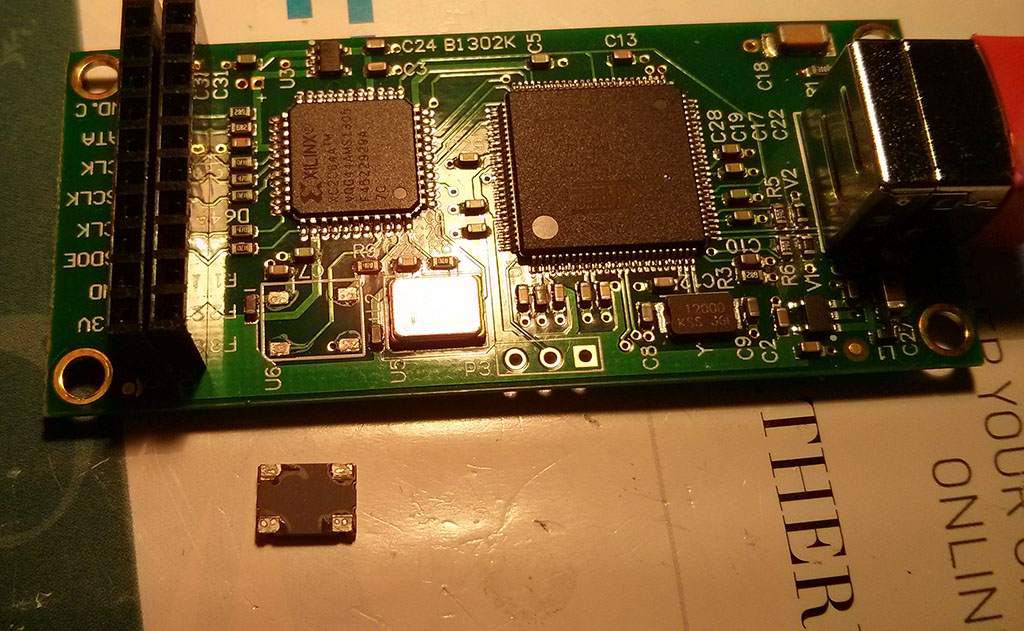

I have tried different music players, WASAPI/KS/DS/ASIO, and still nothing - the player either becomes unresponsive, or "plays" the entire song in 2 seconds.
I will try to contact the guys at Amanero Tech... 🙁
I have experienced a problem like yours: the same behavior with songs played very quickly. It turned out to be a bad soldering on one of the two crystal oscillators. Since you have an oscilloscope, try to check the oscillator outputs on the PCB after the "possibly" bad joint.
Congrats, you've nailed it. While I was probing around with the scope, one of the crystals fell right off the board! 🙁

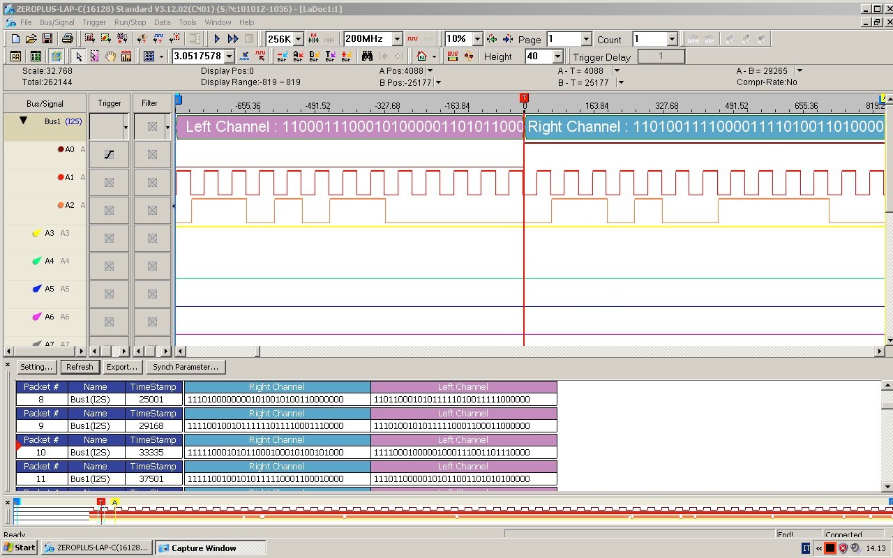

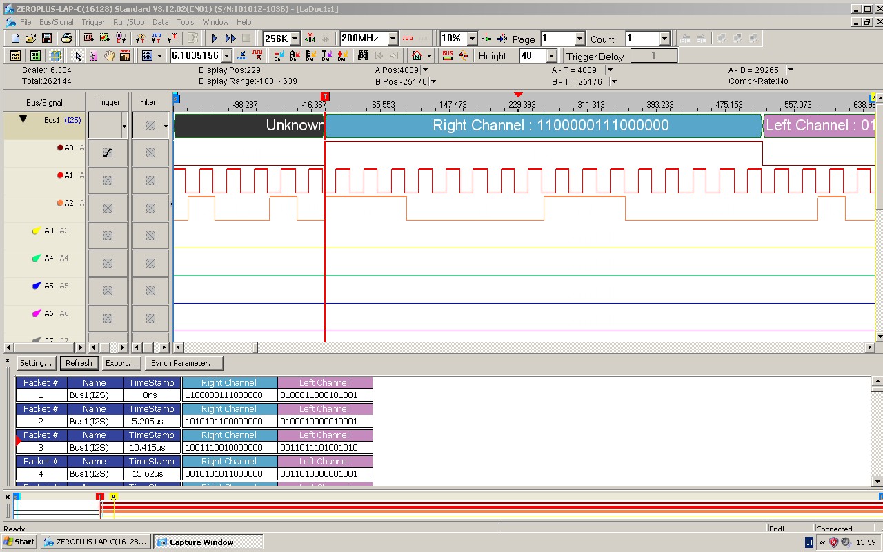

So, here are my findings...
Here you can compare the I2S set on 16 bit and it has 16 rising edges in one frame. In 24 bit setting there are 32 rising edge in one frame. The strange thing is that I cannot figure the 8 trailing zero mentioned before. The data packet seems more than 24 bit... 😕
Software is CPLD and CPU 1080.
