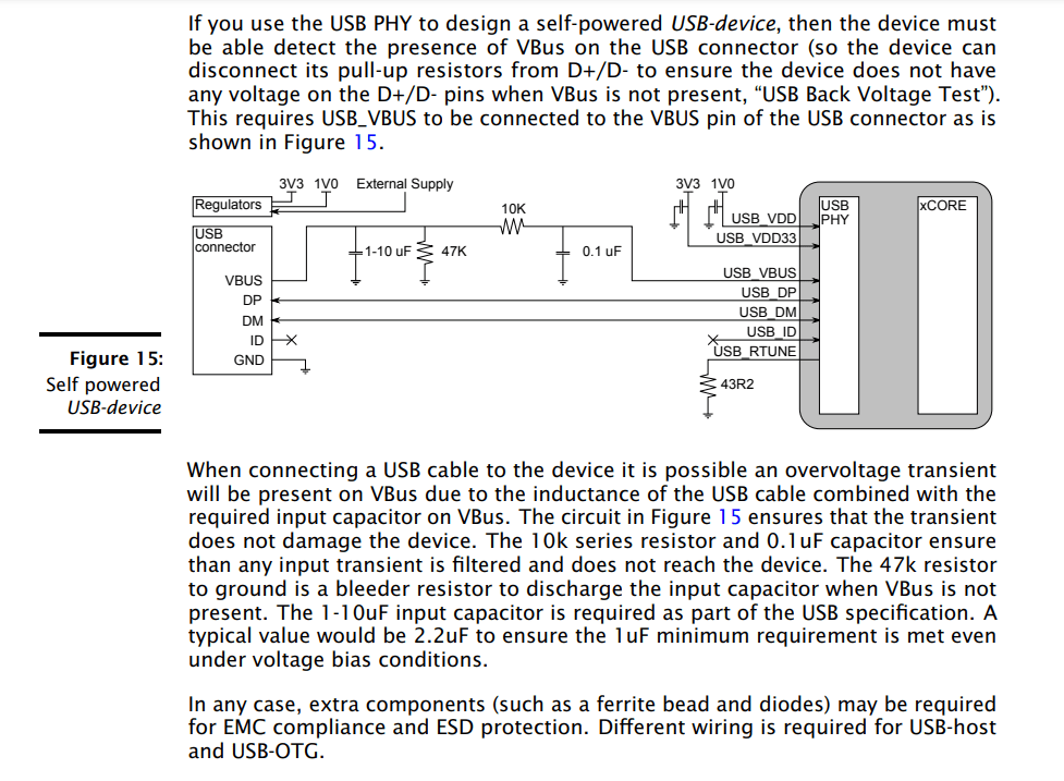

I found this in xu208-256 datasheet, so i already understood🙂
USB enumeration should work with only DP, DM and GND lines. VBUS (5V) can be provided from other source than USB host as it is not used in enumeration. So this problem is probably only related to XMOS boards.
What you are saying makes sense, and looking at XMOS' documentation the connection of VBUS to the XMOS device seems to have to do with protection and not enumeration. But I seem to remember the Amanero boards having a similar problem when powered from an outboard power supply.

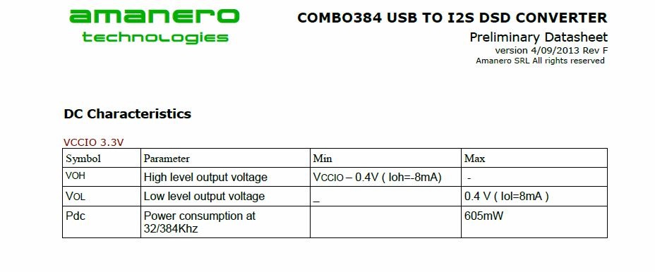

Hi
I would like to connect pc817 optocouplers to F0-F1 and DSDen outputs.
My question is what kind of outputs are these? Are they strong enough to connect the optocouplers directly (of course with a resistor in series). Do the outputs source or sink the current, or both.
Thanks for your reply

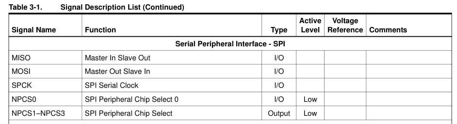

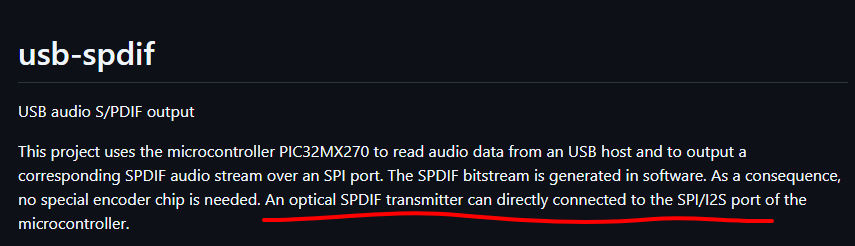

S/PDIF via SPI pin.
I've been looking for a simple way to get S/PDIF from the Amanero / Atmel platform and I am by no means an expert in how, but I stumbled upon something that sounds like a pathway and it comes from a completely different project.
On page 9 of the (Atmel-6430G-ATARM-SAM3U-Series-Datasheet_31-Mar-15) data sheet it says. NPCS1-NPCS3, SPI, Out.
This corresponds to PC3 which is PIN 116.
My question to anyone capable of answering: On the current Amanero platform if we look at the firmware and schematic, is it possible to grab the S/PDIF signal on PIN 116 ?
