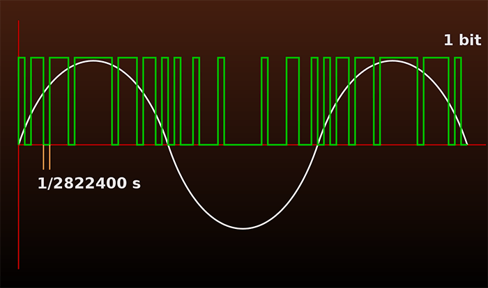

The BCLK or DSD CLK digital waveform looks like a fixed frequency square wave.
The left and right channel data waveforms vary with time according to the music waveform. They appear on the I2S bus lines sometime called DATA and LRCK. For one example, when a fixed frequency sine wave is played it might look something like the green trace below on a scope:
There is also a repeating pattern kind of like the above that is an 'idle' or 'zero' waveform that is used when no music is being played. IIRC an 'idle' or 'zero' pattern never has more than two short pulses in a row before a long pulse occurs. So if you see three or more of the shortest time duration positive-going pulses in a row before a longer duration positive pulse occurs, that would tend to indicate its not an idle pattern, so its probably music. Again, this is from memory so it could be wrong.
Also, if you have a digital scope it may be easier to see what the waveform looks like if you reduce the horizontal sweep frequency so you can see a lot of digital pulses on the screen. Then press the 'stop' acquisition button on the scope to show the last horizontal sweep more clearly. You may need to start acquisition again with a slightly different sweep rate if you see too many or not enough pulses after the acquisition is stopped. May take a few tries to get a good sample of pulses on the screen.
Well then, maybe you should care? If think you are playing music and what your scope shows is a DSD idle signal then you may as well have no signal at all, because you won't have any sound. The idle signal is only to keep the output the DAC at zero volts rather than hitting the negative rail. It means the scope would be indicating you have a problem before the DAC. It can happen 🙂

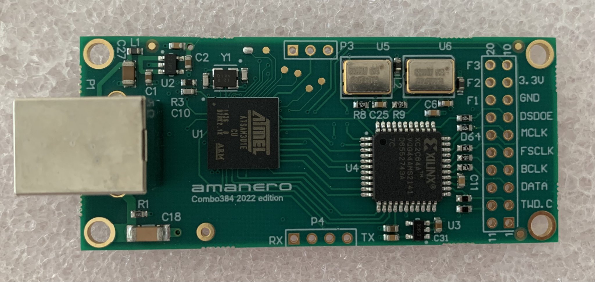

I'm trying to hook up an old Amanero (purchased 11/2013) directly to Twisted Pear Buffalo III. 44k families work good but can not get sound from 48k,96k families. Using JRiver latest WASAPI driver, (ASIO driver did not work at all). Also tried JRiver on Macintosh with same result.
This Amanero was previously used with Hermes/Cronus so had been flashed for Slave mode. I re-flashed default firmware (CLPD 180, CPU firmware DSD512-44-48, and Configuration bits back to master mode). Tried several different firmwares and pretty sure I've got the correct procedure down.
On the Oscilloscope playing 44k gives good signal. Changing to 96k gives flat line on BCLK, FSCLK and DATA. Both give signal on MCLK.
Furthermore going back to 44.1k required a reset by disconnecting and reconnecting module.
I think this means the Amanero is faulty. Is there any way this could be a firmware or driver issue?

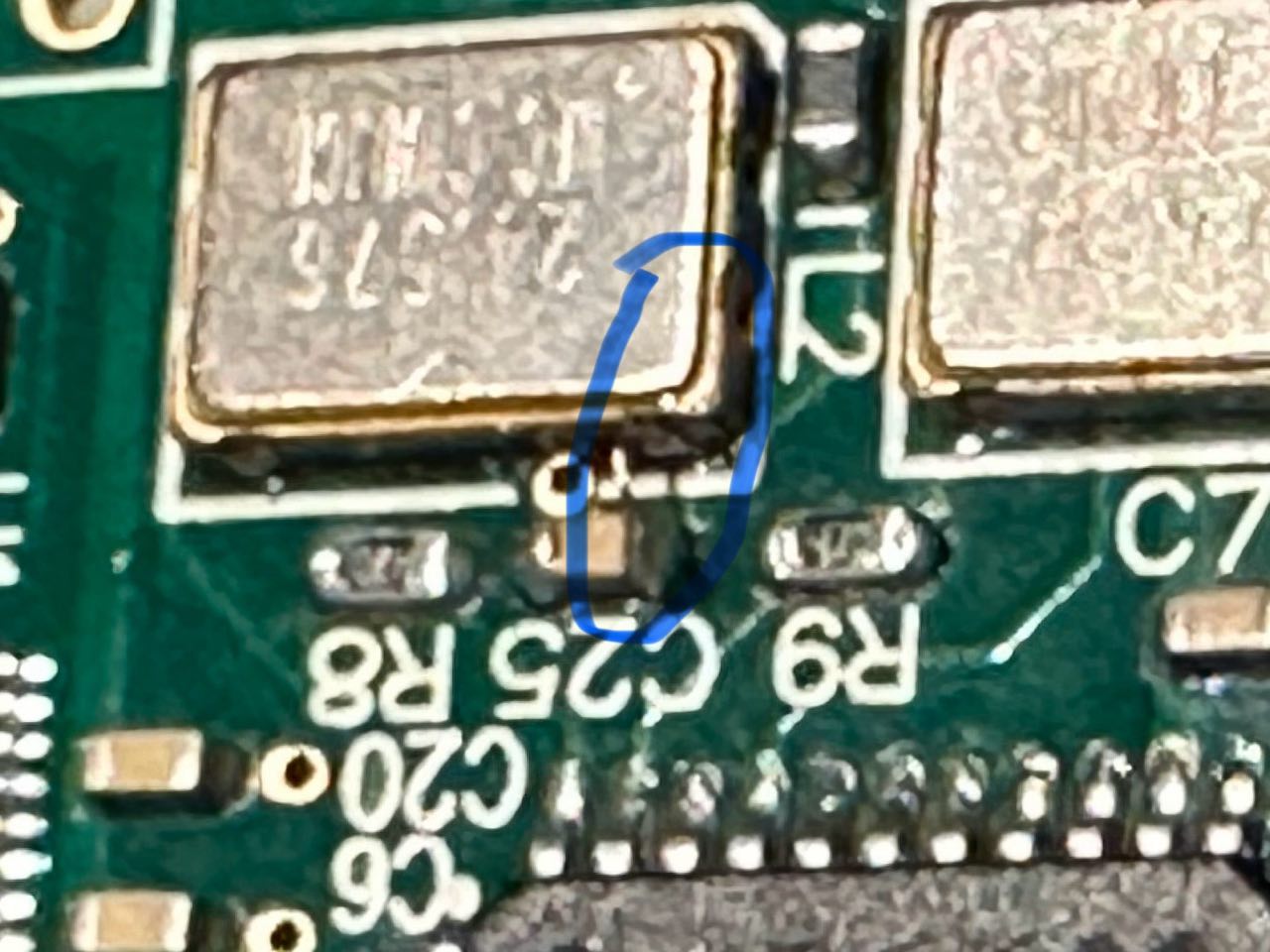

Good afternoon I am sorry for my English.
Couldn't get past your post. For many years, like you, I listened to only one frequency grid 44.1. For many years, since the purchase of Amanero boards, 48 did not work at all.
I specifically found the order confirmation email and specifically found the gift of purchase. Just like you, I bought 2 boards from the author through a group purchase on the forum in November December 2013.
As I said earlier, 48 kHz does not work in both. Both are green on thin textolite.

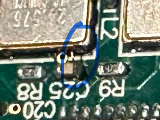

Just last night, I decided to unsolder the crystal oscillator. But before warming up with a soldering station (I even applied a flux), I decided to check the contacts of the quartz oscillators. The oscillators have small contact pads on the side walls. I was able to connect to them with a multimeter with needles.
There was no power plus on the 24 kHz oscillator. I did not lift it from the board, but took a very thin core of the occasion and soldered it to the site and the element next to it - by analogy with a 22 kHz oscillator.
And everything worked as expected!
I finished everything at about 2 o'clock in the morning and listened to music until 4 )) And then I finally saw a message. And I can't call it anything other than mysticism.
The second board is not next to me now. But I think there is the same defect.
I will attach a couple of photos, maybe not very good ones. But I think you understand what I'm talking about.
Please let me know how it all worked out for you.
