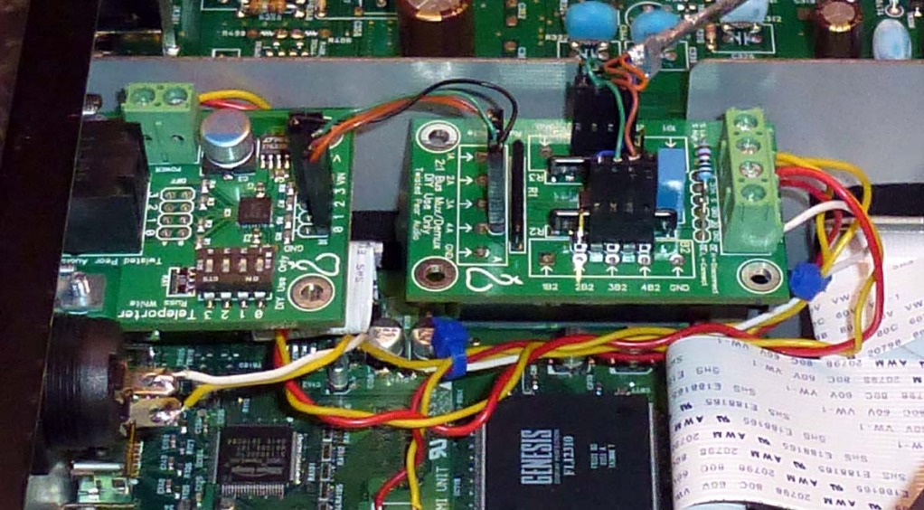

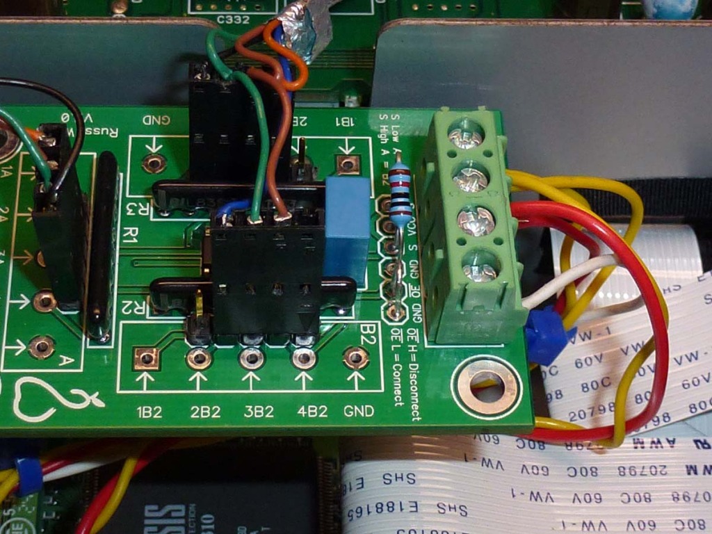

I have a Denon 3910 that I modded to export I2S/DSD to my DAC. Same issue, I2S and DSD share but R and L channel are reversed with DSD. I used a Twisted Pear OTTO II (2:1 switch) to get the DSD channels correct. A mechanical switch on back of the Denon chooses which signal to export. A TP Teleporter transmits to the DAC.
I'll most likely use an OTTO II inside my B III DAC when I get my Amanero.
