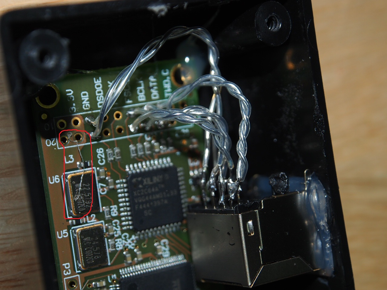

^ What they said plus check the series resistor values on the board. For twisted pair they should be circa 70-90ohm (plus source resistance of the driver) to match the Ethernet's 100ohm impedance.
The better way is to use proper differential signaling techique - whether it's use of bare LVDS or transformer coupled (as used in Ethernet).

It took me 15 mins to rewire them, as it's all solid core, need a tweezers to hold the wire, as the RJ45 socket is PCB type, quite hard to avoid short of wires.
Have you seen your pcb & clock are broken?

How do you turn the data, Bclk and Frame sync SE signal into differential signal?
That looks like left overs from the glue gun only.
Use the RS-485 or LVDS transmitter/receiver ICs...
Is the ADN4665/4666 is right kind?

ADN4667/ADN4668 seem to give much better layout, 1.5ps RMS jitter contribution by ADN4667/ADN4668 combo thru HDMI cable.Is the ADN4665/4666 is right kind?
HDMI cables work nicely for I2S transmission.

According to the spec twisted pairs cable can be used as a transmission medium.

when twisted pear suggest twisted pair can be used, they mean actual twisted pair cable, not home twisted silver wire, but 100ohms ethernet cabling, I favor Belden Cu in PTFE network cable, but yes HDMI is a better cable construction IMO.
I tell you what though, nothing beats not needing to drive a long cable to your dac in the first place.... just use an isolator and reclock locally at the dac if you can. people really shouldnt be treating this like a separate peripheral, its part of the dac, it should be as close to the dac as possible, you should not use one of these HDMI or teleporter things just to enable you to install it somewhere you have enough room for your shunt regs... the thing is tiny, you should have room for it in any dac, putting it in another case just so you can use a low noise power supply is walking *** backwards
