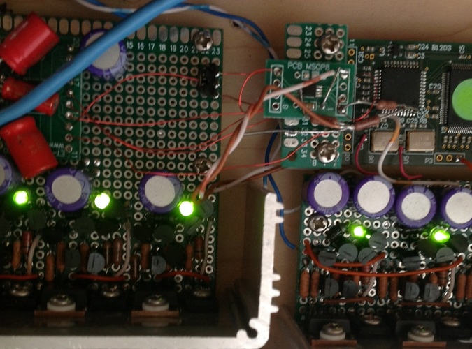

Reclocking the BCK
After improvement of getting MCLK from XO instead of using standard PIN 6, I tried reclocking the BCK with same MCLK and the improvement is very positive. Right now I tied PIN43/44 on CPLD together, fed MCLK to reclocker and DAC with 2K resistor. The reclocker is 74AUC1G74 D-type flip-flop at 2.5V (power pull from 3.3V with 330ohm in series). Left side is PCM5102 DAC.
